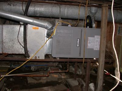

chicago Posted February 18, 2007 Report Posted February 18, 2007 Can anyone help me find out if this hvac unit is rated to be installed on its side? Brand name is kenmore by international comfort products corp.Model NTC6125KJG1. I was not able to find them listed on the web. Even a good link to research this would be appreciated thanks to anyone who can help. P.s it appears to have been built in 2001.

Richard Moore Posted February 19, 2007 Report Posted February 19, 2007 I did find some info at furnacecompare.com that indicates that Airquest (an International Comfort Products brand) NTC6125KJ** furnaces might be either up flow or horizontal flow. I'm not sure what the last 2 digits (the G1) mean but it does seem likely that it's OK.

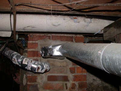

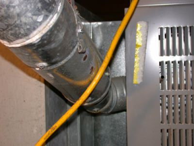

chicago Posted February 21, 2007 Author Report Posted February 21, 2007 Here we go, how many problems can you count.Had to be dragged away from this one. Download Attachment: kb1.jpg 105.2 KB Download Attachment: kb2.jpg 96.55 KB Download Attachment: kb.jpg 89.4 KB
hvacman Posted May 9, 2007 Report Posted May 9, 2007 NTC6125KJG1 was made by ICP and is rated to be either up-flow or Horizontal applications, it is a 125,000 btu/hr input rated for 5 tons of cooling
