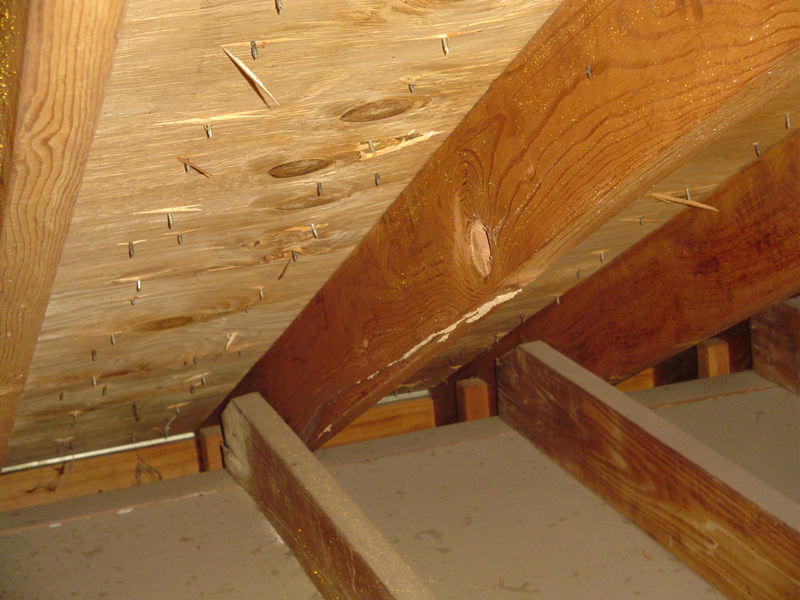

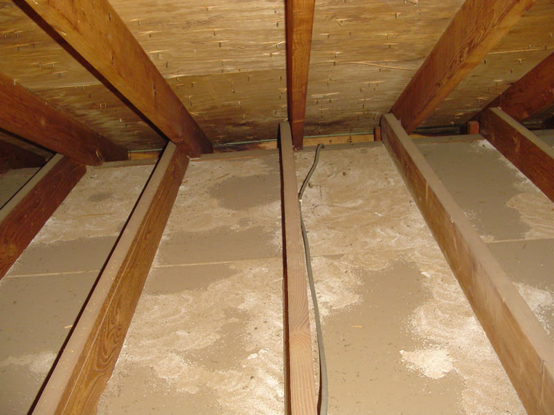

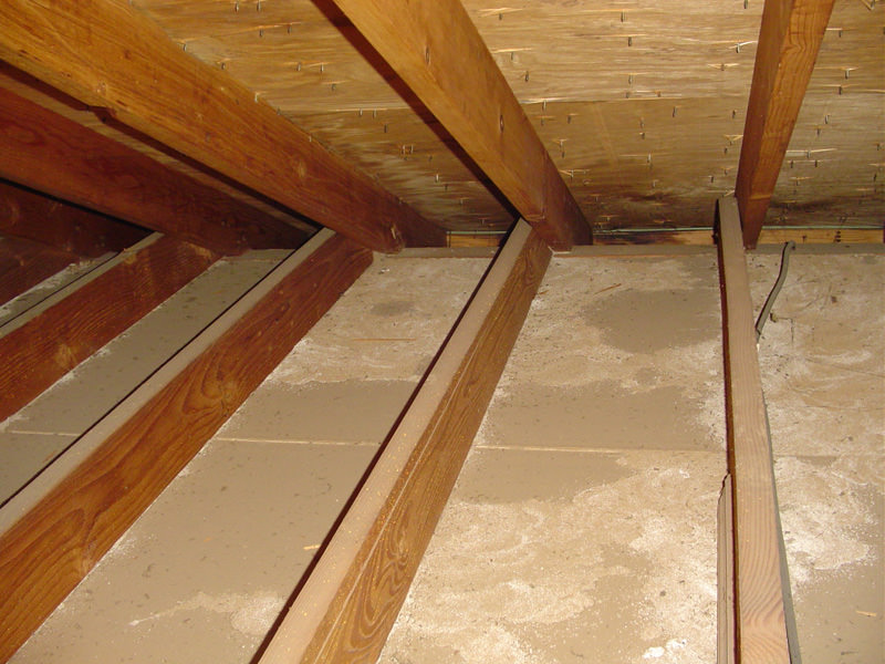

Bain Posted February 8, 2007 Report Share Posted February 8, 2007 Check out the termite activity on the top of the drywalled garage ceiling. These aren't shelter tubes, they're shelter suburbia. A few of the rafters had even been destroyed. Is this an anomaly, or is there a name for it? These big puddles of termite poop? Download Attachment: DSC07089a.jpg 234.03 KB Download Attachment: DSC07090a.jpg 220.68 KB Download Attachment: DSC07091a.jpg 215.26 KB Link to comment Share on other sites More sharing options...
Scottpat Posted February 9, 2007 Report Share Posted February 9, 2007 Looks like someone has brushed the top with a something to break open the mud tubes. Link to comment Share on other sites More sharing options...
Bain Posted February 9, 2007 Author Report Share Posted February 9, 2007 No, Scott. The brown mud tubes were comingled with white gypsum that maybe was tasted and spit out. It's as if a feeding frenzy was taking place. Link to comment Share on other sites More sharing options...

AHI in AR Posted January 29, 2008 Report Share Posted January 29, 2008 Originally posted by BainThese aren't shelter tubes, they're shelter suburbia. A few of the rafters had even been destroyed. Is this an anomaly, or is there a name for it? These big puddles of termite poop? The droppings are called frass. Activity in an attic is entirely normal--if they aren't stopped first. They always build tunnels as high UP into the home as they can get. Once a year, they swarm. Some of them grow wings and jump off the building, flying until their tired little wings fall off. (I'm not making this up.) Wherever they land, they try to start a new colony. Link to comment Share on other sites More sharing options...
hausdok Posted January 29, 2008 Report Share Posted January 29, 2008 Hi, Well, not exactly. They leave the building in search of food sources. Within a few days of swarming, they shed their wings. However, the wings don't fall off in flight; the termites have been landed several days by then. Those that have found a food source will try to start a new colony but most of the swarm will have become prey to other insects, birds, small mammals, and exterminators. ONE TEAM - ONE FIGHT!!! Mike Link to comment Share on other sites More sharing options...

StevenT Posted January 30, 2008 Report Share Posted January 30, 2008 When the time is right, the "swarmers" or "alates" fly off in search of a nest nest. The most common way to discover a termite infestation is to find the wings after the swarm. If they are inside the house, you can be reletivly sure the place is already infested. If the wings are outside, the colony usually isn't too far away. Link to comment Share on other sites More sharing options...
