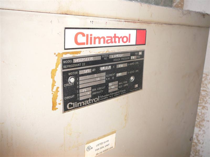

Mark P Posted February 2, 2007 Report Share Posted February 2, 2007 I'm usually pretty good at determining the ages, but need some help on these two: I can't find them in my usual sources. What is confusing me is the house was supposedly built in 1986, and these appear orginal, but there is nothing in the number that looks like 86. Electric furnace:Climatrol Model #:945125115C Serial #: LJ745117 A/C: Model #: CL24-1EB SR# 910709230 Download Attachment: elec furn.jpg 54.33 KB Download Attachment: ac.jpg 77.82 KB Link to comment Share on other sites More sharing options...
Bill Kibbel Posted February 2, 2007 Report Share Posted February 2, 2007 I don't think Climatrol uses any type of date code. I wouldn't hesitate to assume it's original. The A/C is a Goodman, so the date of manufacture is July, 1991. Link to comment Share on other sites More sharing options...

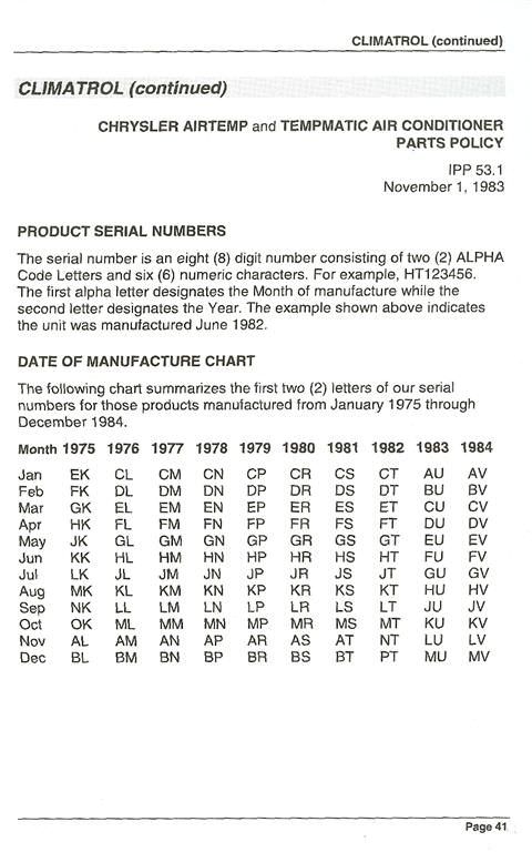

Jim Katen Posted February 2, 2007 Report Share Posted February 2, 2007 Climatrol coded the date in the letters at the beginning of the serial number. According to their serial number guide, LJ would indicate July of '74. The orange color on the Climatrol logo sure looks like an early '70s color. Is it possible that the house is older than they told you? - Jim Katen, Oregon Link to comment Share on other sites More sharing options...

Mark P Posted February 3, 2007 Author Report Share Posted February 3, 2007 Thanks Jim for the help. Where did you find their serial number guide? I've searched the web and the list I maintain with no luck. I've e-mail the company in Australia to ask them to confirm the date. According to the online county records the house was built in 1986. Seems odd that the a/c unit is 5 years older then the house. Link to comment Share on other sites More sharing options...

Jim Katen Posted February 3, 2007 Report Share Posted February 3, 2007 Originally posted by AHIS Thanks Jim for the help. Where did you find their serial number guide? I've searched the web and the list I maintain with no luck. I've e-mail the company in Australia to ask them to confirm the date. According to the online county records the house was built in 1986. Seems odd that the a/c unit is 5 years older then the house. I'm probably wrong then. I use a crib sheet that I've put together over the years. Most of the information comes from the manufacturers that I called when I was just starting in business. Unfortunately, portions of the sheet are illegible and some are barely legible. The portion on Climatrol is sketchy at best and I have no idea where I cribbed it from, so it may simply be inaccurate. I also looked in the Carson Dunlop Technical Reference guide and I'm attaching a scan of the Climatrol chart. It's more specific than my notes, but it (most inconveniently) begins in 1975 and ends in 1984. If you extrapolate, it does seem to corroborate my notes re:1974, however, extrapolating from these charts is dangerous. If you've confirmed the house's age, I'd probably just tell them that the furnace looks as if it's original. One other thing, what do the numbers under the UL sticker say? - Jim Katen, Oregon Download Attachment: Climatrol Dates.jpg 64.51 KB Link to comment Share on other sites More sharing options...
