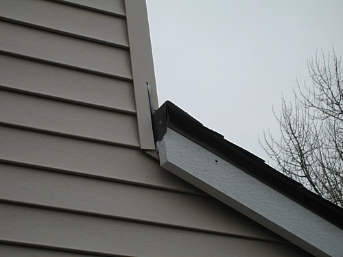

Chris Bernhardt Posted November 26, 2006 Report Share Posted November 26, 2006 New construction, vinyl siding. It just seemed to me that water would just pour thru these poorly detailed joints. I know that a weather resistive barrier is suppose to be present backing the joint and the wall beneath but why tempt fate. How would someone detail these joints so that they are flashed such that water wouldn't so easily enter? The vinyl siding institute installation manual does not cover this type of joint. Download Attachment: jse_IMG_7106.jpg 50.24 KB Download Attachment: jse_IMG_7109.jpg 49.96 KB Chris, Oregon Link to comment Share on other sites More sharing options...
Jim Katen Posted November 26, 2006 Report Share Posted November 26, 2006 Originally posted by Chris Bernhardt New construction, vinyl siding. It just seemed to me that water would just pour thru these poorly detailed joints. I know that a weather resistive barrier is suppose to be present backing the joint and the wall beneath but why tempt fate. How would someone detail these joints so that they are flashed such that water wouldn't so easily enter? The vinyl siding institute installation manual does not cover this type of joint. Chris, Oregon In the first picture, the apron flashing shouldn't extend through the corner trim. It should stop inside it. In the second picture, I'd rather see the apron flashing stop at the edge of the roofing and the corner trim cut into an "L" shape and extend down below the level of the rafter tail in much the same way as the corner trim in the first picture does. - Jim Katen, Oregon Link to comment Share on other sites More sharing options...
Chris Bernhardt Posted November 26, 2006 Author Report Share Posted November 26, 2006 Thanks, Jim I wrote it up for correction but I didn't have any simple ideas to suggest for corrective action for this particular joint between a wall and eave. Chris, Oregon Link to comment Share on other sites More sharing options...
housewhisperer Posted November 28, 2006 Report Share Posted November 28, 2006 Chris, You're spot-on in identifying the vinyl trim installation on the vinyl exterior wall cladding as an ADVERSE CONDITION. You're also to be commended for posting your questions and your excellent photographs. Jim appropriately addressed your questions. I'm going to make an observation on the comment you posted in response to Jim's reply: "I wrote it up for correction but I didn't have any simple ideas to suggest for corrective action for this particular joint between a wall and eave." If you meant that you had no verbal comments regarding ideas for the specific corrective action(s), good for you for asking your fellow inspectors. It's always useful to be able to verbally explain the actual or probable corrective action(s) to address an ADVERSE CONDITION. It helps your client better understand the degree of complexity and possible potential cost (in broad terms of whether it is relatively simple and inexpensive or complex and expensive, assuming that no other previously undetectable ADVERSE CONDITIONS are discovered in the course of performing the corrective actions). However, if you meant that you had no written comments for inclusion in the inspection report regarding the specific corrective action(s), that's an altogether different issue. Upon determining that an ADVERSE CONDITION is present, the job of a professional home inspector is to identify the specific component(s) affected, to describe the ADVERSE CONDITION clearly and succinctly (without editorializing or hyperbole), and, finally, to recommend an action to address the ADVERSE CONDITION (not to describe the specific method or materials of repair). The recommended action may take the form of a statement to the effect that "It is recommended that such ADVERSE CONDITION be evaluated and addressed by an appropriate and QUALIFIED individual or company as soon as possible for any necessary modifications or corrective measures. If, in the course of evaluating and addressing the ADVERSE CONDITION, it is determined that there are other ADVERSE CONDITIONS which require modifications or corrective measures, it is recommended that such modifications or corrective measures also be performed at that time." The terms "ADVERSE CONDITION" and "QUALIFIED" are in bold caps because they are part of a comprehensive inspection report glossary in which they are defined as follows: ADVERSE CONDITION: With regard to a specified system or component, a condition which is producing a detrimental effect on that system or component, which is impairing the NORMALLY INTENDED FUNCTION OR OPERATION of the specified system or component at the time of the inspection, or which in not consistent with good and established practice with regard to installation, assembly, operability, maintenance, or suitability of use. QUALIFIED: When referring to any individual or company performing additional evaluation or work on any systems or components at the subject property, QUALIFIED shall mean having the training, skills, expertise, and experience necessary to competently perform the referenced work and, where required, holding all applicable licenses, and meeting all applicable governmental requirements. NOTE: All repairs, corrective measures, or new work undertaken on any component or system should be performed only by QUALIFIED individuals or companies. Only new or appropriate materials should be used. All work should be performed in a workmanlike manner and in accordance with all appropriate and applicable industry standards and governmental requirements pertaining to permits, codes, ordinances, and regulations. Subsequent to completion, all such work should be documented by work orders, invoices, or receipts from the individuals or companies that have performed the work. (Company nameid="blue">) will not re-inspect any property which it has previously inspected to verify that the conditions documented during the inspection have been properly corrected. All systems and components require ongoing and prudent periodic maintenance to obtain their maximum service lives. When work requiring a permit is performed without obtaining the proper permit and inspections, that work may be considered nonconforming and illegal. Nonconforming work may jeopardize the safety of persons occupying or entering the property. It may also adversely affect specific insurance coverage and the salability of the property and may result in added costs in the form of additional fees and/or property tax penalties. Subsequent to completion and where appropriate and applicable, it is recommended that all such work be documented by work orders, invoices, or receipts from the individuals or companies which performed the work as well as by copies of all signed off building permits and lien releases from contractors and their employees, other workers, and material suppliers. In the definition of ADVERSE CONDITION the term NORMALLY INTENDED FUNCTION OR OPERATION is also in bold caps and is defined as: NORMALLY INTENDED FUNCTION OR OPERATION: With regard to a specified system or component, the historically and conventionally accepted purpose or use of that system or component and/or the intended purpose or use for which that system or component is designed by the manufacturer. If you'd like more information regarding the benefits of incorporating and using an inspection report glossary with your reports, email me at: prospex@prospex.us. Kevin Link to comment Share on other sites More sharing options...
