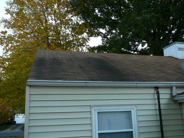

Mark P Posted October 25, 2006 Report Share Posted October 25, 2006 A section of the plywood sheathing is blackened only in one area approximately 32" wide. The rest of the sheathing is normal except where it is water damaged along the bottom edge from lack of a drip edge. There are 2 12x9 gable vents for this 800 sqft attic. The roof is 15-20 years old? My question is why is this section black? My 1st thought was a ventilation problem except the blackness is only in this one area. So, my next guess was it is related to the black staining on the outside of the shingles, which I always thought was the tar leaching from the aging shingles. Anyway, Iââ¬â¢ve already told the buyer the roof will likely need replacement in the next 5 years and some of the sheathing replaced with it, but I wanted to give him an explanation (and I want to understand too) of why this section is black. You thoughts and opinions are always appreciated. The last pic is just gee-wiz since Iââ¬â¢m already posting this, it the dryer vent and years and years of lint build up in the attic, but not near the blackened area. Download Attachment: Inside.jpg 84.06 KB Download Attachment: outside.jpg 82.09 KB Download Attachment: Lint.jpg 63.52 KB Link to comment Share on other sites More sharing options...
Jerry Simon Posted October 25, 2006 Report Share Posted October 25, 2006 Mark, Is the area in the attic above a bath? I'm guessing it is, and this is simply mildew on the underside of the roof deck, promoted by bath moisture naturally migrating up into the attic. The black stuff on the shingles is algae, not tar. The algae feed off organics found in the shingles. When the new shingles are installed, nailing copper strips along the roof ridge will keep algae from growing on the new shingles; the ions in the copper will run down the roof and kill any algae growth. For a good example of this, one that can be seen daily driving up and down the block, look for a roof with a lot of algae. Pay close attention to the shingles right under the metal flue chimney housing...not a speck of blackness (algae) under the chimney. Link to comment Share on other sites More sharing options...

Mark P Posted October 25, 2006 Author Report Share Posted October 25, 2006 Thanks all! I think Jerry nailed it, this is above the bathroom and that explains why it is concentrated in just this area. The black mess on the insulation below the affected area is the insulation on the a/c refrigerant line, which was manufactured in 1982 and can you believe the furnace was 1978! Link to comment Share on other sites More sharing options...
