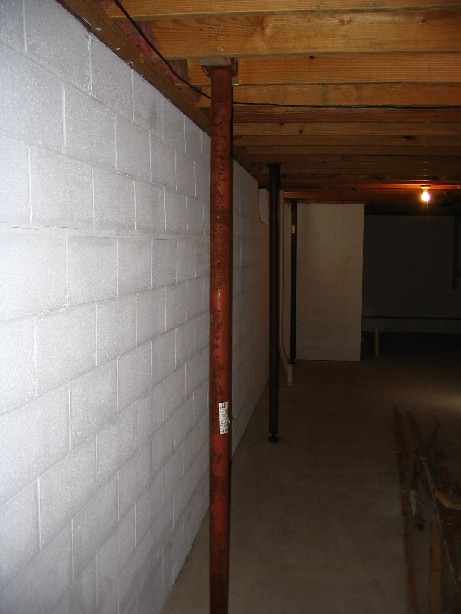

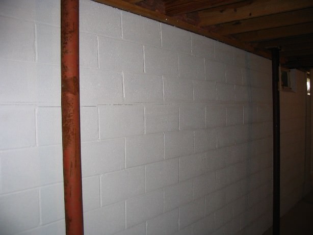

I observed a horizontal crack the length of a concrete block foundation wall on the joint at grade level. The wall was bowed slightly inward above and below the crack. I would estimate that the wall below the crack is out of plumb approximately 1/4" per foot. (about 1.5" in 6' of block) The crack is currently a hairline crack, but it is apparent that a larger crack has previously been repaired. Someone (the homeowner most likely) has added some steel post in an attempt to bear some of the load of the structure above this foundation wall.
Question: Should I recommend further evaluation by a PE or a foundation contractor? What are the standards on these issues?

Yes. That's a serious structural problem. I'd tell them to hire a P.E. to design a fix and oversee the repairs. Alternately, they could hire the P.E. to design the repair and hire you to perform QC.

Definitely get an engineer involved.
That's probably inadequate drainage and preparation around the outside of that foundation. The ground is freezing and expanding and has cracked that foundation.

Definitely needs an engineer to design a proper fix. Those columns are doing little more than providing a false sense of security and a convenient place to string a clothesline.
The block wall is being pushed inward, probably from soil and/or water pressure from the outside. Those columns, or anything else that I can see in those photos, are doing nothing to push it back. If the columns are not anchored well enough at the top and bottom, or if they cannot resist the bending forces that would be put on them by the wall (and circular columns don't resist bending well), the wall will take the columns out.
If the columns do hold and the wall reaches the point of collapse, then the columns will probably make a nice decorative feature on the first floor after they tear through the subfloor and the first floor comes down to join the basement. It looks like they are fastened at the top to blocking that is nailed between the floor joists.
