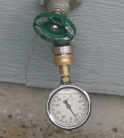

Scottpat Posted July 16, 2006 Report Posted July 16, 2006 Water pressure to the home should range between 40-80 psi. If it is higher a pressure reducing valve is needed. We should all be reporting when we find water pressure over 80 psi. It is so simple to test the pressure and could save you and your client a great deal of grief and money in the long run. I speak from experience, I did not test water pressure until five years ago and that was after I bought a reducing valve for a client who had a leaking TPR and a blown seal at the refrigerator ice maker.
hausdok Posted July 16, 2006 Author Report Posted July 16, 2006 Hi Scott, I don't know that I can agree with that. I certainly wouldn't have ponied up for a pressure-related issue because I don't test for it and I'm not required to test for it by any standard that I use. I don't mind exceeding the standard for some things but this is one that I think is fraught with liability. Pressure can vary from town to town and neighborhood to neighborhood. Pressure in a neighborhood can be less than 80psi this month and four months later, after they've made repairs to the system, can be over 100 psi. There's no way that I can predict how/when that will happen so why try? Most of the homes that I have inspected over the past 10 years don't have pressure-regulators or restrictors on them and haven't suffered any ill effects. I'm not saying that a regulator isn't a good thing, I'm just saying that I think that they're optional, unless required by current codes, and testing pressures delves into technical analysis that is beyond the scope of even your own association's standards. Remember, we're supposed to inspect installed systems and components. If there is no regulator on the system and it isn't required, than it most certainly isn't part of the installed system whether desirable or not. Excerpted from the ASHI S.O.P. 13.1 General limitations: Inspections performed in accordance with these Standards of Practice: are not technically exhaustive. ---------------------------------- 13.2 General exclusions: A. The inspector is not required to perform any action or make any determination unless specifically stated in these Standards of Practice, B. Inspectors are NOT required to determine: 3. the strength, adequacy, effectiveness, or efficiency of any system or component. 6. future conditions including, but not limited to, failure of systems and components. C. Inspectors are NOT required to offer: 2. or perform engineering services. --------------------------------------------------------------------------- 6. Plumbing System 6.1 The inspector shall: A. inspect: 1. the interior water supply and distribution systems including all fixtures and faucets. 2. the drain, waste and vent systems including all fixtures. 3. the water heating equipment. 4. the vent systems, flues, and chimneys. 5. the fuel storage and fuel distribution systems. 6. the drainage sumps, sump pumps, and related piping. B. describe : 1. the water supply, drain, waste, and vent piping materials. 2. the water heating equipment including the energy source. 3. the location of main water and main fuel shut-off valves. 6.2 The inspector is NOT required to: A. inspect: 1. the clothes washing machine connections. 2. the interiors of flues or chimneys which are not readily accessible. 3. wells, well pumps, or water storage related equipment. 4. water conditioning systems. 5. solar water heating systems. 6. fire and lawn sprinkler systems. 7. private waste disposal systems. B. determine: 1. whether water supply and waste disposal systems are public or private. 2. the quantity or quality of the water supply. C. operate safety valves or shut-off valves. -------------------------------------------------------------------- Don't see anything there that requires pressure testing. Do you? ONE TEAM - ONE FIGHT!!! Mike
homnspector Posted July 16, 2006 Report Posted July 16, 2006 I check it because it does vary alot in this area. Some have regulators, some don't. New construction requires a regulator here if over 80 psi. I like to document what it was at the time of the inspection, and it takes about 10 seconds. I often see homes with a pressure regulator and psi of 120 because the regulator has failed. So this is a case of failure of an installed system. I agree that the pressure will vary day to day but I want my observation on that day in writing. An air conditioner that works today may fail tomorrow, I still check it and report on functionality. Just what I do, not really my business if anybody else does or doesn't check psi.

Richard Moore Posted July 17, 2006 Report Posted July 17, 2006 I'm with those that test for static pressure and recommend a reducer (or repair if one already exists) when over 80 psi. Agreed that pressure can vary somewhat day to day, but when I see 120 psi I gotta report it. It's almost the first thing I do when I get to a house. I always run a little water first to make sure I'm not getiing a high reading from thermal expansion and usually try to read it at the rear hose-bib as some newer homes have the front bib feed before any reduction valve. As for CMA, it is one of those "snapshots in time", and so I take and save a picture of it! Download Attachment: 0007.JPG 43.24 KB
Les Posted July 17, 2006 Report Posted July 17, 2006 How do you read the gauge upside down like that?

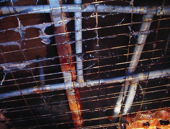

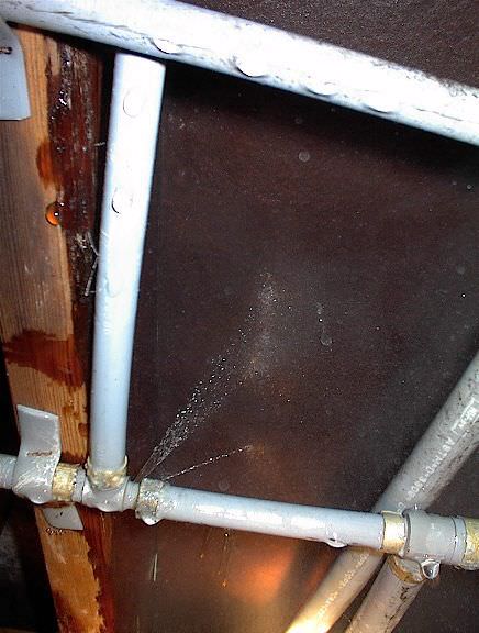

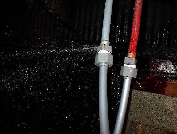

Jim Katen Posted July 18, 2006 Report Posted July 18, 2006 Originally posted by hausdok . . . What's the water like down Vancouver/Portland way? Lots of chlorine or alkalinity? Do you know anyone that's seen this stuff actually fail out here? Msr. Katen, what say you? ONE TEAM - ONE FIGHT!!! Mike Not lots of chlorine or ph problems. I see the stuff almost exclusively in manufactured homes. It's a problem. I've had several clients who've had to re-plumb the entire house. I used to report on it kind of softly. No more. I say something like: Polybutylene plumbing is a defective product that was the subject of one of the largest class action lawsuits in U.S. history. I didn't see any leaks today but, if you buy this house, understand there's a risk that the plumbing supply pipes might fail suddenly and catastrophically with no warning. Consider re-plumbing the house before that happens. - Jim Katen, Oregon Download Attachment: PB_Leak_02.jpg 101.94 KB Download Attachment: PB_Leak_44.jpg 62.46 KB
hausdok Posted July 18, 2006 Author Report Posted July 18, 2006 Quick! Steal that boilerplate! [:-eyebrow OT - OF!!! M.
johnmcda Posted July 18, 2006 Report Posted July 18, 2006 Interesting photos, Jim. PB Leak02.jpg would not be covered under the class action suit due to the type of valve used - only the clamp type fittings, metal or plastic are covered. The second photo with the metal clamp fittings would be covered only if is in a concealed place - since it is visible, it most likely would not be covered either.
Jim Katen Posted July 18, 2006 Report Posted July 18, 2006 Originally posted by johnmcda Interesting photos, Jim. PB Leak02.jpg would not be covered under the class action suit due to the type of valve used - only the clamp type fittings, metal or plastic are covered. Actually, PB_Leak_02 is a clamp-type fitting. It's hard to see in the picture because I exposed for the water spray rather than the pipe. Here's a picture of the same pipe & leak taken with 2 stops less exposure. Download Attachment: PB_Leak_02_-2.jpg 60.23 KB The second photo with the metal clamp fittings would be covered only if is in a concealed place - since it is visible, it most likely would not be covered either. It was in a concealed place, above the manufactured home's bottom board. Here's a picture of the way it looked when I first encountered it. It had been leaking for so long that the bottom board was entirely decayed with nothing but it's reinforcing strings left. You can't see the water spray in this picture because of the angle of the flashlight. I had to clear the strings away to get a good shot. Download Attachment: PB_Leak_44_a.jpg 95.18 KB
