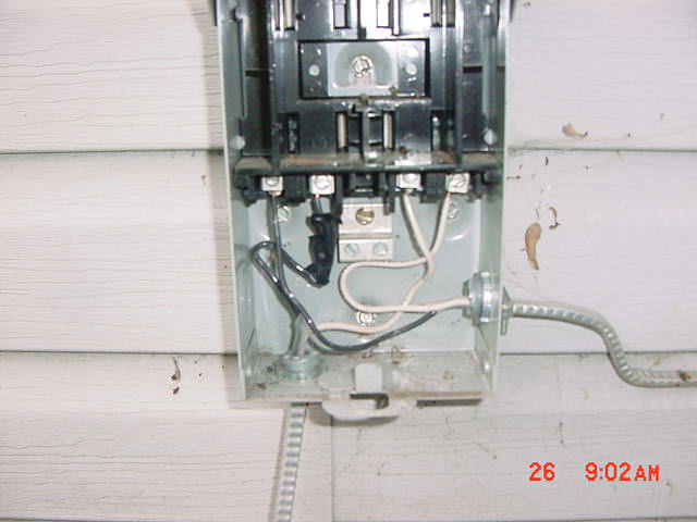

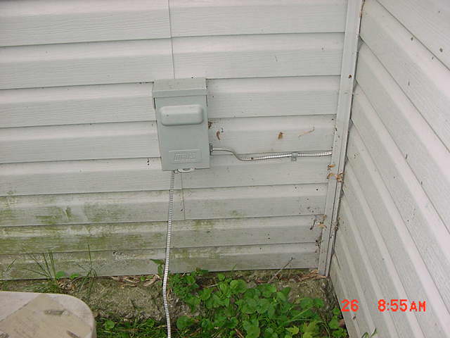

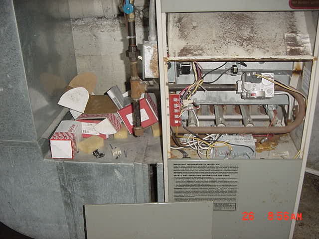

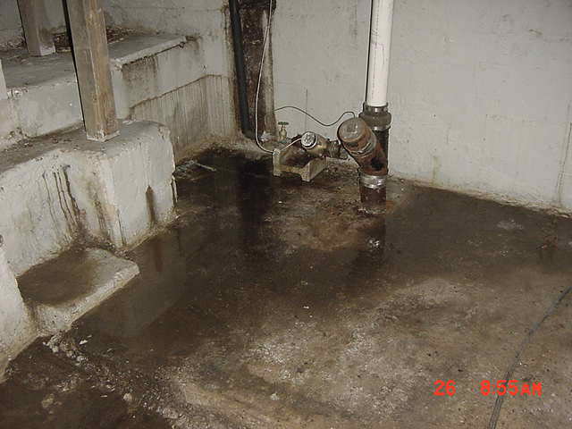

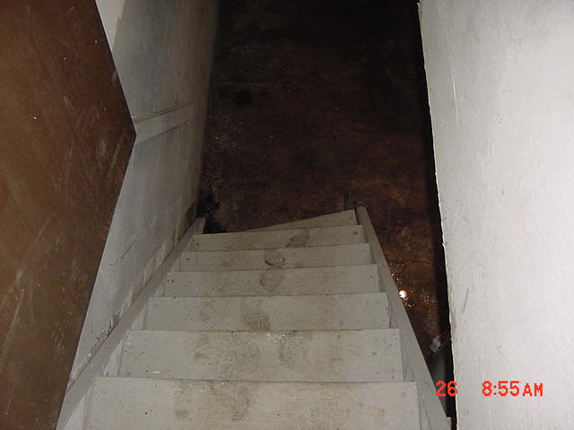

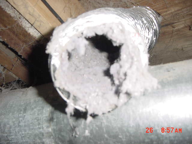

Les Posted June 26, 2006 Report Share Posted June 26, 2006 All you guys know the drill "First time buyer with no money, going with zero down and seller pays closing costs". Just needs me to look at the plumbing, 'cause the appraiser thought something might be amiss. Following is the photo journal: Download Attachment: MVC-004S.JPG 39.52 KB Download Attachment: MVC-005S.JPG 38.62 KB Download Attachment: MVC-006S.JPG 39.52 KB Download Attachment: MVC-011S.JPG 37.72 KB Download Attachment: MVC-002S.JPG 39.63 KB Download Attachment: MVC-016S.JPG 38.16 KB Another rescued buyer. This house was advertised as move-in condition, perfect for first timers! I don't know why I post these horror stories, except to preach to the choir. Link to comment Share on other sites More sharing options...

DonTx Posted June 27, 2006 Report Share Posted June 27, 2006 Les, you're obviously an alarmist!! Shame on you! The Sellers have every right to push this POS home off on unsuspecting consumers, and what about the Agents commission??!!! [:-bigmout Seriously, what was the write up on the furnace? I see some rust, it appears to be a pre-1992 natural draft unit and possibly some leakage/rust at the seam to the upper right of the burners??? Link to comment Share on other sites More sharing options...
Brian G Posted June 27, 2006 Report Share Posted June 27, 2006 Dammit Les, when are you gonna learn to be fair to the poor house (and the agents)? Let me help you. The stairs are structurally challenged. The basement floor is self-moisturizing. The furnace is richly experienced. The dryer duct is internally insulated. The disconnect is economically wired. Now was that so hard?! C'mon man! [:-dev3] Brian G. Talkin' That Stuff [^] Link to comment Share on other sites More sharing options...

Les Posted June 27, 2006 Author Report Share Posted June 27, 2006 And now the rest of the story! Buyer is long gone! Agent authorized flea treatment after everyone that went in there was covered with fleas. I came back to office, wrote the initial post, started scratching, took a shower and dried off with paper towels because I have no bath towels here. Furnace had 1/2" rust at bottom of exchanger, rotted draft hood and misc new parts as evidenced by the boxes sitting next to it. Still did not fire up. That water on floor is raw sewage. The a/c disconnect is 14-2 w/o ground and runs approx 65' to panel behind new vinyl siding. Black tape was just an extra touch. To the agent's credit, he changed the line-side from "move in condition" to "needs a little TLC". Finished inspection with a record of site visit - "This house does not meet minimum HUD standards at this time". Got $50.00 and will get a full fee in a week or so when they find another house. Link to comment Share on other sites More sharing options...
