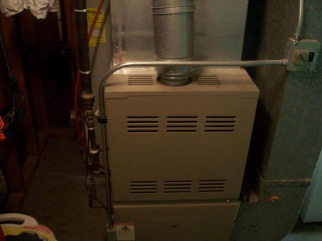

Originally posted by fyrmnk
Here's the info off what's installed. Any feedback on this installation?
Furnace by International Comfort Products
Evaporator Coil
model no. EPA42F19B1
mfg. no. NEPD42F19B1
serial no. L984436333
Forced Air Furnace
model no. GNE100F14A1
mfg. no. GNE100F14A1
serial no. L984122059
Air Conditioner by Goodman Manufacturing
model no. CKT481AB
serial no. 9904473052
Thanks again
Evap 3.5 ton, A/C unit, 4 ton = not good.
