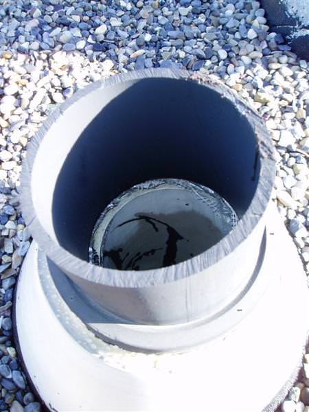

Darren Posted March 29, 2006 Report Share Posted March 29, 2006 Here's a question for all you guys (and gals) who walk roofs. When walking a roof do you look down the plumbing vents? If so, when you see water lying at the bottom of the stack, what do you report? I had one yesterday that every vent that went straight down I could see a reflection (water); what's a inspector boy to write? Darren www.aboutthehouseinspections.com Link to comment Share on other sites More sharing options...

RobC Posted March 29, 2006 Report Share Posted March 29, 2006 Yes, if they looked like this. Download Attachment: PlumbSewerStack1_M.jpg 46.72 KB This is a newly installed roof. If you look carefully, you'll see what appears to be a grey mesh fiber on the left at the neoprene flashing. Straight from the Handy Man Corner Download Attachment: PlumbSewerStack2_M.jpg 56.95 KB Makes you wonder if the original roof was stripped and the decking inspected. But that wasn't your question, you asked.. "If so, when you see water lying at the bottom of the stack, what do you report?" I'd have to ask you in return if you observed the sewer stack(s)connected to the plumbing vent system and most importantly did you notice any appliances behaving abnormally? Link to comment Share on other sites More sharing options...
Bain Posted March 30, 2006 Report Share Posted March 30, 2006 A 1/4" per 1' slope actually isn't very much. Though it's disgusting, if there were solid matter--including tissue--in the lowermost 3" or 4" main sewage line, it could linger around and prevent drainage until more water swishes it away, hence the visible water at the bottoms of the sewer vents. As we all know, and on newer houses especially that are quite large, the drains are often sloped less than 1/4" per 1', but they typically work just fine. Link to comment Share on other sites More sharing options...
Brian G Posted March 30, 2006 Report Share Posted March 30, 2006 I don't usually look down the vents, but I do look at the vent pipes when I'm in the attic. Normally a lot more of the pipe is visible in there anyway. If they don't look like they drain I write 'em up and recommend making them drain. Brian G. Why Do They Call It Standing Water, When It's Really Just Lying There? [:-boggled [] Link to comment Share on other sites More sharing options...

Bill Kibbel Posted March 30, 2006 Report Share Posted March 30, 2006 "When walking a roof do you look down the plumbing vents?" -Yep. "If so, when you see water lying at the bottom of the stack, what do you report?" -Never seen liquid, just debris, nests, test balloons and a ball once. "what's a inspector boy to write?" -As an inspector man, I would write something like: Water shouldn't be in there, it probably isn't venting effectively and you need to get a plumber to fix it. "I guess I'm too busy looking through skylights, especially the ones in the bathrooms." - I would think a large majority of the time I would see stuff I didn't want to see. Link to comment Share on other sites More sharing options...
