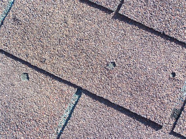

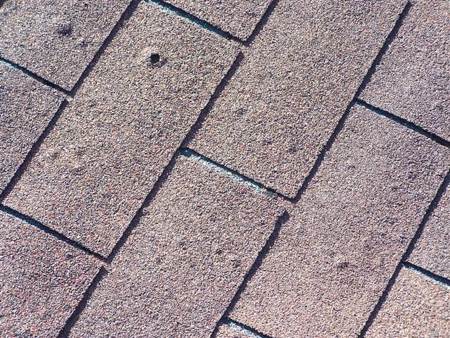

Mark P Posted March 25, 2006 Report Share Posted March 25, 2006 The 2 attached photos show small bumps and holes in an asphalt shingle roof. The house faces west and the damahe is only on the West side. There are two layers of shingles. The roof is 10+ years old. Anyone know what is causing this and what should be done about it? I have some ideas, but wanted to get another opinion. Thank You Mark Download Attachment: Picture 038.jpg 151.69 KB Download Attachment: Picture 039.jpg 160.55 KB Link to comment Share on other sites More sharing options...
Jim Katen Posted March 25, 2006 Report Share Posted March 25, 2006 Originally posted by AHIS The 2 attached photos show small bumps and holes in an asphalt shingle roof. The house faces west and the damahe is only on the West side. There are two layers of shingles. The roof is 10+ years old. Anyone know what is causing this and what should be done about it? I have some ideas, but wanted to get another opinion. Thank You Mark They're called "rash blisters." They're extremely common in my area. I see rash blisters a few times each week. They can be tough to spot unless the sun is low. I'm certain that they occur across most brands. They happen to cheap three-tabs and low-end laminated shingles alike. I've never seen them in high-end laminated shingles such as Presidentials. They always appear early in the shingles' life, certainly within the first year or two. In any event, my opinion is that they have no effect on the life of the roof. Occasionally, if there's a lot of foot traffic, they'll shear off and you'll get pea-sized pocks on the shingles, though this is rare. Even when this happens, the problem seems to end there. It doesn't progress to a condition that would shorten the life of the shingle. This might not be the case in other climates, but up here, they're a minor glitch in the roof. Here's a technical bulletin about them. - Jim Katen Download Attachment: RashBlisters.pdf 34.12 KB Link to comment Share on other sites More sharing options...
hausdok Posted March 25, 2006 Report Share Posted March 25, 2006 Hi Jim, I remember that when I was going through training 10 years ago they told me that these were typically caused by a defective asphalt formulation in the shingle matting and were considered a manufacturing defect. I also remember that back then roofers around here were replacing them for that purpose. Later on, as I learned what you have, it no longer seemed to be that big a deal and I've heard many times since that some manufacturers no longer replace them under warranty for this defect. This is the first time I've seen that document though I don't disagree with its conclusions. ONE TEAM - ONE FIGHT!!! Mike Link to comment Share on other sites More sharing options...
