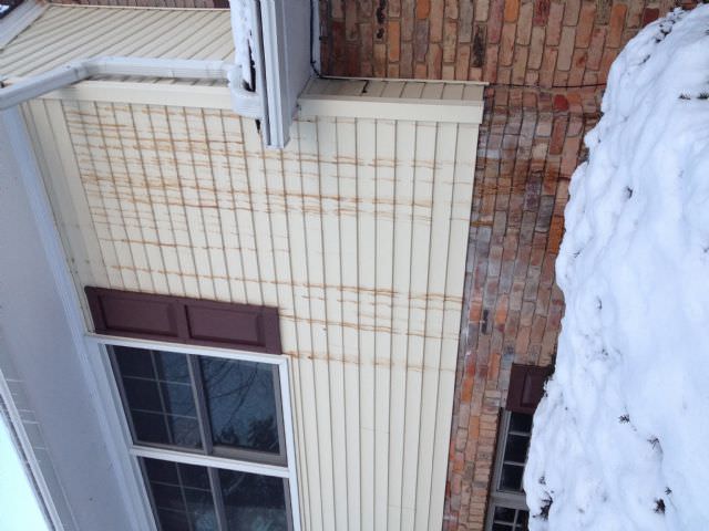

Newhood89 Posted January 8, 2015 Report Posted January 8, 2015 It rained for a couple days at our house and now since it snowed the last two days, there is a rust colored substance running down one side of the front of our house. I am not sure what it is or what to do to get rid of it or keep it from happening again. Click to Enlarge 53.74 KB
Marc Posted January 8, 2015 Report Posted January 8, 2015 Ever known the house to have an issue with ice dams? Marc
kurt Posted January 8, 2015 Report Posted January 8, 2015 Looks like a textbook example of ice dam backup. Is there an ice patch along the eave? Are the gutters full of ice? Is there ice and water shield under the eave shingles....if so, does it wrap behind the gutter? (Probably not.) 1

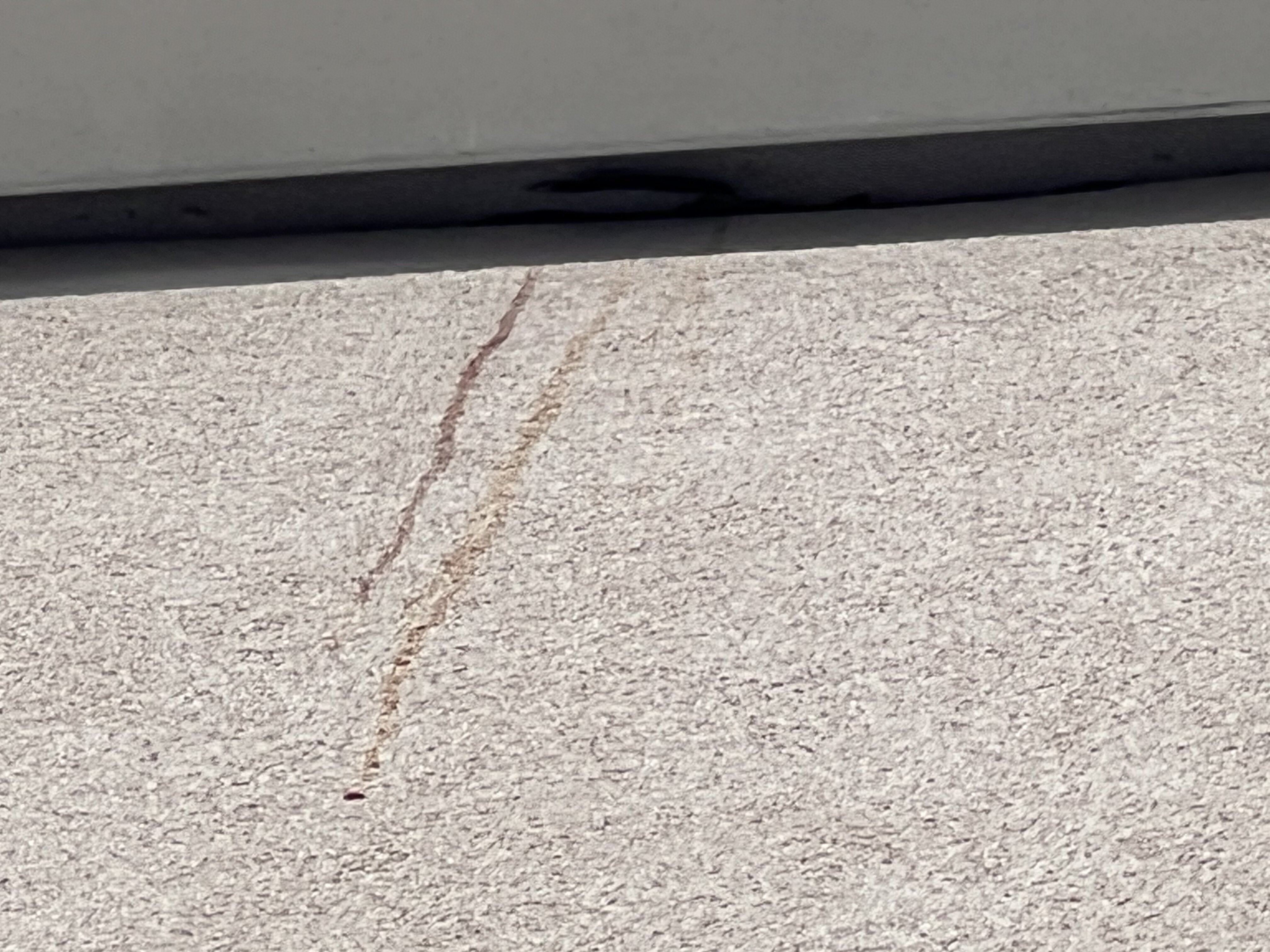

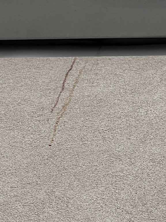

Lorr Posted May 25, 2022 Report Posted May 25, 2022 (edited) Im also experiencing this brown dripping. I recently had the siding removed and had stucco put onto my house. We went on the roof But don't see any place it could be coming from Edited May 25, 2022 by Lorr
Les Posted May 25, 2022 Report Posted May 25, 2022 any photo that would show what we are looking at? where is this on your house?
