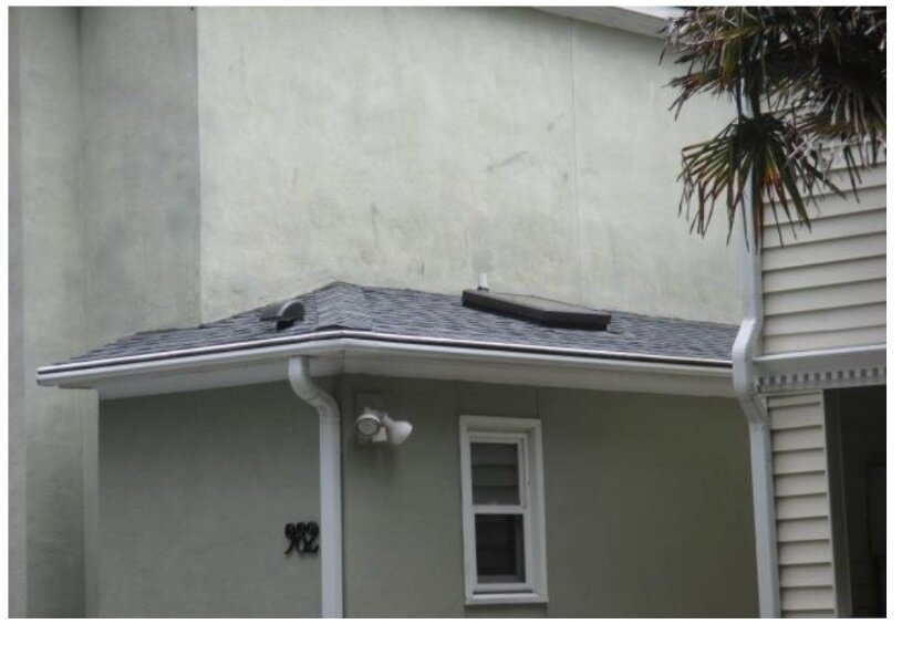

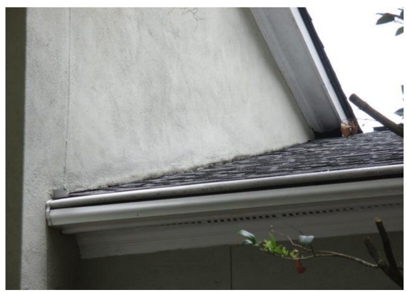

Kristie Brown Posted July 9, 2024 Report Posted July 9, 2024 My client had an inspection done and the inspector noted the following in the roof section: The shingles are touching stucco siding in various areas around the home. When we questioned the roofing company that recently installed the roof he said... "There is a flashing behind the stucco, and under the shingles, and the shingles are installed as close to the walls as possible. The shingles touching the wall should not have any issue in the future. The shingles have to be installed tight as they can for prevention of leaks.” Is this the proper way to do this? Should we accept this or is there a differnet manufacturer install requirement with shingles? Is this going to be an issue later? thx!
hausdok Posted July 9, 2024 Report Posted July 9, 2024 It's hard to tell from your photos if the flashing is interlaced into the shingles, though I do see one photo of a kickout behind the left end of the gutter in the last photo. If the flashing protruding from beneath the stucco is interlaced in the shingles on the slope, I don't see an issue.
Bill Kibbel Posted July 10, 2024 Report Posted July 10, 2024 12 hours ago, Kristie Brown said: My client had an inspection done and the inspector noted the following in the roof section: The shingles are touching stucco siding in various areas around the home. When we questioned the roofing company that recently installed the roof he said... "There is a flashing behind the stucco, and under the shingles, and the shingles are installed as close to the walls as possible. The shingles touching the wall should not have any issue in the future. The shingles have to be installed tight as they can for prevention of leaks.” Is this the proper way to do this? Should we accept this or is there a differnet manufacturer install requirement with shingles? Is this going to be an issue later? thx! The stucco is not terminated properly - a roofer wouldn't know that. 1. Water wicks up the stucco from the roof surface. 2. Debris can't wash out of that little gap. 3. There are plenty of authoritative sources that state that the stucco should be at least 2" above the roof surface. It should also terminate with a weep screed. 3

Jim Katen Posted July 11, 2024 Report Posted July 11, 2024 5 hours ago, Kristie Brown said: @Bill Kibbel Thanks so much Bill! I guess my next question is what are the risks, knowing that it was done this way? What kind of damages could occur? Water can wick up behind the stucco and rot the wall. The installation in your picture is dead wrong, but it's not the roofer's fault, it's the stucco installer's fault. 1

Jim Katen Posted July 11, 2024 Report Posted July 11, 2024 The roofer can't fix it. You need a stucco contractor to fix it. They'll need to cut back the stucco to about a foot above the roof, install building paper, lath, & weep screed, and lay in new stuco. The roofer did the best he could with what he was given. 1
hausdok Posted July 11, 2024 Report Posted July 11, 2024 Looking at that photo, it appears the stucco guy might have tried to install flashing - he just didn't know the proper specs or technique. One can see a slight difference in the stucco that extends about the height of conventional roof flashing up the stucco wall a height of about 4 inches. It's kind of wavy at the height of about 4 inches. How old is this house and how many re-roofs has it had? There have been times I've seen roofers hack back the stucco, leaving a rough bottom edge, interlace flashing, and then the stucco was restored by someone, showing that slight variation on the surface of the stucco. Other times, roofers installed flashings flat against the stucco and then someone, using fiberglass scrim, laid fresh stucco on top, sort of like an E.I.F.S. termination (which is also supposed to end 2" above the surface). If one looks closely at the joint where the stucco meets the roof, at a couple of places the bottom of the stucco is perfectly straight as if it terminates on top of a piece of flashing. It's still wrong, but there might be flashing there. The question is, if there is flashing there, did the roofer interlace the new shingles in the existing flashings or just shove the new shingles beneath? If the latter, wind-driven water blown between the shingles and flashings will reach the wall felt and drain down that wall. On one house I found where they did that, the wall framing directly below had been badly damaged by rot. Not always though. In my area we have deeper overhangs than shown in the picture, and if a joint is on the leeward side of a house, they won't suffer any infiltration until someone gets up on that roof with a pressure washer and directs the water directly toward that joint. Stucco is technically waterproof, and when I've scanned it on a dry day with a Protimeter, it read dry except where moisture had accumulated behind the wall in sheathing, and that was only revealed by scanning the wall from below because it would detect the flashings if scanned on the stucco near that joint. That was how I discovered the rot in that aforementioned wall.
