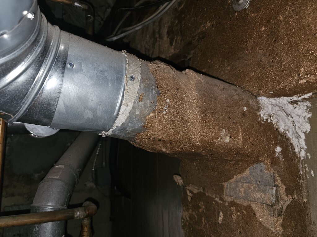

Matthew Jardine Posted August 23, 2023 Report Posted August 23, 2023 Good evening gentlemen, I am having issues identifying this substance on the ducting from an early 1930's era home. The white tape I know is asbestos and is included in my report but the brown granulated substance I am not familiar with. It had almost a cork type texture and was on most of the main trunk ducts except where the ducting had been replaced over the years. I have inspected a few homes in this subdivision and this is the first time I remember seeing it and Google is not helping. Any of you gents have some information you could impart unto me? Thank you in advance
Bill Kibbel Posted August 24, 2023 Report Posted August 24, 2023 Hi Mathew, Look into the Armstrong Cork & Insulation Co. They manufactured many products for industrial processes and almost all of the cork building materials - and there are many. Duct insulation was one of their products. I see it occasionally - not real common in residential. 1
Les Posted August 24, 2023 Report Posted August 24, 2023 Present but also uncommon in Mid-Michigan. Most that I have seen had traces of asbestos. Very common in the old auto factory buildings and in the early oil field production machinery. great question.
Matthew Jardine Posted August 24, 2023 Author Report Posted August 24, 2023 Bill - Thanks for the name. That actually makes it much easier. Found an old publication which really opened up the avenues for more research Les- I appreciate it. I've been at this a while and it never ceases to amaze me to learn how much I don't know. Which is why I lurk on this forum as much as possible. Thank you both for the information! I appreciate it tremendously!
