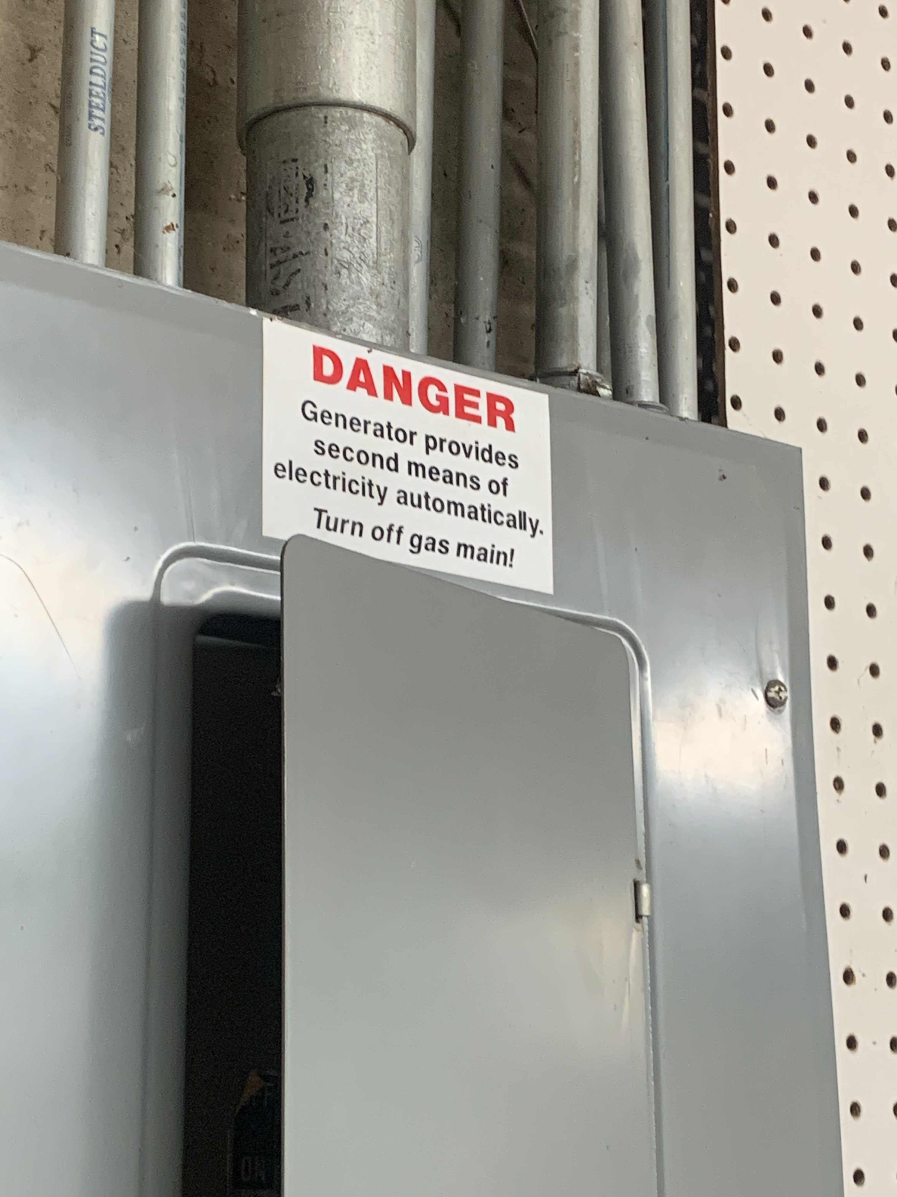

Jerry Simon Posted January 17, 2022 Report Posted January 17, 2022 I don't understand why the gas main would need to be turned off? (So the gas-fired generator won't accidentally turn-on when messing with the panel?)
Marc Posted January 19, 2022 Report Posted January 19, 2022 (edited) In case you think that turning off the main breaker means that the panel is dead. The sensor that tells the generator that the utility source is dead may be connected to the panel itself instead of upstream of the main disconnect. Edited January 19, 2022 by Marc 1
