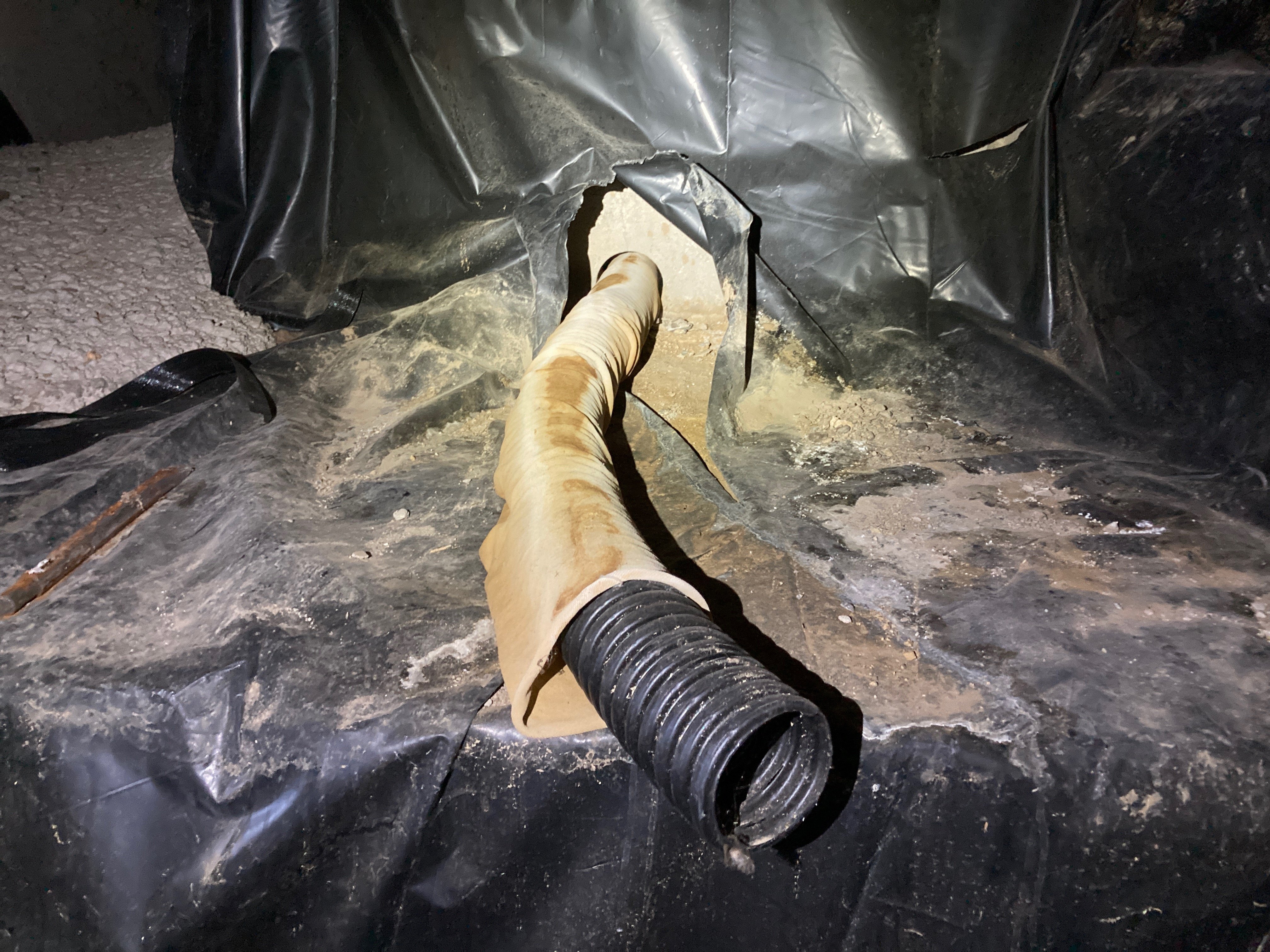

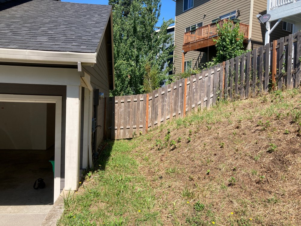

CNewhouse Posted July 2, 2021 Report Share Posted July 2, 2021 Any ideas? The other side of this foundation wall is below the garage slab. Certainly looks to me like the footing drain at the right side of the home (bottom of that slope) is draining into the crawlspace. A 4" core was drilled through the poured concrete foundation wall to allow that corrugated pipe through. But why? Seems like a lot of work to create a problem. Link to comment Share on other sites More sharing options...
Marc Posted July 2, 2021 Report Share Posted July 2, 2021 Rainwater needs to be diverted to the street. Link to comment Share on other sites More sharing options...

CNewhouse Posted July 3, 2021 Author Report Share Posted July 3, 2021 13 hours ago, Marc said: Rainwater needs to be diverted to the street. Right, I agree. My question is, why would someone take the time to drill through an 8" concrete wall rather than simply routing the piping around the foundation to daylight? Order of operations got wacky and backfilling had already happened? Link to comment Share on other sites More sharing options...

Jim Katen Posted July 3, 2021 Report Share Posted July 3, 2021 If the downspout's rain drain were connected to the pipe in the crawlspace, you'd see extensive signs of water just below the end of that pipe. I think someone was trying to drain water out from below the garage slab. Link to comment Share on other sites More sharing options...
