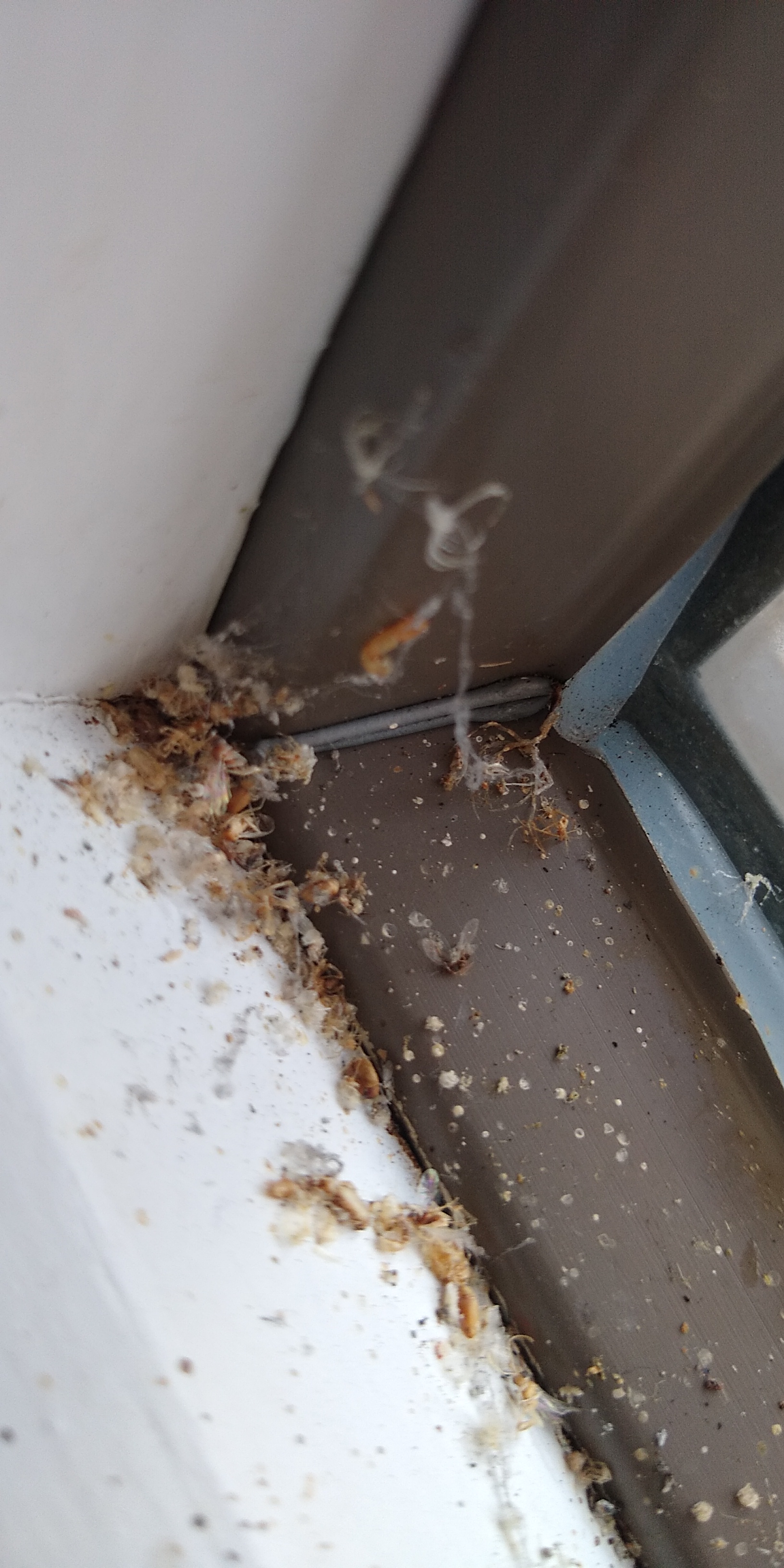

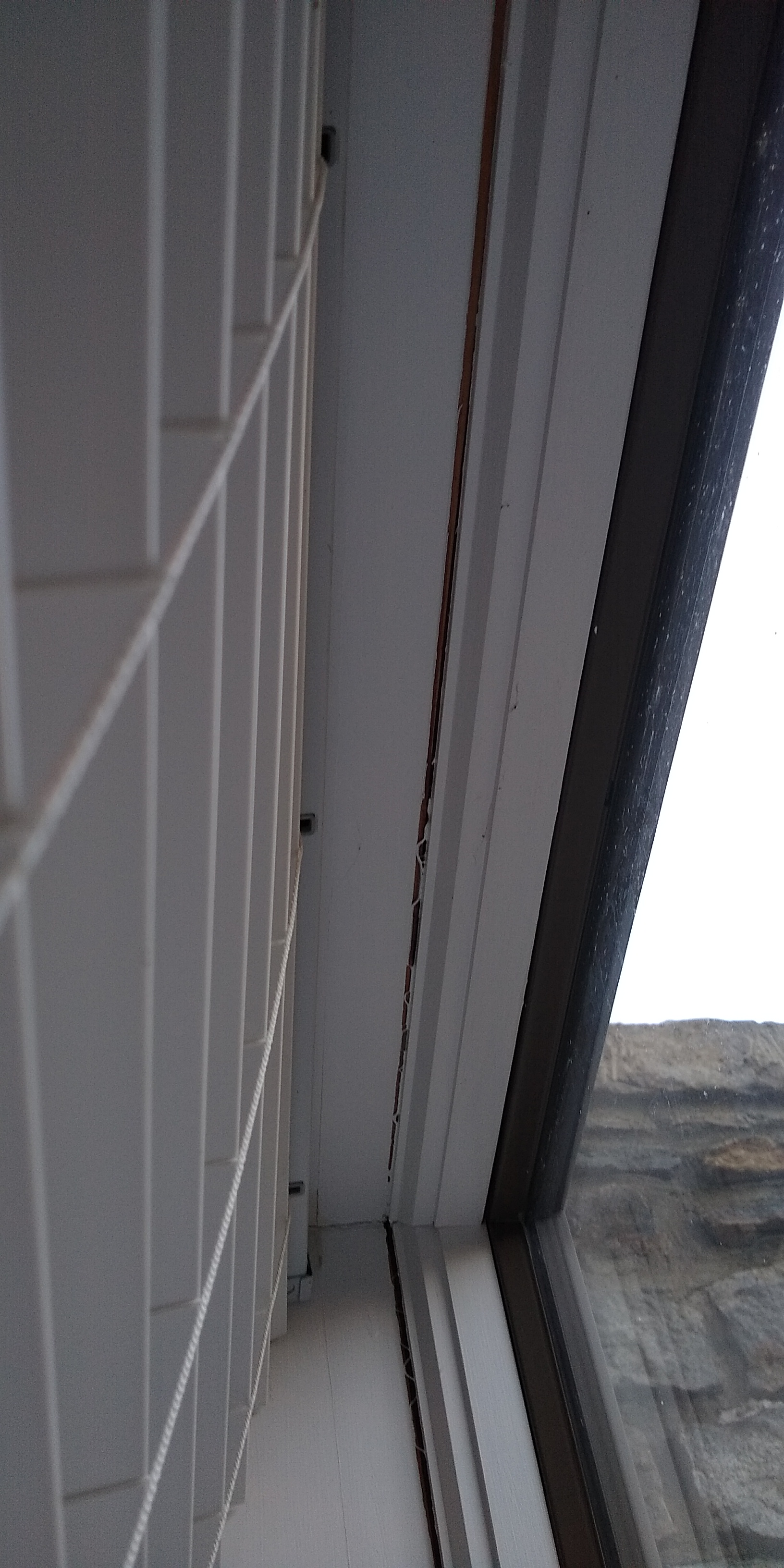

Inco Posted May 12, 2021 Report Share Posted May 12, 2021 (edited) Can you identify this insect debris in a window? The last photo shows damage to the window frame above. Edited May 12, 2021 by Inco Link to comment Share on other sites More sharing options...
Jim Katen Posted May 12, 2021 Report Share Posted May 12, 2021 That's spider debris. The small separation at the top of the window shouldn't be related to insects. Is the window flashed on the outside? 1 Link to comment Share on other sites More sharing options...

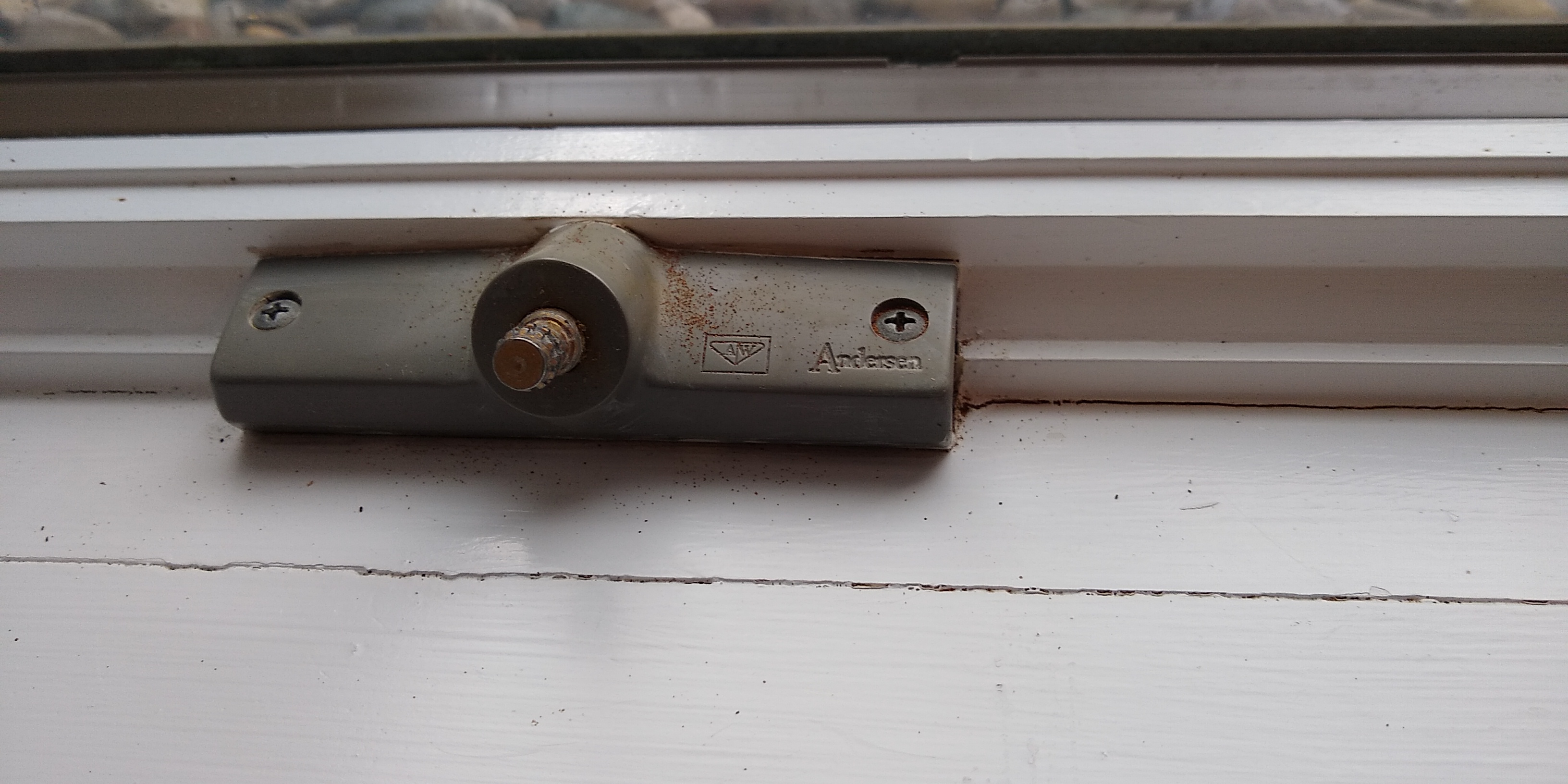

Inco Posted May 12, 2021 Author Report Share Posted May 12, 2021 There's also something on the inside on the crank. It's been cleared away but keeps coming back. The house was built in 1988. These are Anderson windows. I have no reason to believe there wouldn't be flashing. Link to comment Share on other sites More sharing options...
Jim Katen Posted May 13, 2021 Report Share Posted May 13, 2021 22 hours ago, Inco said: There's also something on the inside on the crank. It's been cleared away but keeps coming back. Looks like general dust & debris sifting out from the gap between the window frame and the window casing. 22 hours ago, Inco said: These are Anderson windows. I have no reason to believe there wouldn't be flashing. Seriously? It's just as easy to omit flashing on an Anderson window as it is on any other window. 1 Link to comment Share on other sites More sharing options...
