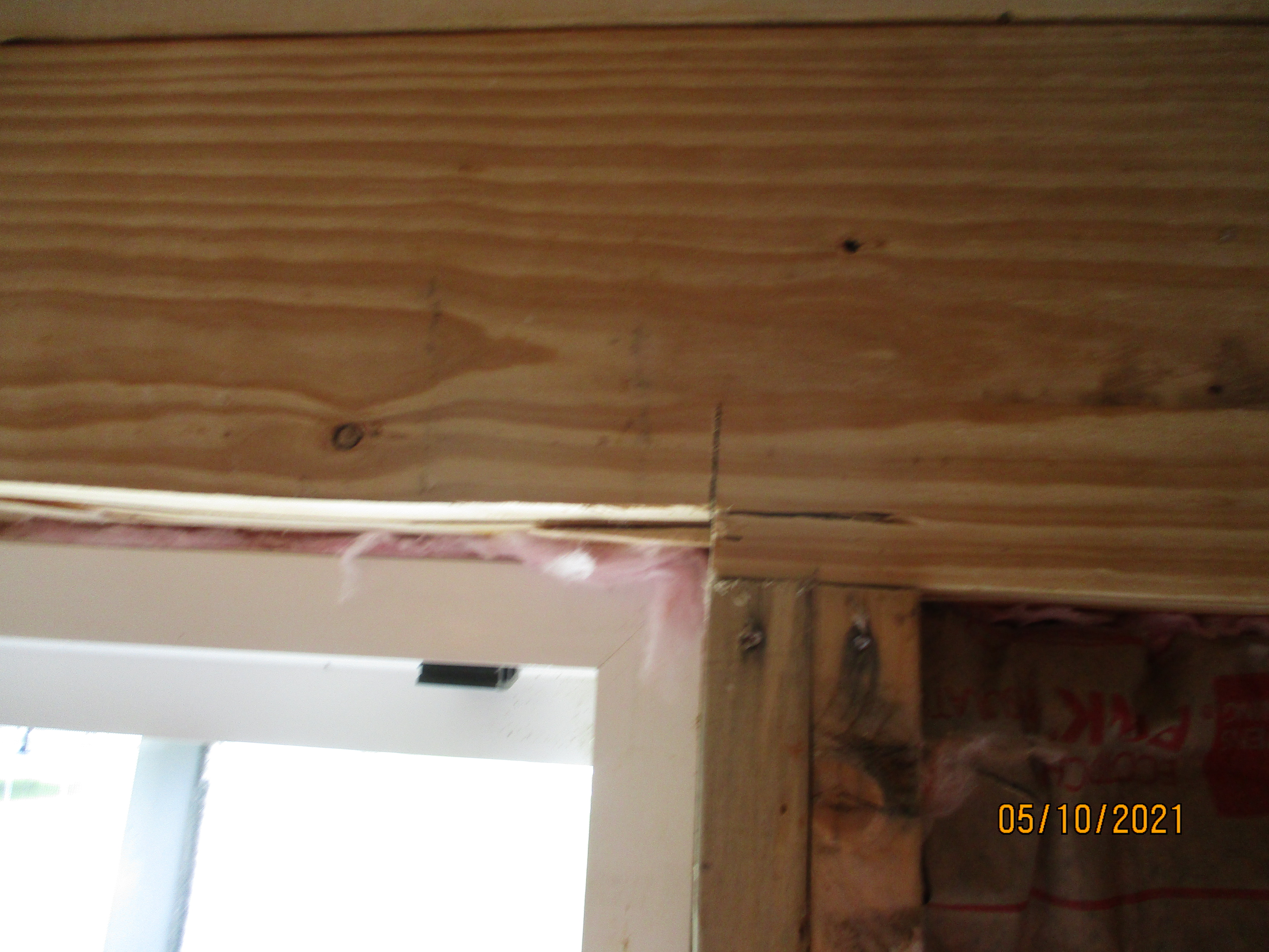

Matthew Jardine Posted May 10, 2021 Report Share Posted May 10, 2021 Good afternoon ladies and gents. I am writing a report for a new build I inspected this afternoon and ran into a header that I am assuming (yes I know what they say about assuming) was notched to fit in a sliding glass door. I am drawing a complete blank on coming up with reasoning why they shouldn't have done this. I don't recall a code cite for headers offhand and I'm having issues finding much information online. I can't recall seeing a header notched before. Plenty of joists, beams and the like. At the worst they've poorly notched out approximately 2" from the doubled 2x8's. Other than being a hack job can you learned gentlemen steer me in the right direction? Link to comment Share on other sites More sharing options...
Marc Posted May 11, 2021 Report Share Posted May 11, 2021 (edited) It looks like a wide header. Goes all the way from opening to top plates. Unless the opening is more than 4' wide, and there is no more than one story above it, I wouldn't make a fuss over it. When I framed houses, we'd put the smallest header that was required, with the height of the opening a little higher, perhaps 3/4 inch, just to insure that we had plenty of room for whatever component as going to end up there. If it turned out to be too high, it's easy for the door guy to 'build it down' to whatever he wants. Edited May 11, 2021 by Marc Link to comment Share on other sites More sharing options...
Matthew Jardine Posted May 11, 2021 Author Report Share Posted May 11, 2021 Appreciate the info Marc. It was wider than 4' as it was above the sliding glass doors but there's just a single story above Link to comment Share on other sites More sharing options...
Jim Katen Posted May 11, 2021 Report Share Posted May 11, 2021 A header is a beam, so 502.8.1 for all the limitations. If this is a pre-drywall inspection, why not just look at the plans? I doubt that they specify that particular detail. Link to comment Share on other sites More sharing options...
Matthew Jardine Posted May 12, 2021 Author Report Share Posted May 12, 2021 Jim, Not a pre-drywall inspection just a regular inspection on a brand new home. And thank you for the reminder that a header suffers the same limitations as beams do. I was overthink things as I do on occasion. Appreciate the help you guys Link to comment Share on other sites More sharing options...
