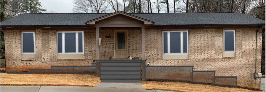

JAG70 Posted April 27, 2021 Report Share Posted April 27, 2021 Hi. I have a ranch built in 1972 in NC that has a 10x6 porch projecting off the front. This porch landing is 38" above ground on one side and about 52" on the other. It has never had a rail, but I will need to do one now that I am about to complete a remodel on the interior. Challenges I have are that the landing is about 3" below the new main egress door. To address this I plan to lay sleepers and install a nice composite over the well-seated tile surface. I will also be replacing the old brick stairs and installing decorative railing and a handrail. As we are planning this work, my contractor has suggested we could soften (so to speak) the projecting porch appearance by creating step down landings off each side of the porch. Due to the furnace HVAC fresh air intake/exhaust (on the right of the porch in the pic) he's proposing the first landing be 23" down. So as not to interfere with the furnace vent he is not planning to install a step, saying the height differences between these landings can be up to 24" since the main stairs are the egress - he mentioned this is common on multi-tier decks. I am wondering if you experts agree? He's said if the inspector had a problem with it he would come back and add a couple 36" wide steps between each landing, but I'm unclear how we would do that with the HVAC vent there. Wouldn't steps be required no matter what? I am attaching a "current" pic and a mockup of what I'm describing as I know my description is not that great. TYIA. Link to comment Share on other sites More sharing options...
Marc Posted April 27, 2021 Report Share Posted April 27, 2021 (edited) I don't see any issue with the porch being 3 inches lower than the threshold on the front door. I also don't see how curb appeal is going to be improved by 'step down' landings on each side of the porch. When I look at the top photo, the first thing that gets my attention is the lack of a cosmetic boundary at the first floor level, something that separates the house from that which supports the house. The solution shown in the lower photo doesn't do the job, but looks much more expensive to build than a simple cosmetic boundary. Why not step the porch down to the driveway on the right (if that's what I'm seeing there)? That's in addition to the cosmetic boundary. Edited April 27, 2021 by Marc Link to comment Share on other sites More sharing options...
JAG70 Posted April 28, 2021 Author Report Share Posted April 28, 2021 Thank you for the quick response Marc. You are (of course) correct about the height to the thread hold. I was thinking about my basement where I was dinged for 311.3.1 “Landings or finished floors at the required egress door shall be not more than 11/2 inches (38 mm) lower than the top of the threshold. Exception: The landing or floor on the exterior side shall be not more than 73/4 inches (196 mm) below the top of the threshold provided that the door does not swing over the landing or floor.” My problem there was on the inside not the out. I would appreciate your thoughts on another question please. If we step the right down to the driveway and have multiple landings with steps down to each landing (couple of steps and a run of 36”+ then couple of steps, etc.) does the landing break up the “run” of steps so that the delta of a maximin 3/8” difference between each step pertains precisely to those steps between two landings? Perhaps I worry to much and should leave it to the porch contractor. Thank you for your thoughts. Link to comment Share on other sites More sharing options...
Marc Posted April 28, 2021 Report Share Posted April 28, 2021 It's not so much a stairway as it is series of sidewalk segments that accommodate the change in elevations. Just keep the riser and tread dimensions consistent. 1 Link to comment Share on other sites More sharing options...
Jim Katen Posted April 28, 2021 Report Share Posted April 28, 2021 I think the porch is fine the way it is. Invest in some good landscaping for crying out loud. It'll do way more for the house than a bunch of pointless concrete. 1 1 Link to comment Share on other sites More sharing options...

rjbrown2 Posted May 13, 2021 Report Share Posted May 13, 2021 (edited) Are we in Handrail and Guardrail territory with this porch ? If I count correctly, we have six risers on the Stairs and the Elevation change of at least the Right side (as we view it) appears greater than 30 inches. <bb Edited May 13, 2021 by rjbrown2 typo off to of Link to comment Share on other sites More sharing options...
JAG70 Posted May 13, 2021 Author Report Share Posted May 13, 2021 Hi rjbrown2. For sure! I'm thinking of using horizontal black metal railing, but absolutely, railing will be needed. Even though most of the left side of the porch wouldn't require it, I'm planning to try to use the same amount/feet in each direction of the main porch just to keep things symmetric. Thank you for your help! Link to comment Share on other sites More sharing options...
