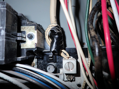

Mike Lamb Posted April 26, 2021 Report Share Posted April 26, 2021 Is this worth calling out for repair? Or noting at all? The SEC neutral apparently would not reach the new panel lugs so it has been spliced with three 12 AWG wires. The schematics call for a single wire but I assume the main neutral was also a strand. Link to comment Share on other sites More sharing options...
Jim Katen Posted April 27, 2021 Report Share Posted April 27, 2021 It's pretty damn wrong. I'd certainly tell them to get it fixed. 1 Link to comment Share on other sites More sharing options...
