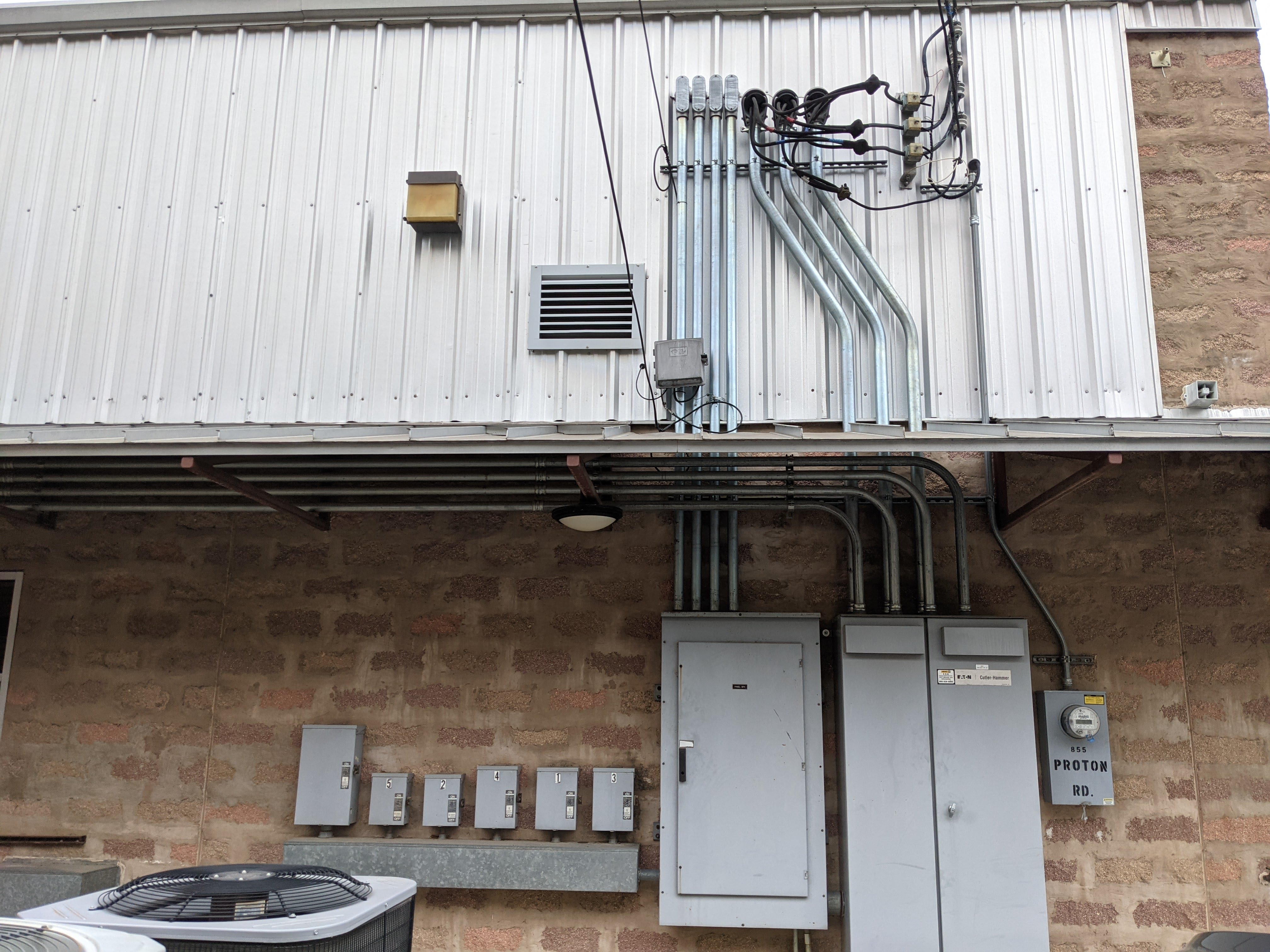

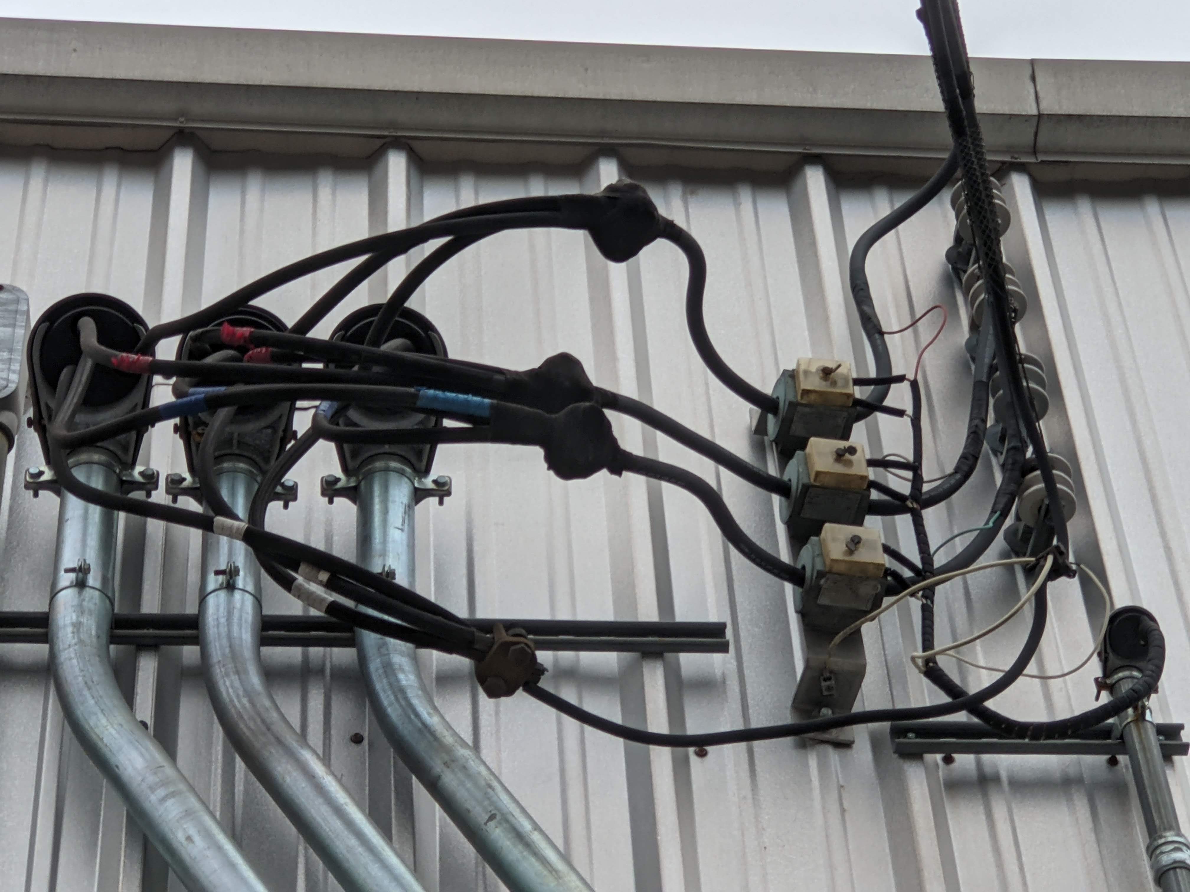

MPdesign Posted March 25, 2021 Report Share Posted March 25, 2021 I was an electrical design/builder 12 years ago, but I have having trouble remembering what size conductors are exactly. I am looking at the main on the right. It has no label - which is so wierd. Anyway, it is 120/208. Can anyone identify the probable Ampacity? I am thinking 600A. I know it can be identified from the feeder cable. Link to comment Share on other sites More sharing options...
Marc Posted March 25, 2021 Report Share Posted March 25, 2021 600 looks in the ballpark. I doubt the utility conductors passing through the current transformers could handle 800. 600 would mean 200 through each set of SE conductors, which makes sense. 1 Link to comment Share on other sites More sharing options...
