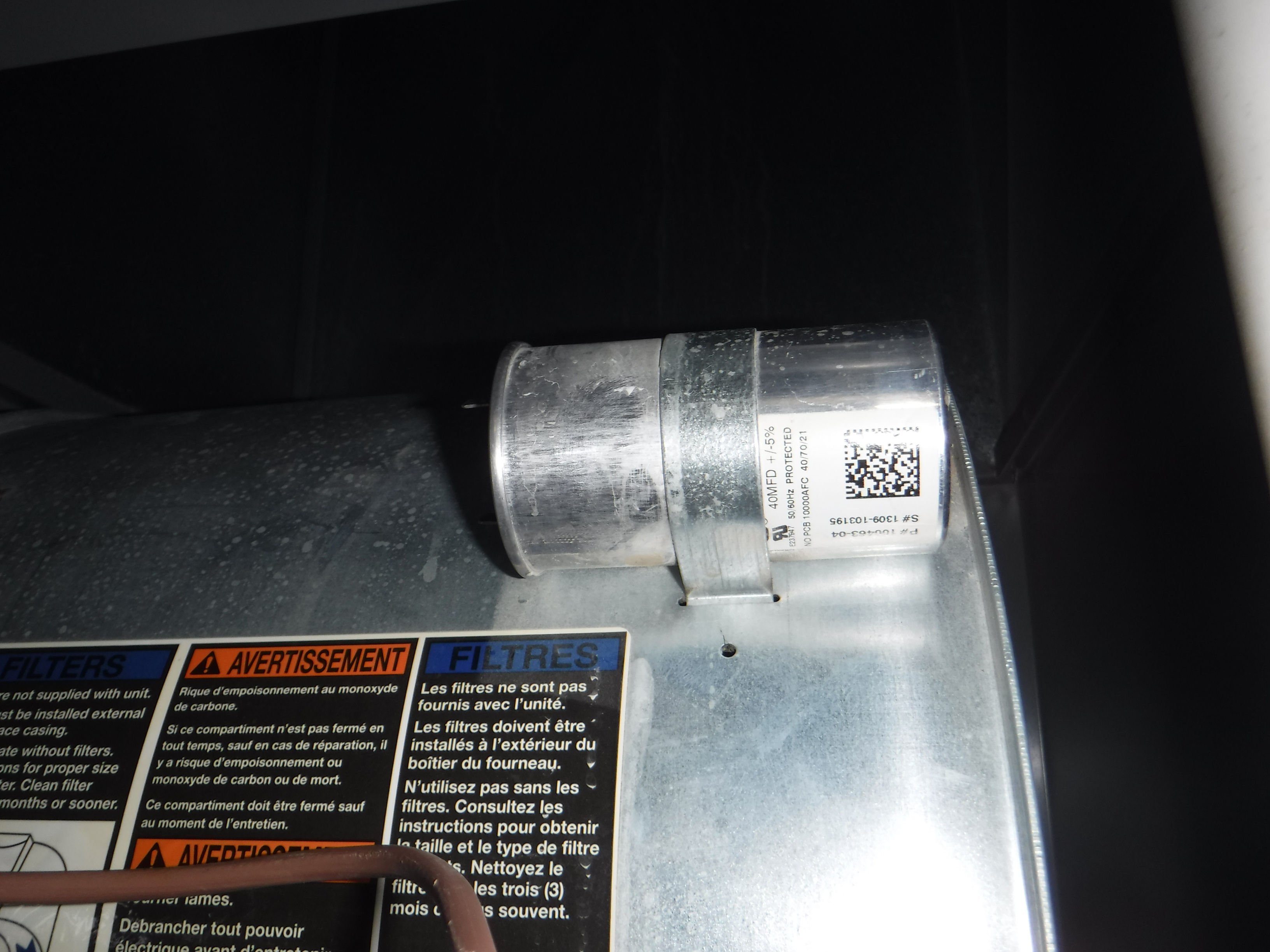

Jim Katen Posted January 14, 2021 Report Share Posted January 14, 2021 One of my partners snapped this picture of an unconnected capacitor in a 2013 furnace. My best guess is that the manufacturer uses one shroud for both its cap blowers and its non-cap blowers. Any other insights? Link to comment Share on other sites More sharing options...
Marc Posted January 14, 2021 Report Share Posted January 14, 2021 9 hours ago, Jim Katen said: One of my partners snapped this picture of an unconnected capacitor in a 2013 furnace. My best guess is that the manufacturer uses one shroud for both its cap blowers and its non-cap blowers. Any other insights? Where's the picture? Link to comment Share on other sites More sharing options...
Jim Katen Posted January 15, 2021 Author Report Share Posted January 15, 2021 Sorry. I just added the picture. Link to comment Share on other sites More sharing options...
Marc Posted January 15, 2021 Report Share Posted January 15, 2021 I don't recall ever seeing a blower with other than a capacitor-start motor. That unconnected capacitor is a mystery to me. Link to comment Share on other sites More sharing options...
John Kogel Posted January 15, 2021 Report Share Posted January 15, 2021 My guess is that the motor has a cap mounted on it, a replacement maybe, need pics. Link to comment Share on other sites More sharing options...
Jim Katen Posted January 16, 2021 Author Report Share Posted January 16, 2021 18 hours ago, Marc said: I don't recall ever seeing a blower with other than a capacitor-start motor. That unconnected capacitor is a mystery to me. Really? I've seen many - or perhaps the capacitors were hidden. Link to comment Share on other sites More sharing options...
Marc Posted January 16, 2021 Report Share Posted January 16, 2021 7 hours ago, Jim Katen said: Really? I've seen many - or perhaps the capacitors were hidden. Ya know, it might be that an original capacitor-start motor was replaced with an ECM motor. ECMs don't use capacitors, they're 'electronically commutated', if that makes any sense. If that were true, the control circuitry would need to be replaced also. Link to comment Share on other sites More sharing options...
Jim Katen Posted January 16, 2021 Author Report Share Posted January 16, 2021 Perhaps. Or maybe the manufacturer was putting together a furnace with an ECM motor and they just slapped on the wrong shroud one day - or maybe the cap had already been installed on a shroud and someone forgot to take it off. Link to comment Share on other sites More sharing options...
