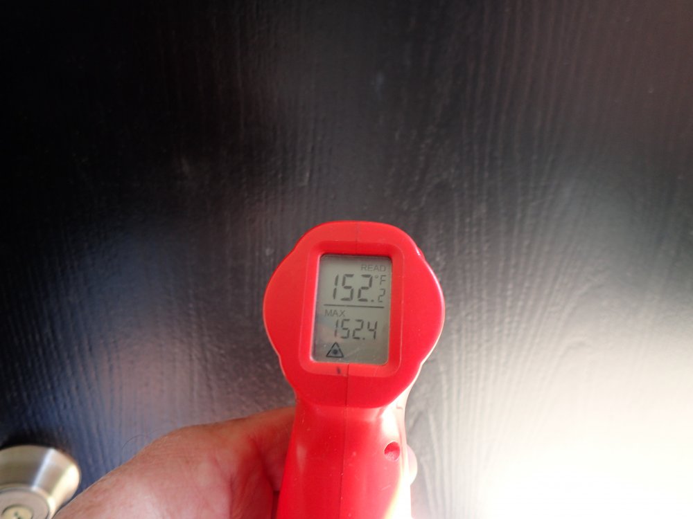

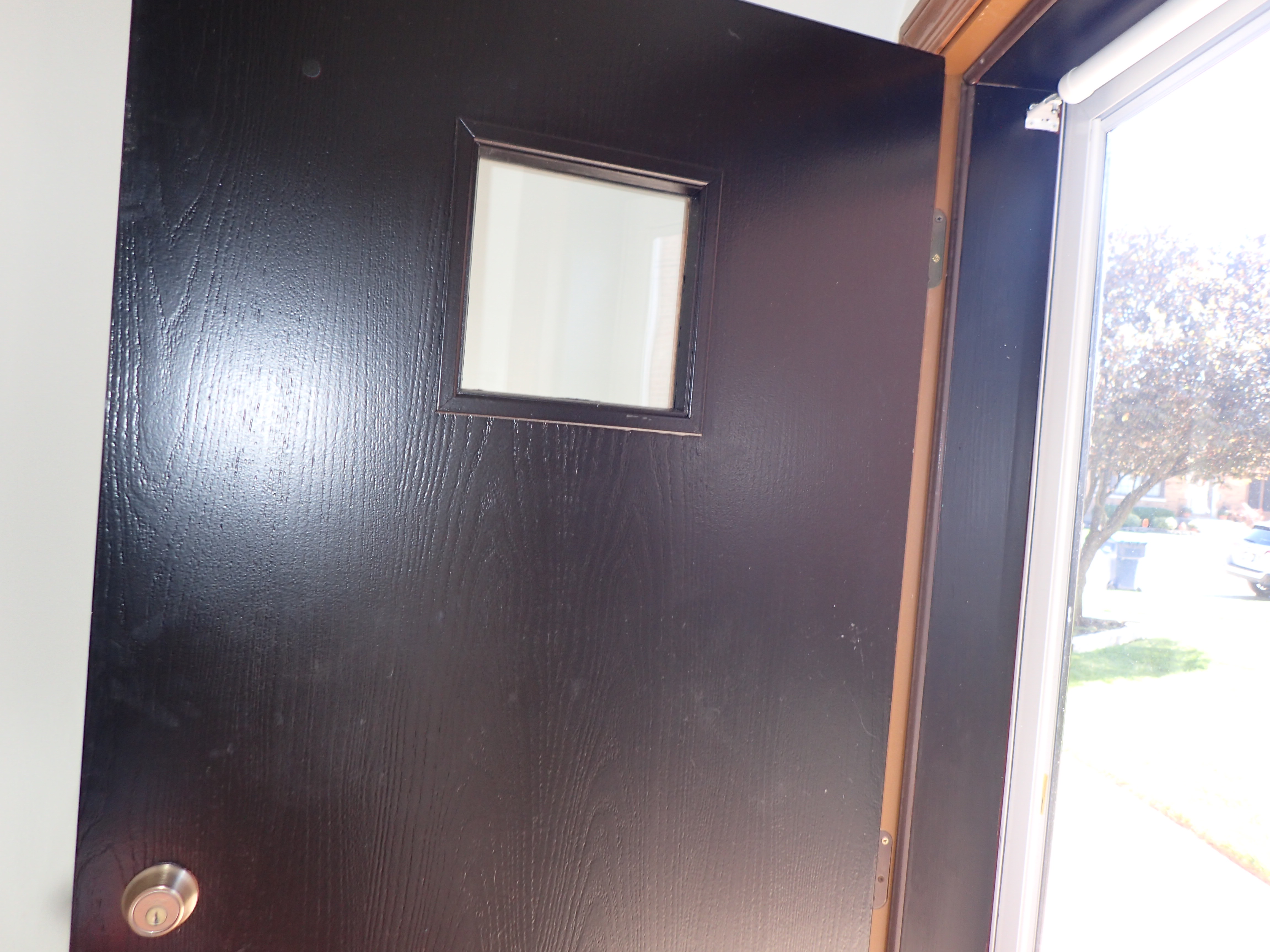

Mike Lamb Posted October 3, 2020 Report Posted October 3, 2020 I have read installation instructions where south facing doors should not have glass storm doors installed because of extreme heat. A black door does not help. This is a good illustration for that advice.
Mike Lamb Posted October 3, 2020 Author Report Posted October 3, 2020 The outside temp. today was 50F.
Jim Katen Posted October 3, 2020 Report Posted October 3, 2020 Yes. It's really nasty when they're metal doors. One touch and you're burned.
Tom Raymond Posted October 5, 2020 Report Posted October 5, 2020 Fiberglass doors are fun. The hot side expands while the cool interior doesn't and bends the door off the weatherstripping.
Mike Lamb Posted October 5, 2020 Author Report Posted October 5, 2020 1 hour ago, Tom Raymond said: Fiberglass doors are fun. The hot side expands while the cool interior doesn't and bends the door off the weatherstripping. And the sealant around the glass melts.
Rob Amaral Posted October 7, 2020 Report Posted October 7, 2020 Add a storm-door and bingo.... melting window-frames and decor..
