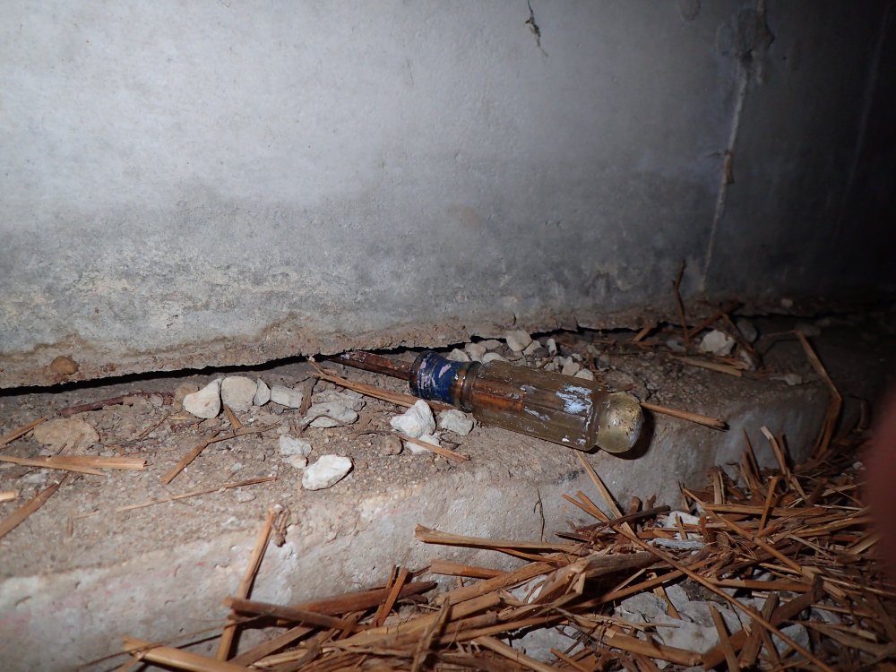

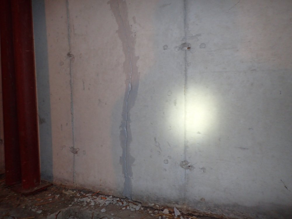

Mike Lamb Posted September 16, 2020 Report Posted September 16, 2020 What do you make of this? About 8 foot of the foundation near the two steel columns In this crawlspace has lifted/separated about a half-inch to three-quarter inch space between the foundation wall and the footing. There was no undue stress to the foundation or problems to the structure/floors above. There is a caulked foundation crack nearby but did not look anything out of the ordinary. 32-year-old house.
Jerry Simon Posted September 16, 2020 Report Posted September 16, 2020 Settled footing. Just saw one with over an 8" drop. Like you said, nothing above suggested foundation movement itself. (Foundation held in place by adjacent foundation walls, soil pressure, floor structure above.)
Jim Katen Posted September 17, 2020 Report Posted September 17, 2020 I'd recommend grouting the gap. Either that, or insert several hundred more screwdrivers. 1

John Kogel Posted September 18, 2020 Report Posted September 18, 2020 They put enough rebar in that wall to span the dip, I'd say. Grout is a good way to seal the gap. If it was my place I'd shove mortar in as tight as possible.
