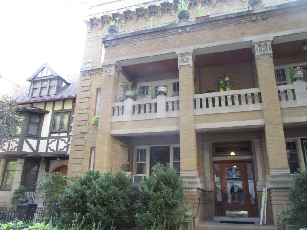

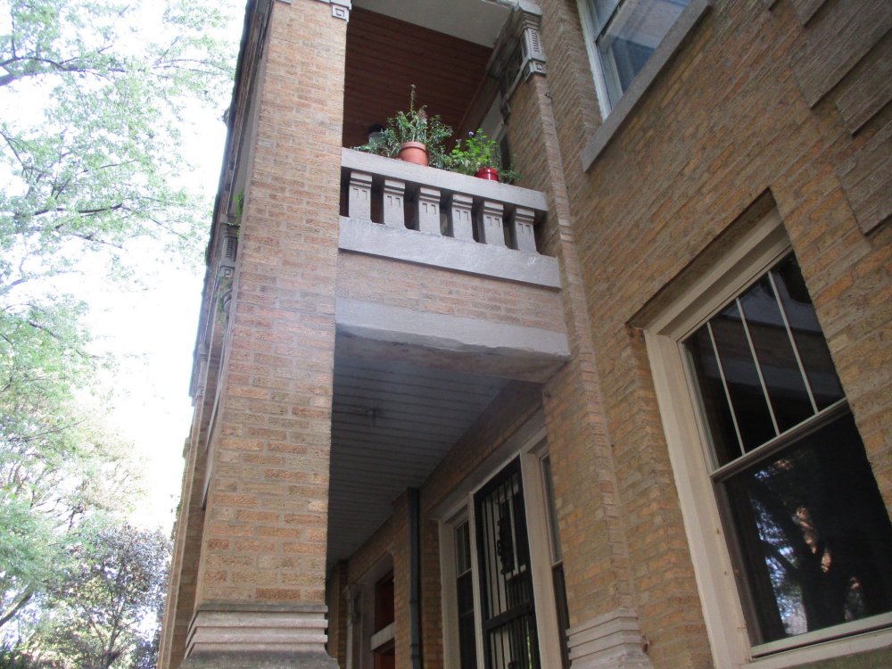

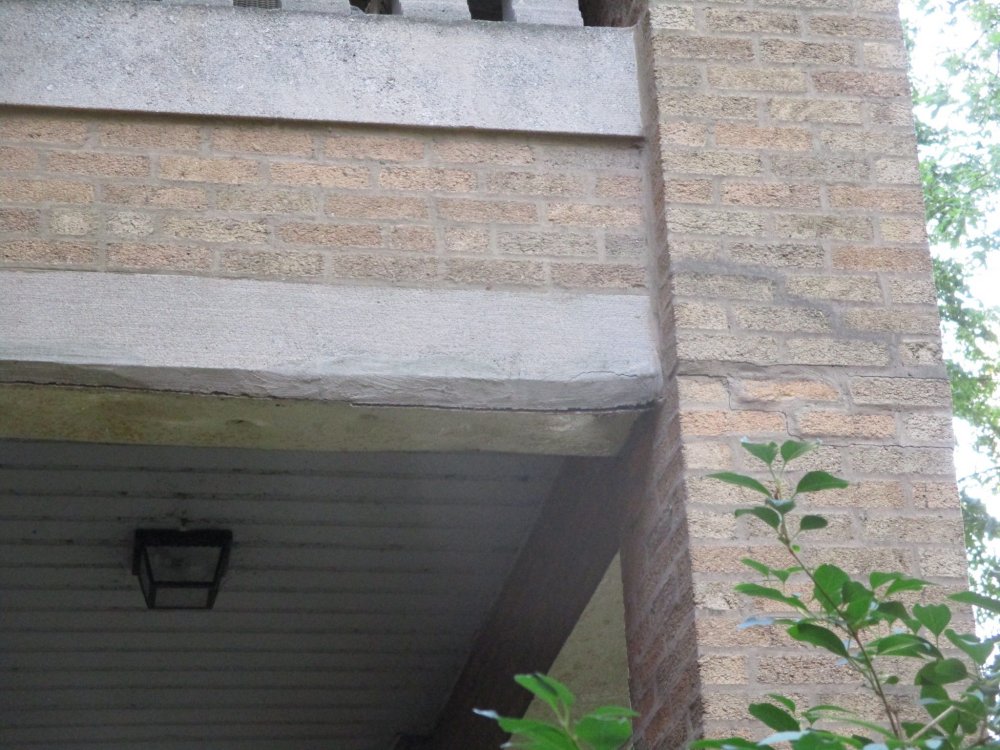

Mike Lamb Posted September 8, 2020 Report Share Posted September 8, 2020 I am interested in any ballpark estimates as to replacement cost for the beams holding up the front balconies of this building. T-beams, I assume. The side ones are the most distressed. Less than 8 feet. Concrete floors at the porches. Also, would the balcony rails/walls need to be rebuilt? Could steel rods or something be inserted to hold up the brick while the beam beneath is replaced? Any thoughts are appreciated. Link to comment Share on other sites More sharing options...
Bill Kibbel Posted September 9, 2020 Report Share Posted September 9, 2020 I'm pretty sure that's gonna need a major rebuild. The displacement of the brick at the columns is as much of a concern as the beams. I couldn't try to guess any cost. Link to comment Share on other sites More sharing options...
