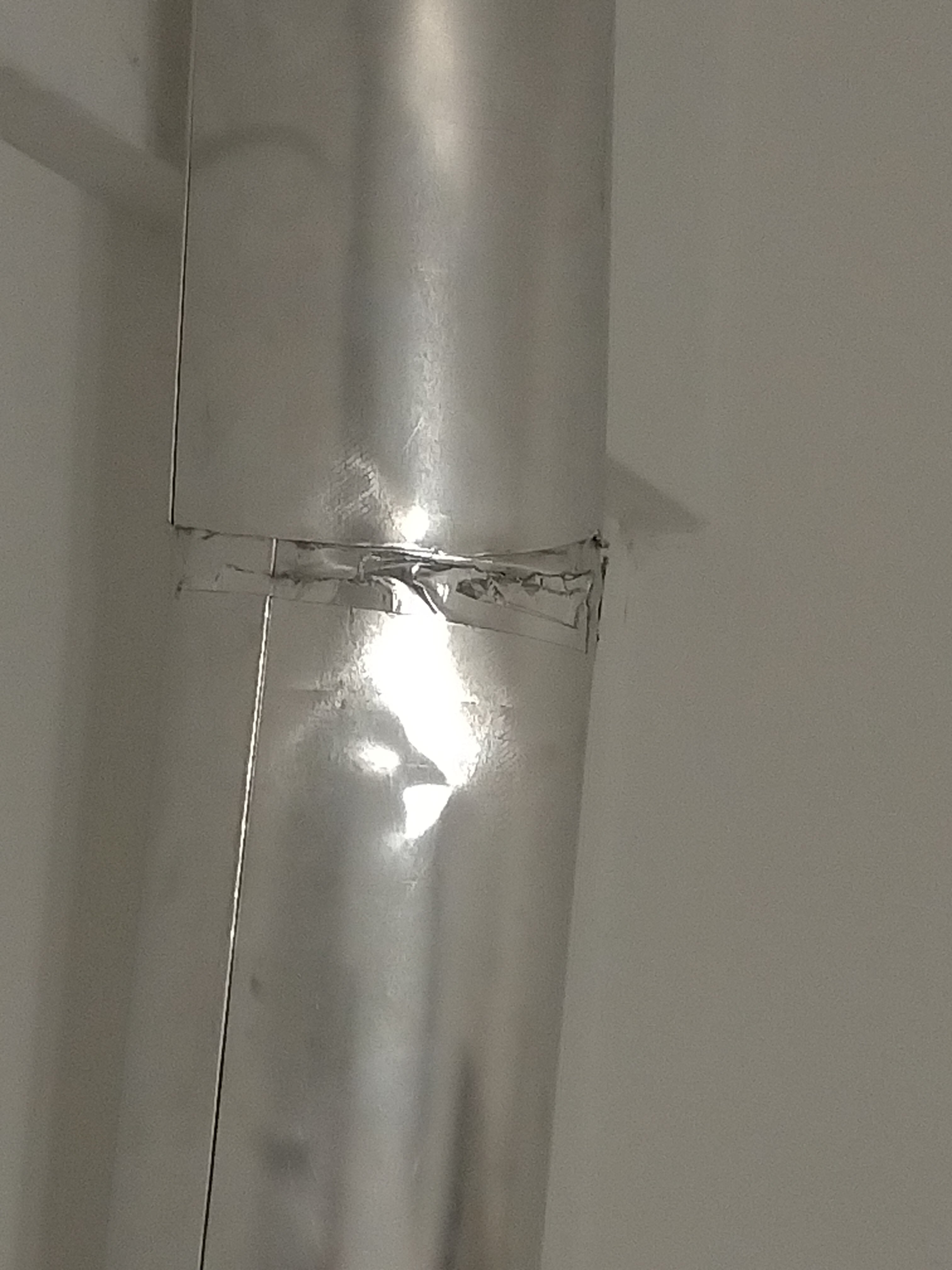

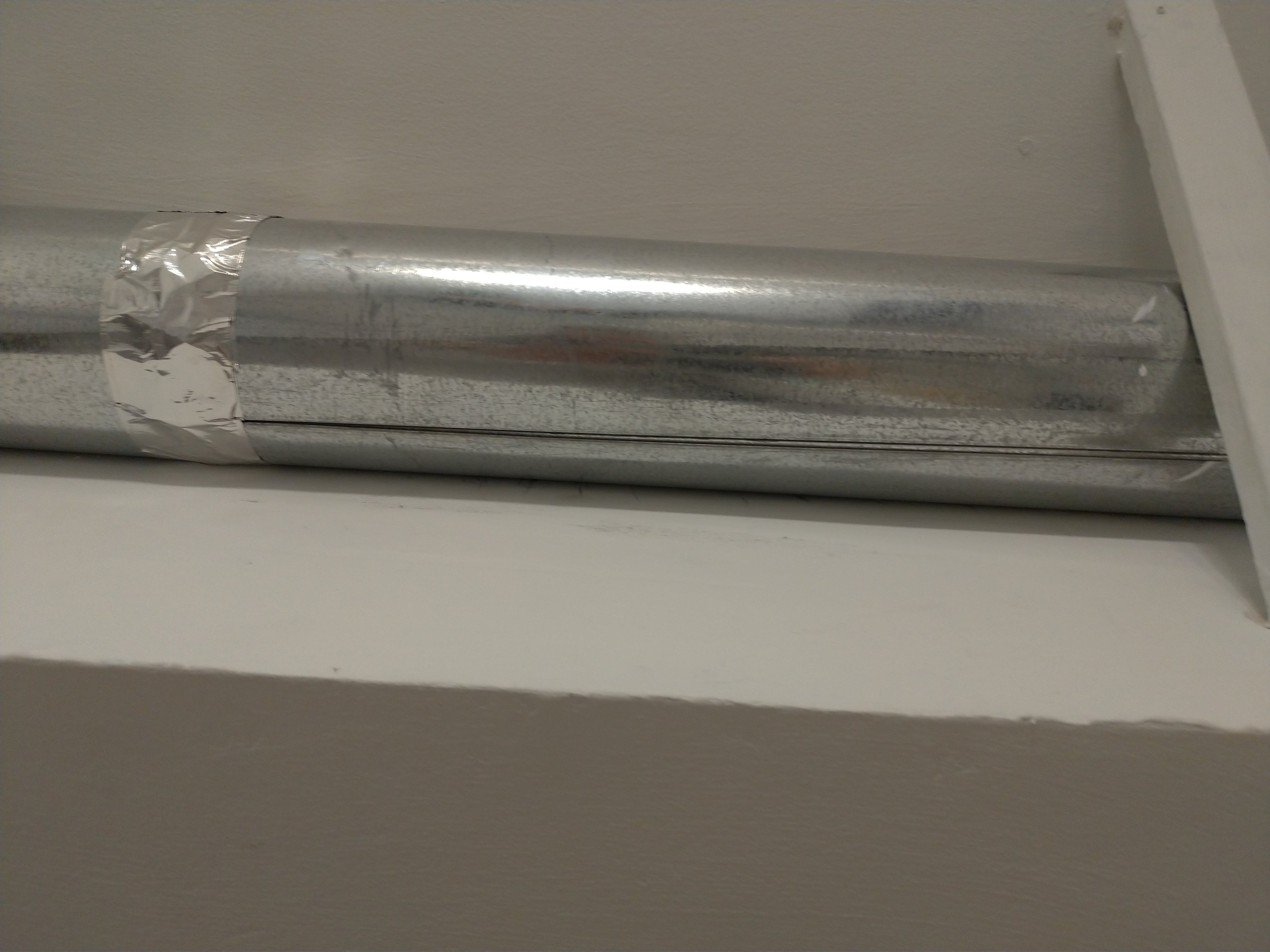

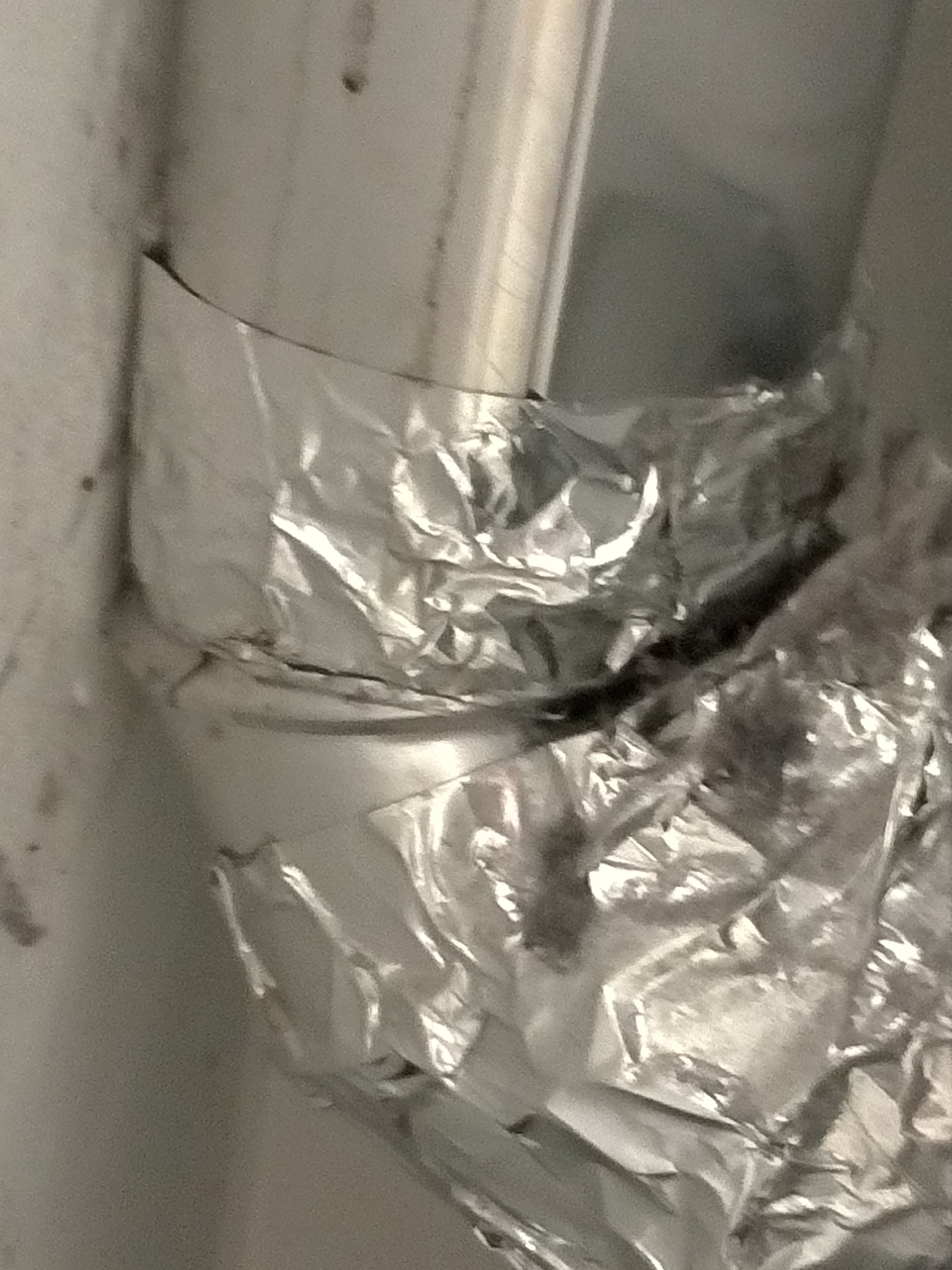

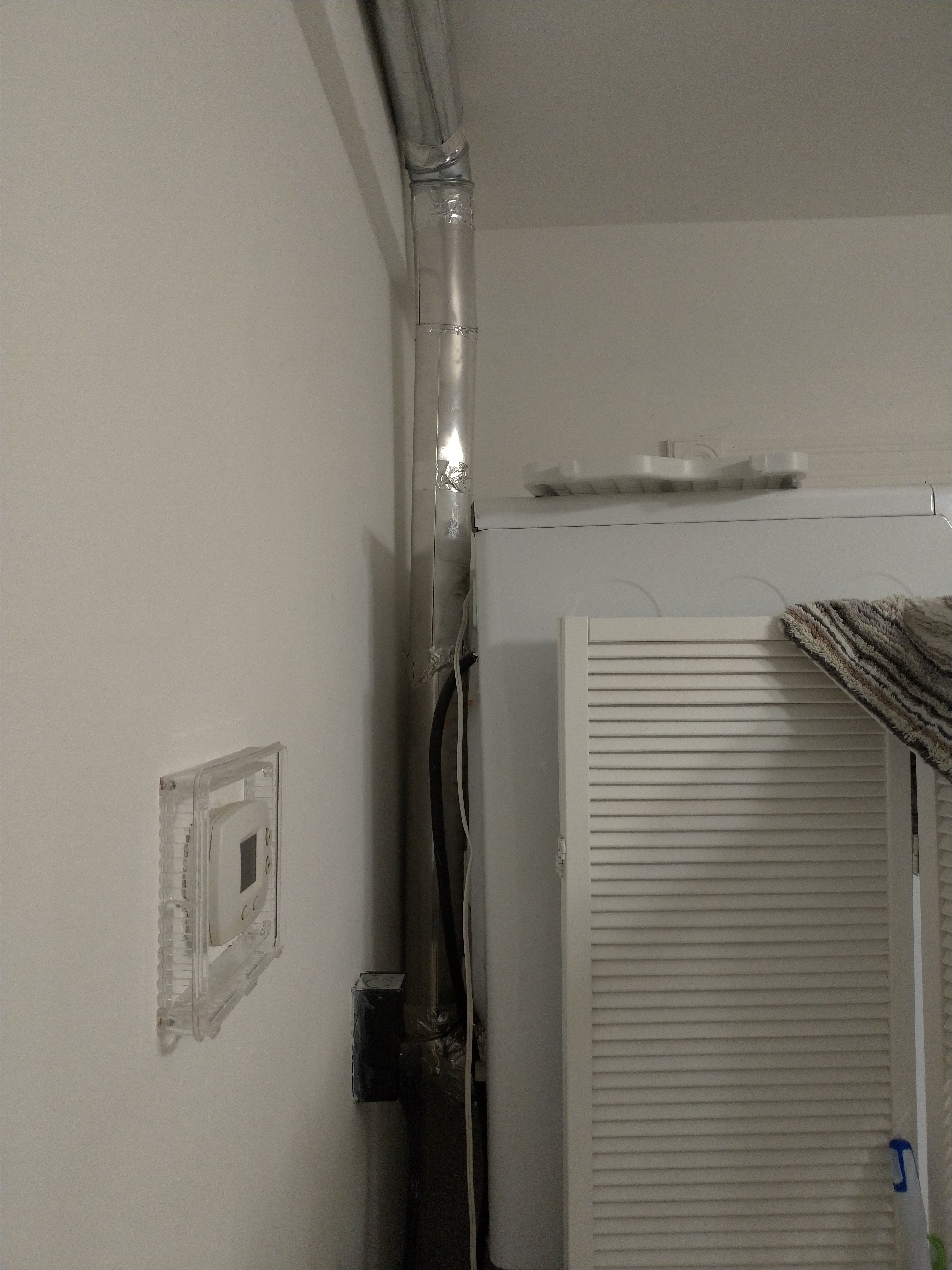

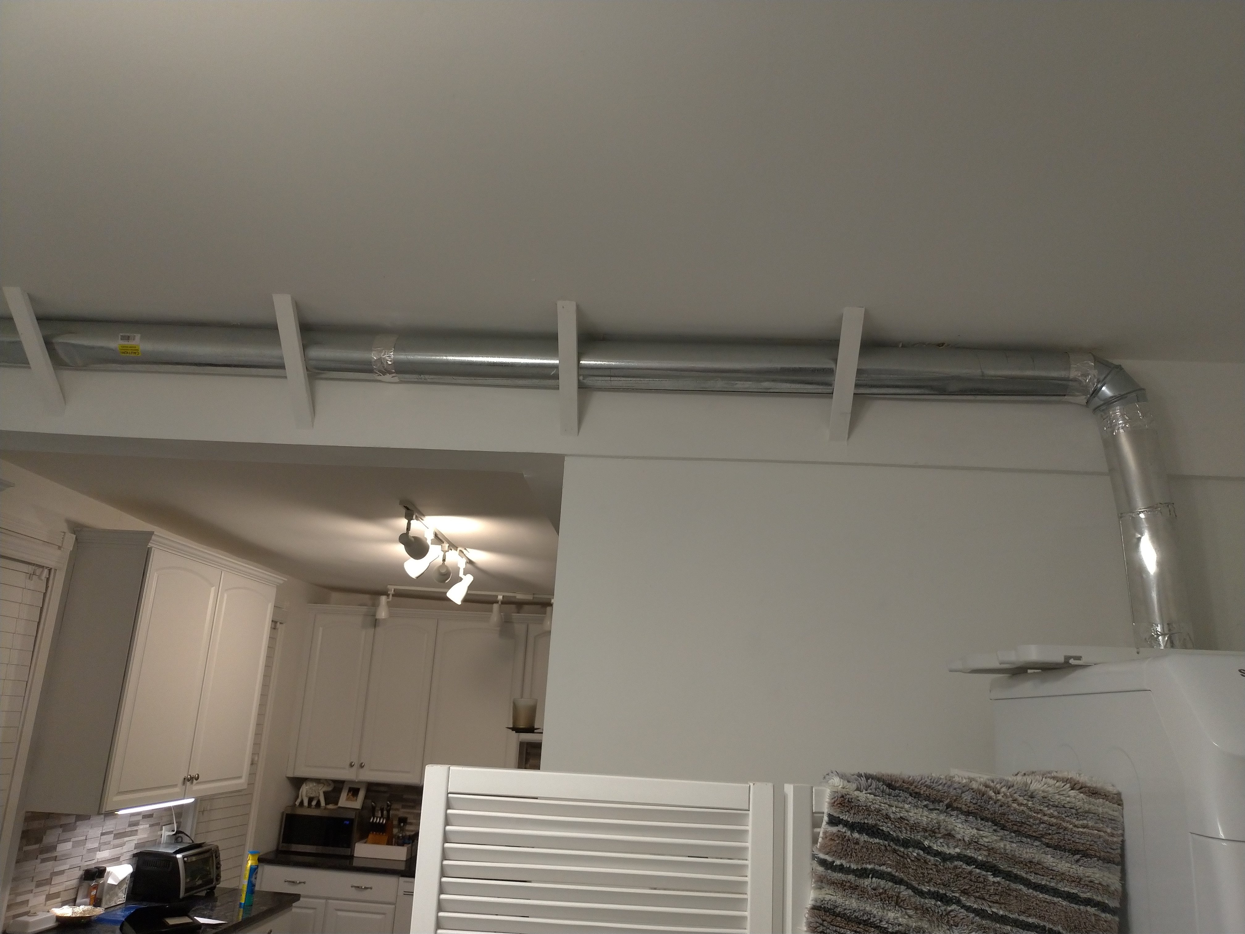

Styls Posted August 12, 2020 Report Share Posted August 12, 2020 I'm very concerned about the rental I moved into. Specifically the electric dryer's exhaust venting. It seems to be leaving a thin coat of lint all over everything in the home including our bed and dog's water dish. The pathway contains several 90 degree elbows and even one upside down vertical channel before exiting to the exterior of the home. In total some 30 ft. Can anyone give me more information on the safety of something like this? It's also seem to have lost integrity in several seems and fittings. Thank You Link to comment Share on other sites More sharing options...
Les Posted August 12, 2020 Report Share Posted August 12, 2020 I saw nothing good about it. Too long (likely), wrong materials, wrong fasteners, etc. google the installation manual for that particular dryer. Cost you more for energy also. Link to comment Share on other sites More sharing options...
Jim Baird Posted August 12, 2020 Report Share Posted August 12, 2020 It is likely full of lint as we speak. Blow it out with a leaf blower for starts. Link to comment Share on other sites More sharing options...
Jim Katen Posted August 12, 2020 Report Share Posted August 12, 2020 It's just your average crappy dryer duct installation as Jim & Les said. The duct should be as short and straight as possible and air-tight (or nearly so). If lint is getting out, so is water vapor, which will cause condensation problems in the winter - unless you live in Denver or someplace like that. As for the lint, it's not particularly dangerous. It's just really little pieces of your clothing. Link to comment Share on other sites More sharing options...

Marc Posted August 14, 2020 Report Share Posted August 14, 2020 (edited) I'd clean the dryer appliance and exhaust duct of all lint. You need a tool to remove packed lint. They're not expensive. After that, and everything is back in place, turn the dryer on and see how much air is coming out at the exhaust duct termination. If you think it's borderline, pull the dryer forward enough to remove the exhaust duct connection from the dryer, turn it on again and feel the air coming from the dryer itself. That should tell you if you've got too much constriction in the dryer duct. Edited August 14, 2020 by Marc Link to comment Share on other sites More sharing options...
