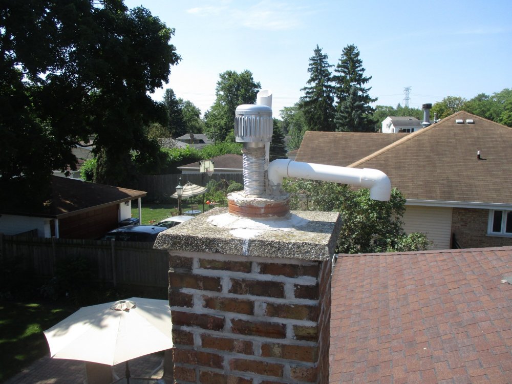

Mike Lamb Posted August 11, 2020 Report Posted August 11, 2020 I thought I had seen a reference where a Cat 4 vent cannot share the same chimney flue with another gas appliance – in this case a newer lined vent for water heater. Any help?
Bill Kibbel Posted August 11, 2020 Report Posted August 11, 2020 The masonry chimney flue has become a chase for added vents, so they're not technically sharing a flue. The big problem is that's probably an uninsulated single-wall metal flue liner, so there's clearance issues to the PVC vent pipes. Also, the metal liner is not secured with a proper collar and the cap isn't attached with a proper fitting. 2
