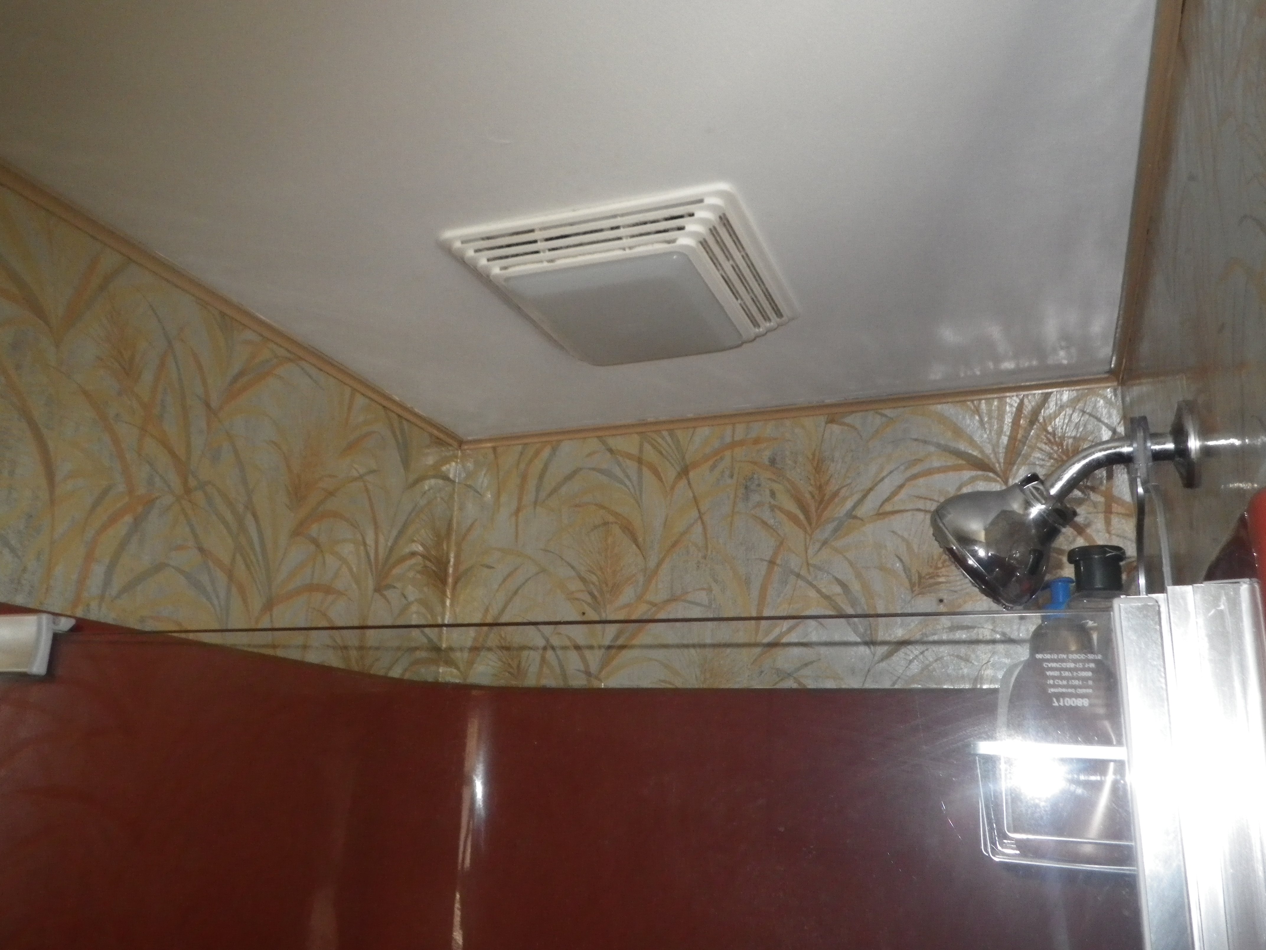

Jerry Simon Posted June 10, 2020 Report Share Posted June 10, 2020 Is this type of exhaust fan rated for a wet location above the shower stall (regardless of GFCI protection)? Link to comment Share on other sites More sharing options...
Jim Baird Posted June 10, 2020 Report Share Posted June 10, 2020 I don't see that as an issue at all. Link to comment Share on other sites More sharing options...
Jim Katen Posted June 11, 2020 Report Share Posted June 11, 2020 I think you'd have to look at the packaging or catalog to know for sure. FWIW, I wouldn't consider that to be a wet location. Link to comment Share on other sites More sharing options...
Tom Raymond Posted June 11, 2020 Report Share Posted June 11, 2020 That's not a wet location. Every bath fan/light combo I've ever seen is approved for that location as long as it's GFCI protected. Link to comment Share on other sites More sharing options...
