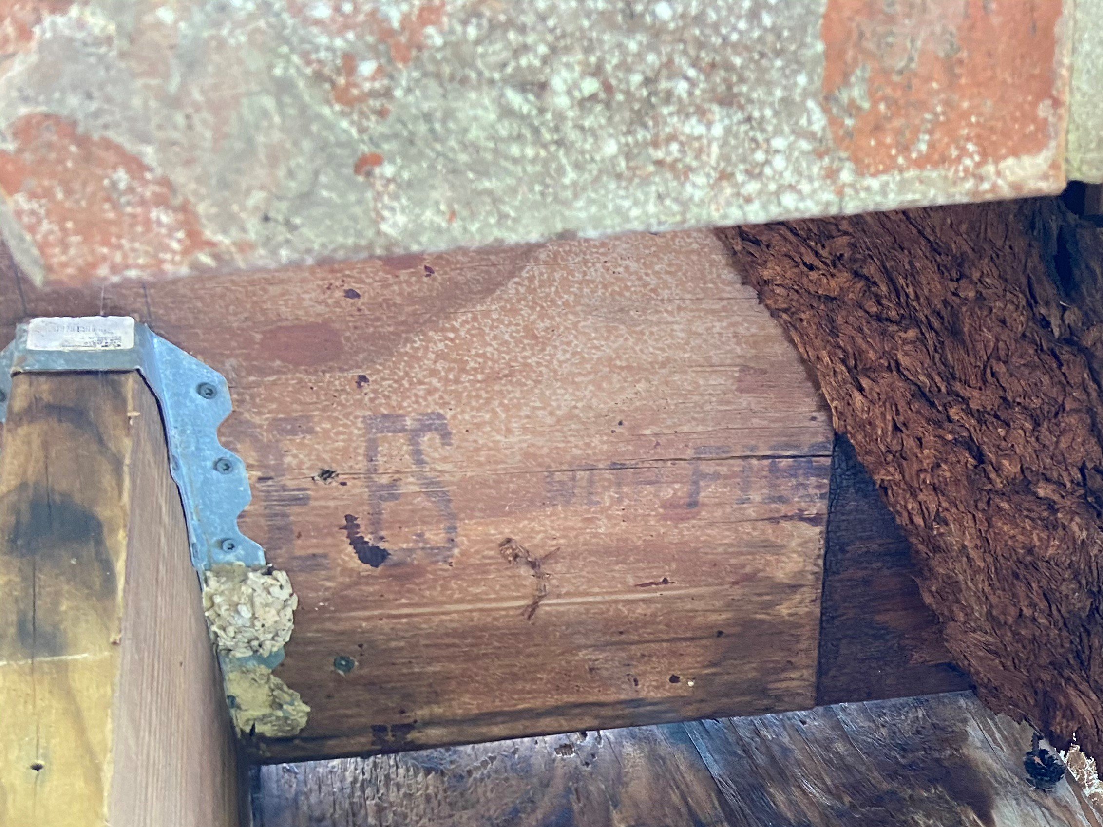

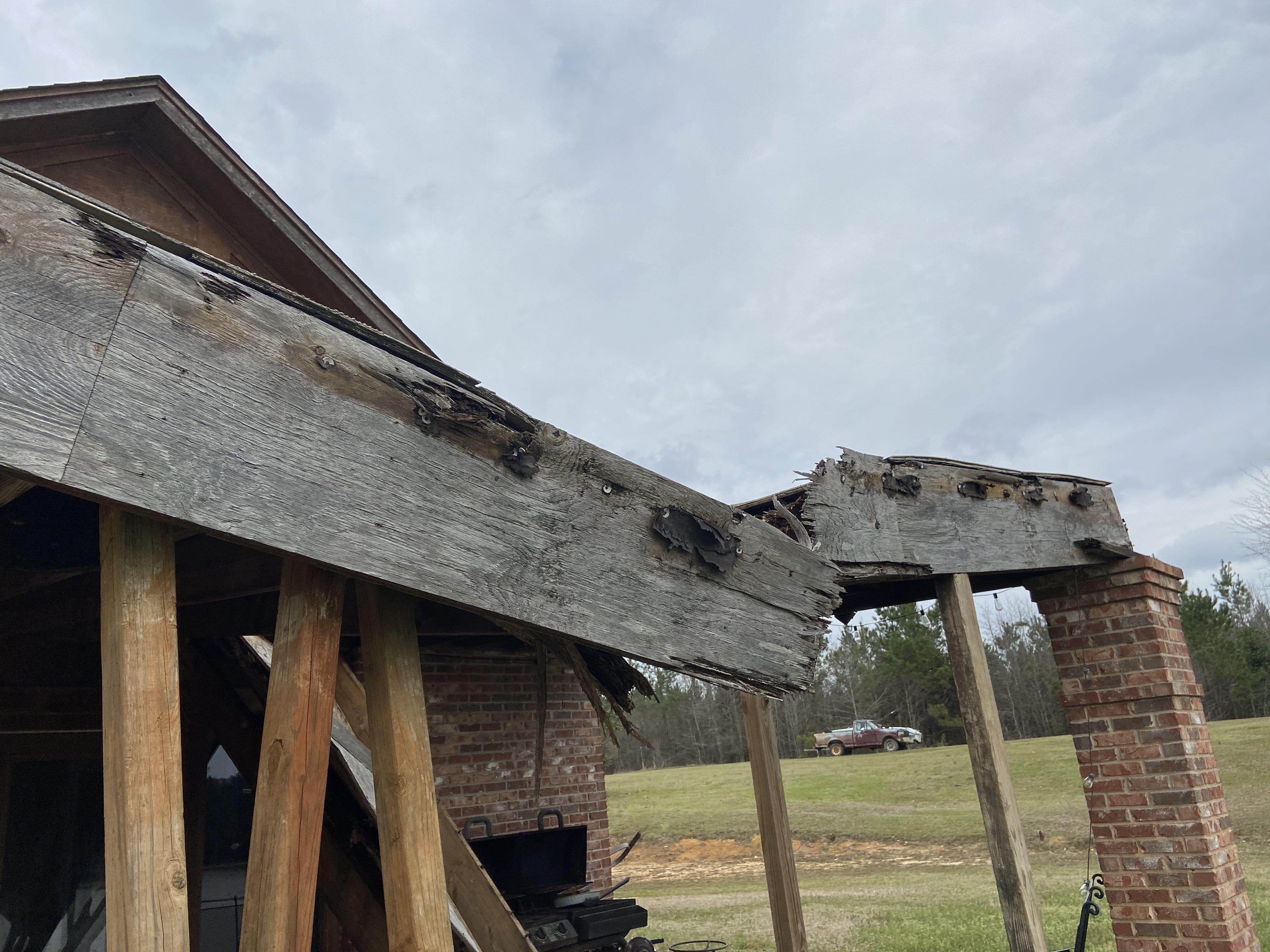

Bobby Jim Posted March 27, 2020 Report Posted March 27, 2020 Inspector friends, can anyone tell me what kind of laminate beam this is? It was used outdoors and does not appear to be suitable for outdoor use. It WAS 24 feet long. I posted a picture of the only marking I could find. Thanks.
hausdok Posted March 27, 2020 Report Posted March 27, 2020 The picture really isn't clear enough to tell. That said, what difference does it make? There is clearly second and third stage woodrot visible, which means the entire thing is infested with first stage rot and has to go. Looks like a special kind of idiot is responsible for that mess. ONE TEAM - ONE FIGHT!!! Mike 1
Jim Katen Posted March 27, 2020 Report Posted March 27, 2020 41 minutes ago, Bobby Jim said: It was used outdoors and does not appear to be suitable for outdoor use. Gee, do ya think? 1

Jim Katen Posted March 27, 2020 Report Posted March 27, 2020 If you're investigating this for forensic purposes, you can probably remove all the other lumber from it and get better pictures of the printing. You might even find the manufacturer's name.
Marc Posted March 27, 2020 Report Posted March 27, 2020 8 hours ago, Bobby Jim said: Yeah, that was said with just a bit of sarcasm. Maybe, or perhaps you mildly insulted him with a comment that suggests that there exist a wood or engineered-wood product that never rots.

Bill Kibbel Posted March 27, 2020 Report Posted March 27, 2020 Every piece of pressure treated LVL I've seen that us over 10 years old has significant rot. Pressure treating LVL post-manufacture didn't work. 1
