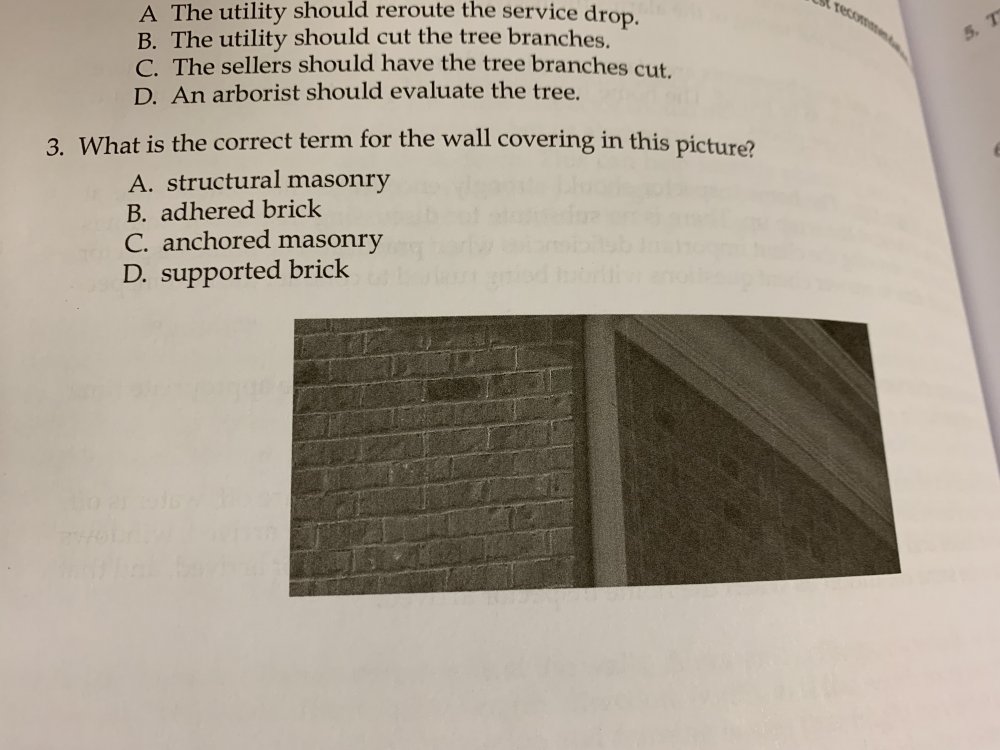

Mycakers Posted February 17, 2020 Report Posted February 17, 2020 I'm not sure where to park this question. I did a quick search and couldn't find anything. I was going through my NHIE text book and one of the review questions showed a picture of the corner of what appears to be a brick exterior. The pic is black and gray and kind of fuzzy. The question asks, identify this type of siding. The answer is Anchored masonry according to the answer key. Are the anchors visible with this type of brick? If not, how would you identify it and report it? Thanks in advance.

Mycakers Posted February 17, 2020 Author Report Posted February 17, 2020 It is the 2015 NHIE Home Inspection Manual. The question is under the Reporting Findings section if you have the book. The pic is literally the corner of a "brick" house. It is so fuzzy that you cannot rule out even fake brick paneling. I can upload a pic when I get home.
Mycakers Posted February 18, 2020 Author Report Posted February 18, 2020 Here is the pic from the book.
Jim Katen Posted February 19, 2020 Report Posted February 19, 2020 So, with the NHIE, it helps to keep in mind that every question should have one undeniably correct answer and three distractors. The undeniably correct answer might not be a term or concept that you would use, but it will have at lease one reference source to back it up - that's almost always the building code or an industry guideline or best-practice guide. The distractors are designed to sound plausible to those who lack the knowledge that the question is designed to test. Your best strategy for taking this test is to forget about what *you* would call this wall, but choose the answer that seems to be the "most" correct. In this question, you can rule out structural masonry right away because all you can see are stretchers, no headers. While it's conceivable that a structural masonry wall *might* be built like this, it's very unlikely. The second choice, "adhered brick" is a possibility, but it's less likely than the next one, "anchored masonry," which is by far the most likely candidate. I have no idea what "supported brick" is supposed to be. I suspect its something that the question writer just made up. Bottom line: I think it's a fair question. Someone who really knows brick will have no trouble getting the right answer. Someone who doesn't might not get it. 1
