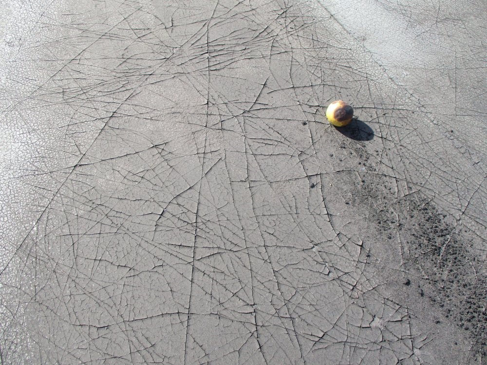

Mike Lamb Posted October 19, 2019 Report Posted October 19, 2019 The modified bitumen roof was in generally good shape except at an area with gathered debris/poor drainage. Would these cuts be from membrane deterioration, or man-made?
Jim Katen Posted October 19, 2019 Report Posted October 19, 2019 It think it's just the white coating shrinking and cracking.
John Kogel Posted October 22, 2019 Report Posted October 22, 2019 Any chance that roof becomes a hockey rink in the winter? 馃槵 2
