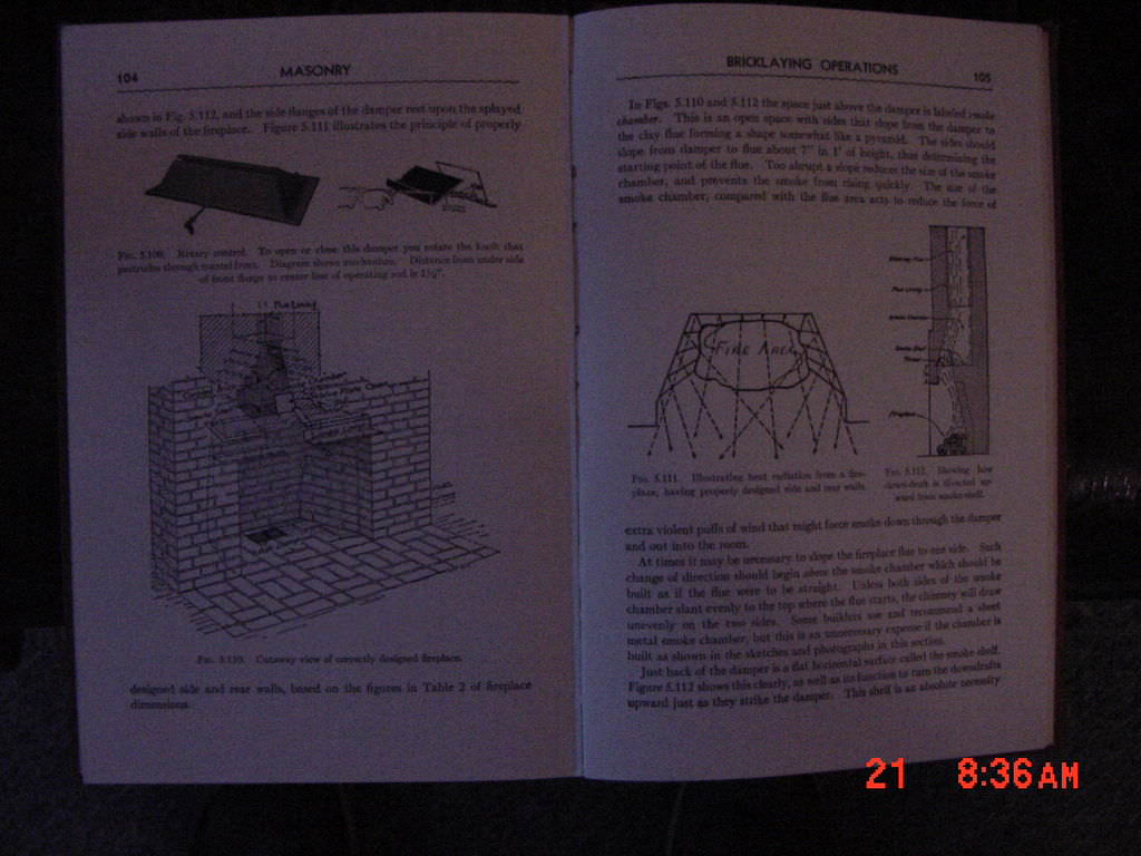

Les Posted February 21, 2006 Report Share Posted February 21, 2006 Everyone knows I love old books, so I remembered a diagram in an old Home Mechanics Book from VanNostrand that shows how a "fireplace" works. When I first saw it, I knew it was a Runsford stove, but it was published 70yrs ago - - - -. Photos of book a little blurry, but gives you the idea. Download Attachment: MVC-001F.JPG 130.31 KB Download Attachment: MVC-003F.JPG 127.22 KB Link to comment Share on other sites More sharing options...
