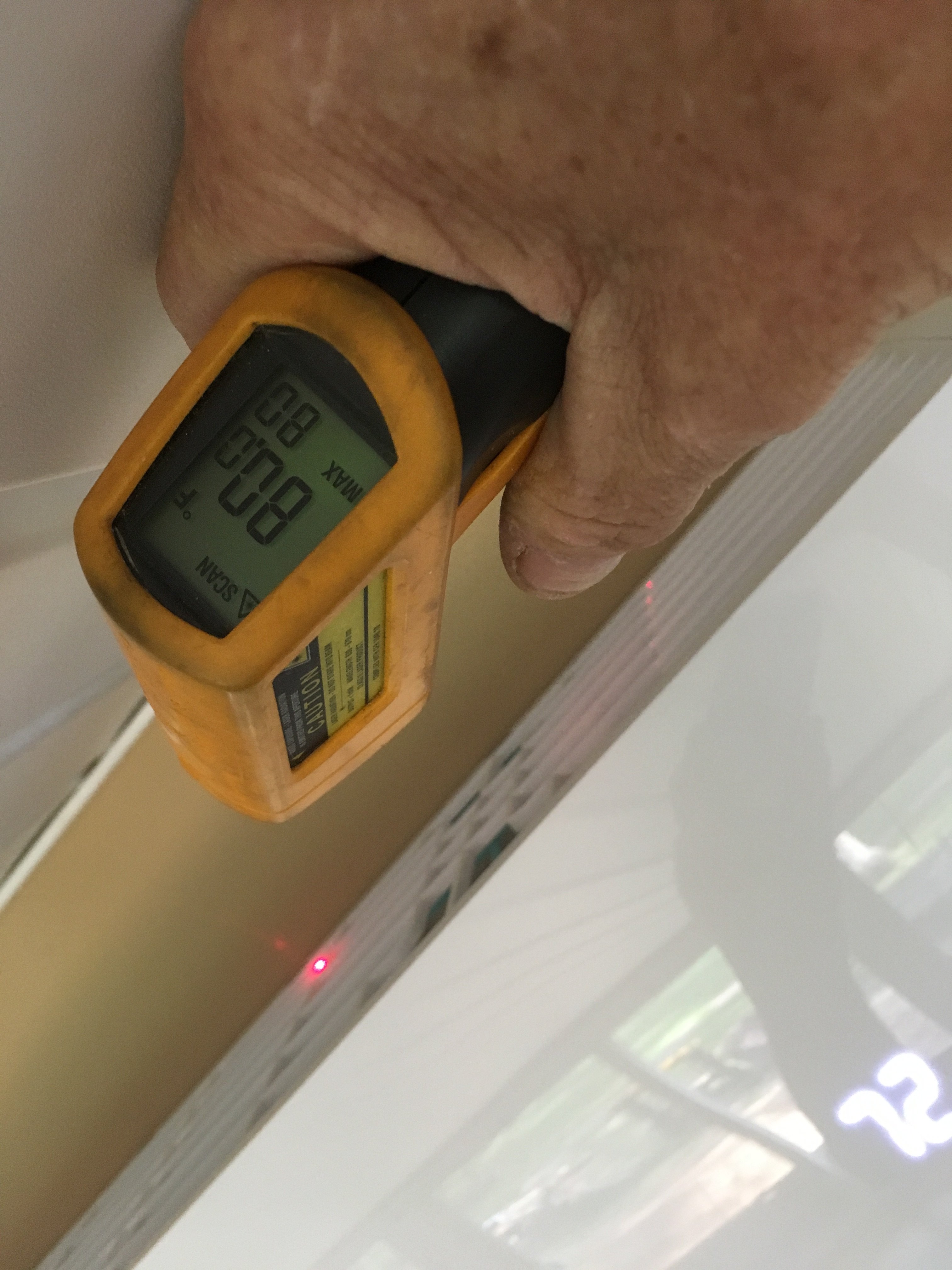

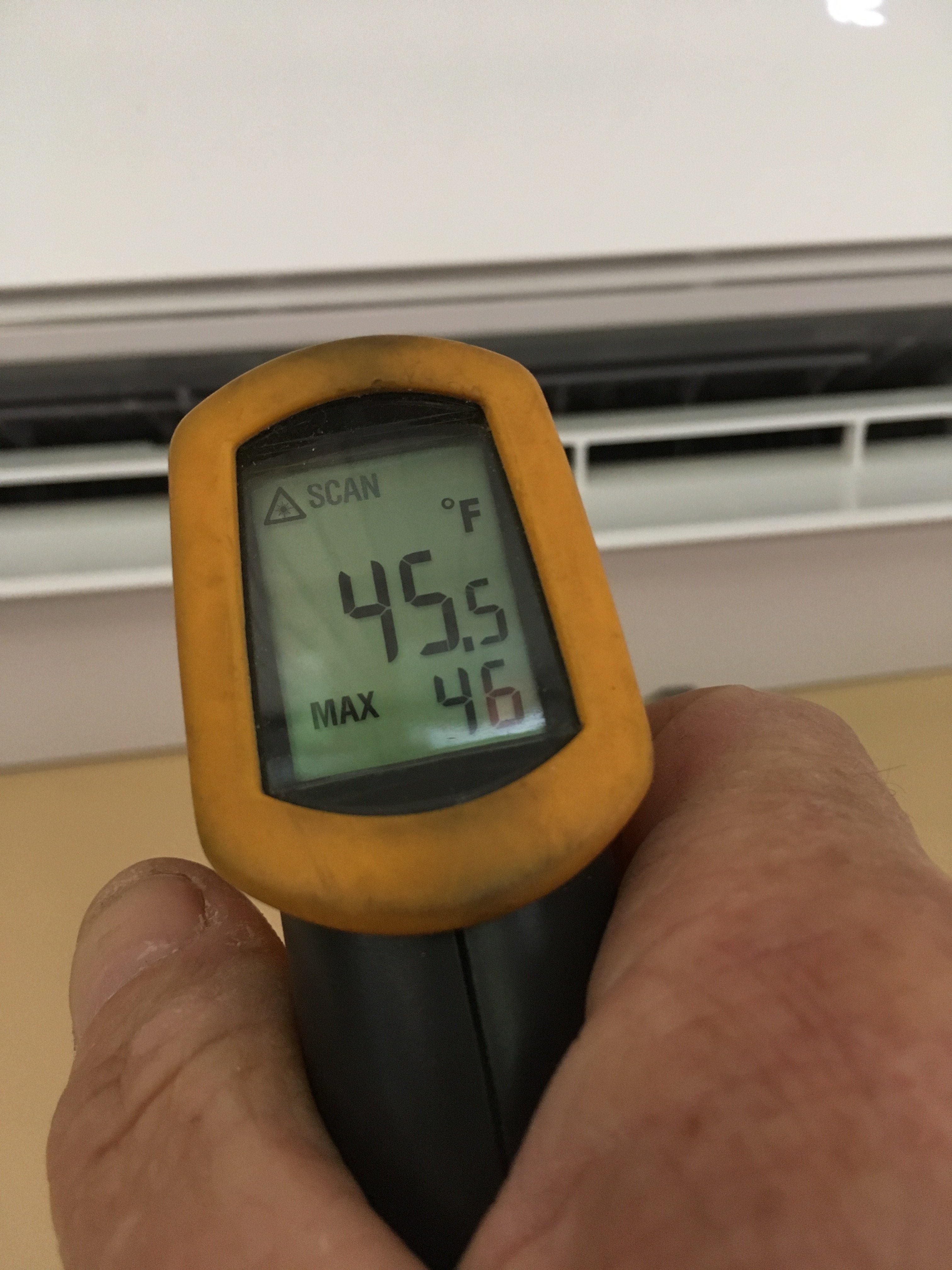

John Dirks Jr Posted June 15, 2019 Author Report Share Posted June 15, 2019 Temp drop across the evap after 5 mins of running. 80 in, 45 out Link to comment Share on other sites More sharing options...
Marc Posted June 15, 2019 Report Share Posted June 15, 2019 (edited) I've never seen a delta T that high...on any sort of AC system. Edited June 15, 2019 by Marc Link to comment Share on other sites More sharing options...
Jim Katen Posted June 15, 2019 Report Share Posted June 15, 2019 That thermometer is worthless for measuring air temperature. Get some probe thermometers for the real numbers. Link to comment Share on other sites More sharing options...
John Dirks Jr Posted June 15, 2019 Author Report Share Posted June 15, 2019 Jim, I think the thermometer is far from optimal, but not worthless. Marc, that is the widest spread I’ve ever gotten with that less than optimal thermometer. Link to comment Share on other sites More sharing options...
Bill Kibbel Posted June 15, 2019 Report Share Posted June 15, 2019 You're not measuring the temperature of the air with that - just surfaces. It is worthless. Link to comment Share on other sites More sharing options...
John Dirks Jr Posted June 16, 2019 Author Report Share Posted June 16, 2019 I know it’s surface temp on that tool. Although, the fireplace remote has a room temp display on it. It was reading 81 degrees 4’ off the floor. So the temp 8’ up the wall above the evap core can’t be lower than that. I can’t see the evap coil by looking through the louvre on the front of the unit. That 45 degree reading was off the edge of the blower wheel which is plastic. So I doubt the air temp at that point is much higher. Im not convinced that I’m substantially off the mark with those readings. But I could be wrong. Link to comment Share on other sites More sharing options...
Marc Posted June 16, 2019 Report Share Posted June 16, 2019 1 hour ago, John Dirks Jr said: I know it’s surface temp on that tool. Although, the fireplace remote has a room temp display on it. It was reading 81 degrees 4’ off the floor. So the temp 8’ up the wall above the evap core can’t be lower than that. I can’t see the evap coil by looking through the louvre on the front of the unit. That 45 degree reading was off the edge of the blower wheel which is plastic. So I doubt the air temp at that point is much higher. Im not convinced that I’m substantially off the mark with those readings. But I could be wrong. Get a mercury or thermocouple thermometer and check it. That huge delta T might be a result of sampling the evaporator coil temperature. What Jim and Bill said. Link to comment Share on other sites More sharing options...
John Dirks Jr Posted June 16, 2019 Author Report Share Posted June 16, 2019 I will get a proper tool for measuring air temp and do it again. But once more, the evap core is not visible through the front louvre. That 45 degree measurement is from the plastic blower wheel. Link to comment Share on other sites More sharing options...

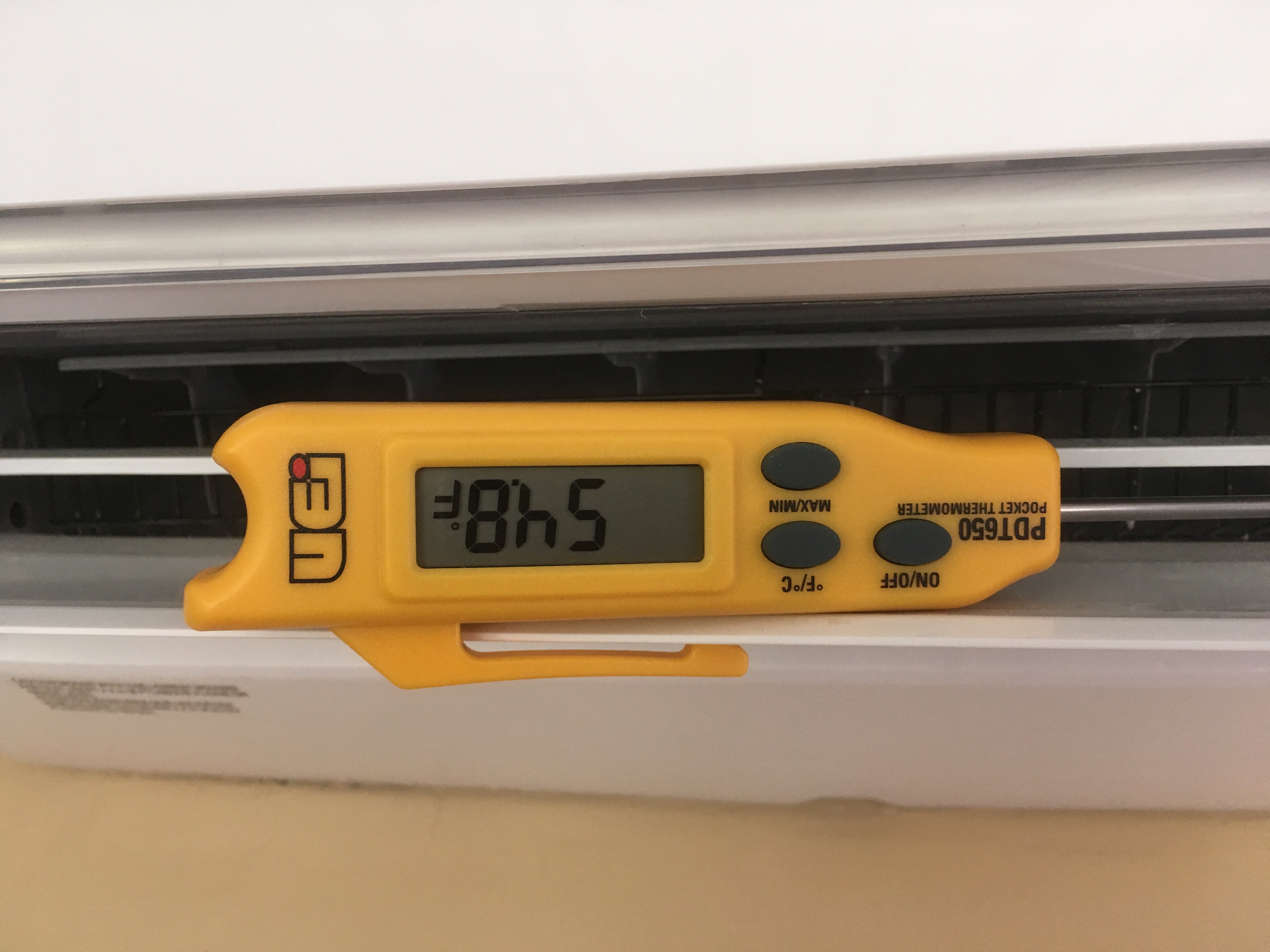

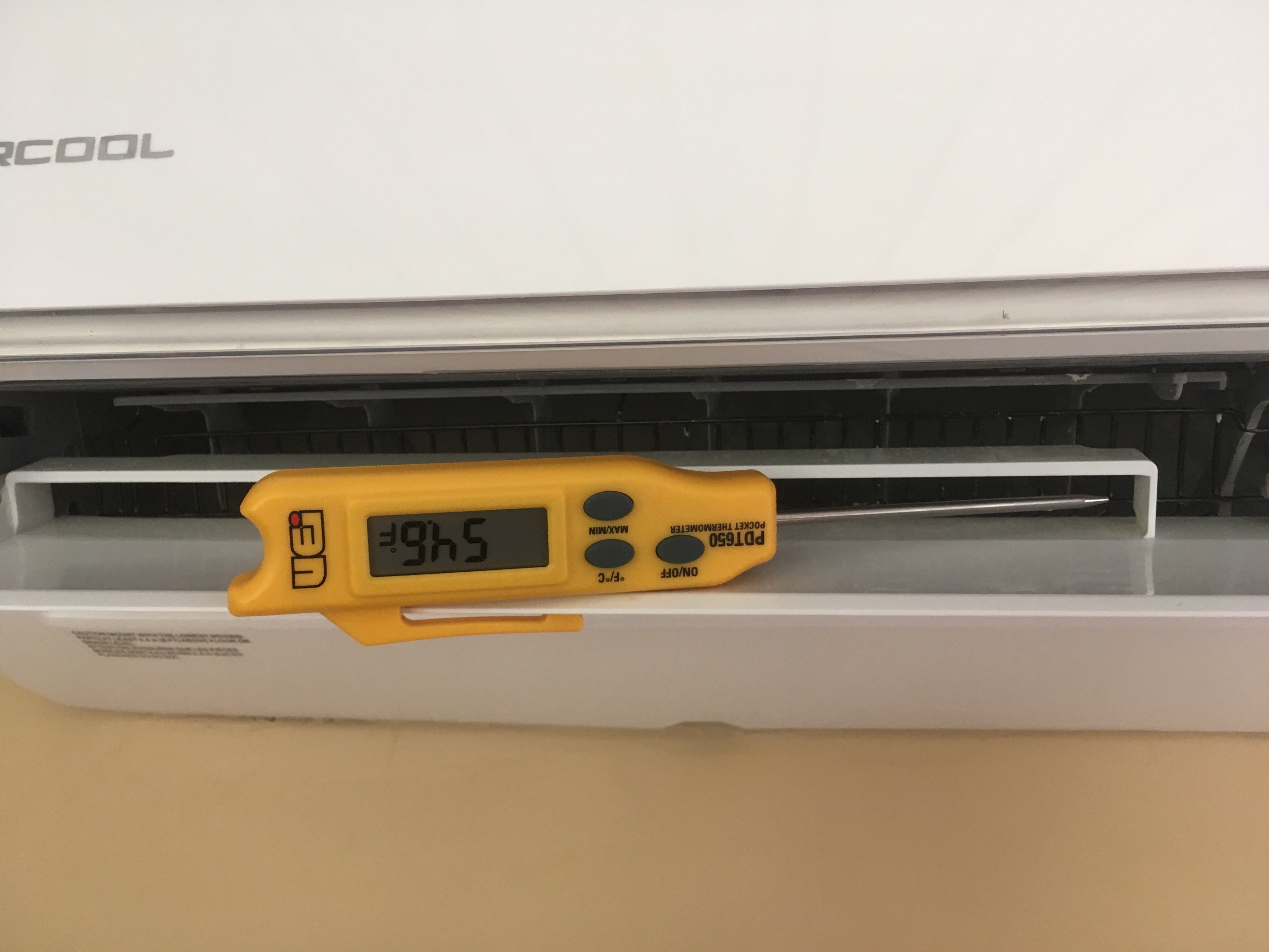

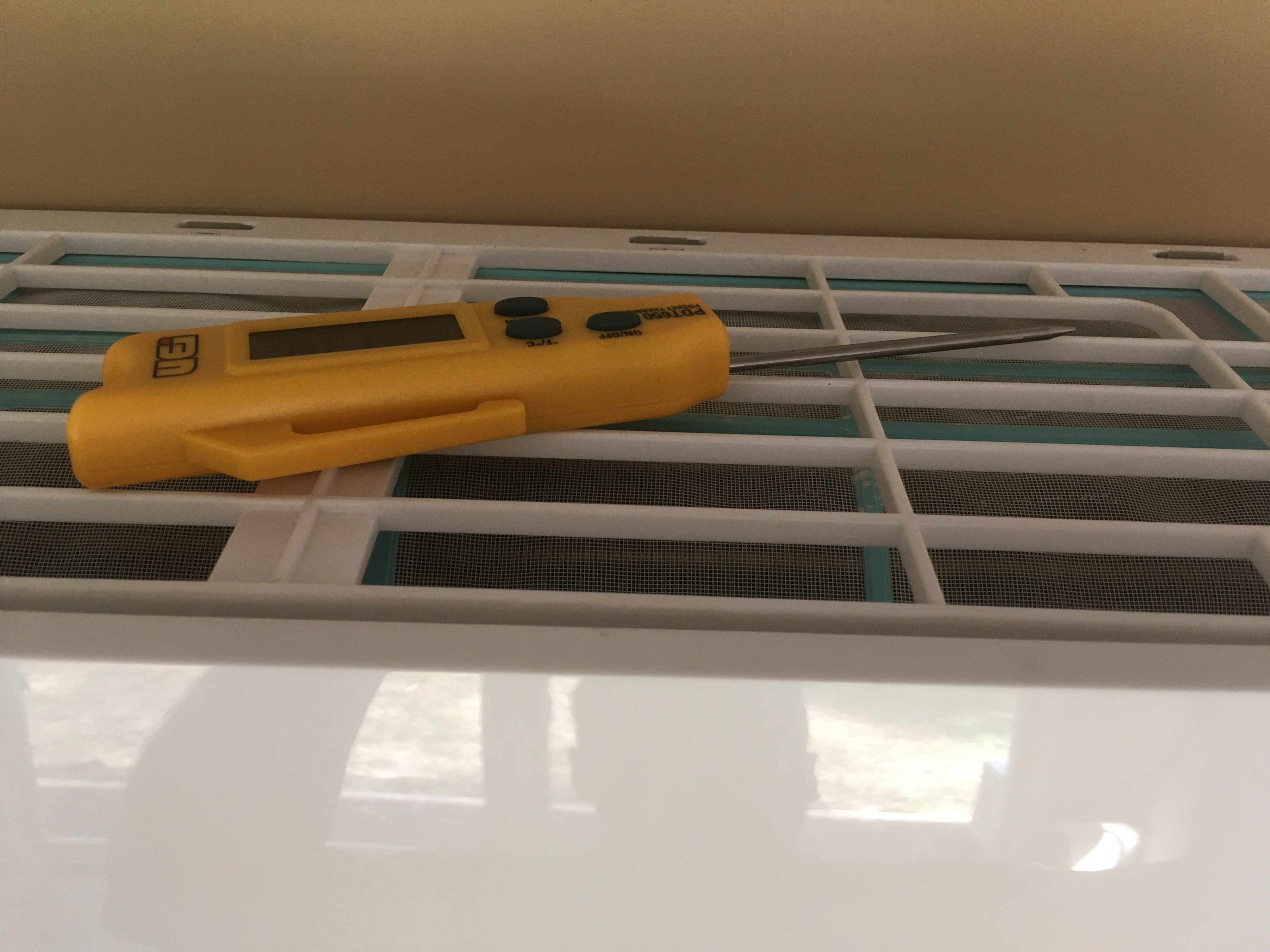

John Dirks Jr Posted June 25, 2019 Author Report Share Posted June 25, 2019 18 degree difference with this probe type thermometer. Link to comment Share on other sites More sharing options...
Jim Katen Posted June 25, 2019 Report Share Posted June 25, 2019 Do I get to say "I told you so"? BTW, I love UEI test equipment for cheap things like thermometers. It's hits the perfect point between being affordable and accurate enough for what we do. Plus, they have headquarters 30 minutes away from me. When I have a UEI device that breaks down, I walk into their shop with it and they fix it or replace it for me on the spot. Link to comment Share on other sites More sharing options...
John Dirks Jr Posted June 25, 2019 Author Report Share Posted June 25, 2019 Don’t count your chickens just yet Jim. But maybe you can say “I told you so”. We will see but It’s been 10 days since the system was charged. I just tested with this tool today and the system may still have a leak. It might be partially leaked out. It’s still cooling satisfactorily as of now. I’m not gonna mess with it for now. But if it has to get charged again, I will test temps immediately after such. At that point I may be due a full bore “told you so” This thing has variable operating modes depending on conditions so it’s not really easy tell exactly what it’s doing at a given time point. . Not like the standard systems that are either on, or off. Link to comment Share on other sites More sharing options...
Marc Posted June 26, 2019 Report Share Posted June 26, 2019 Since it has no ducts, I'd expect more than 18 degrees differential, unless the condensation flow rate was high. Link to comment Share on other sites More sharing options...
Jim Katen Posted June 26, 2019 Report Share Posted June 26, 2019 7 hours ago, John Dirks Jr said: This thing has variable operating modes depending on conditions so it’s not really easy tell exactly what it’s doing at a given time point. . Not like the standard systems that are either on, or off. With incoming air at 72 degrees dry bulb, and output air at 55 degree dry bulb, that would be a perfect temperature differential if the incoming air was at 62 degrees wet bulb - which I imagine is just about right for Maryland in June. You don't want much more aggressive cooling or you risk poor humidity control. Link to comment Share on other sites More sharing options...
