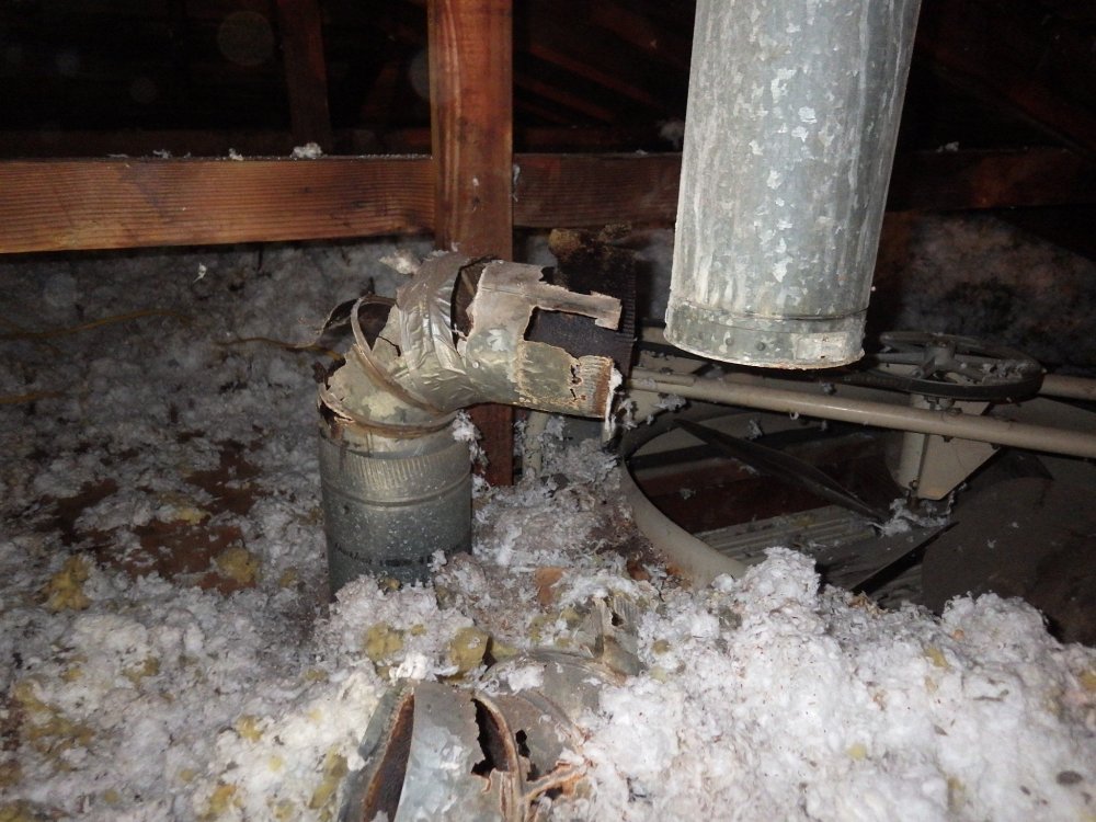

Mark P Posted March 16, 2019 Report Posted March 16, 2019 Sometimes it pays off to crawl through a shallow attic to the other end.

Hubert Miles Posted March 19, 2019 Report Posted March 19, 2019 Great find but be careful. The liability of putting your foot through a ceiling may far outweigh the inspection fee you are charging.
Mark P Posted March 21, 2019 Author Report Posted March 21, 2019 On 3/18/2019 at 8:36 PM, Hubert Miles said: Great find but be careful. The liability of putting your foot through a ceiling may far outweigh the inspection fee you are charging. No to sound like a smart ass, but the liability of not reporting the furnace / water heater exhausting into the attic far outweighs some drywall damage. People die from leaking furnace exhaust. Besides, I'm always careful.
Erby Posted March 28, 2019 Report Posted March 28, 2019 And right next to a big opening where the combustion gases can sink into the living area, though I'd bet they rise a bit until they cool off.
