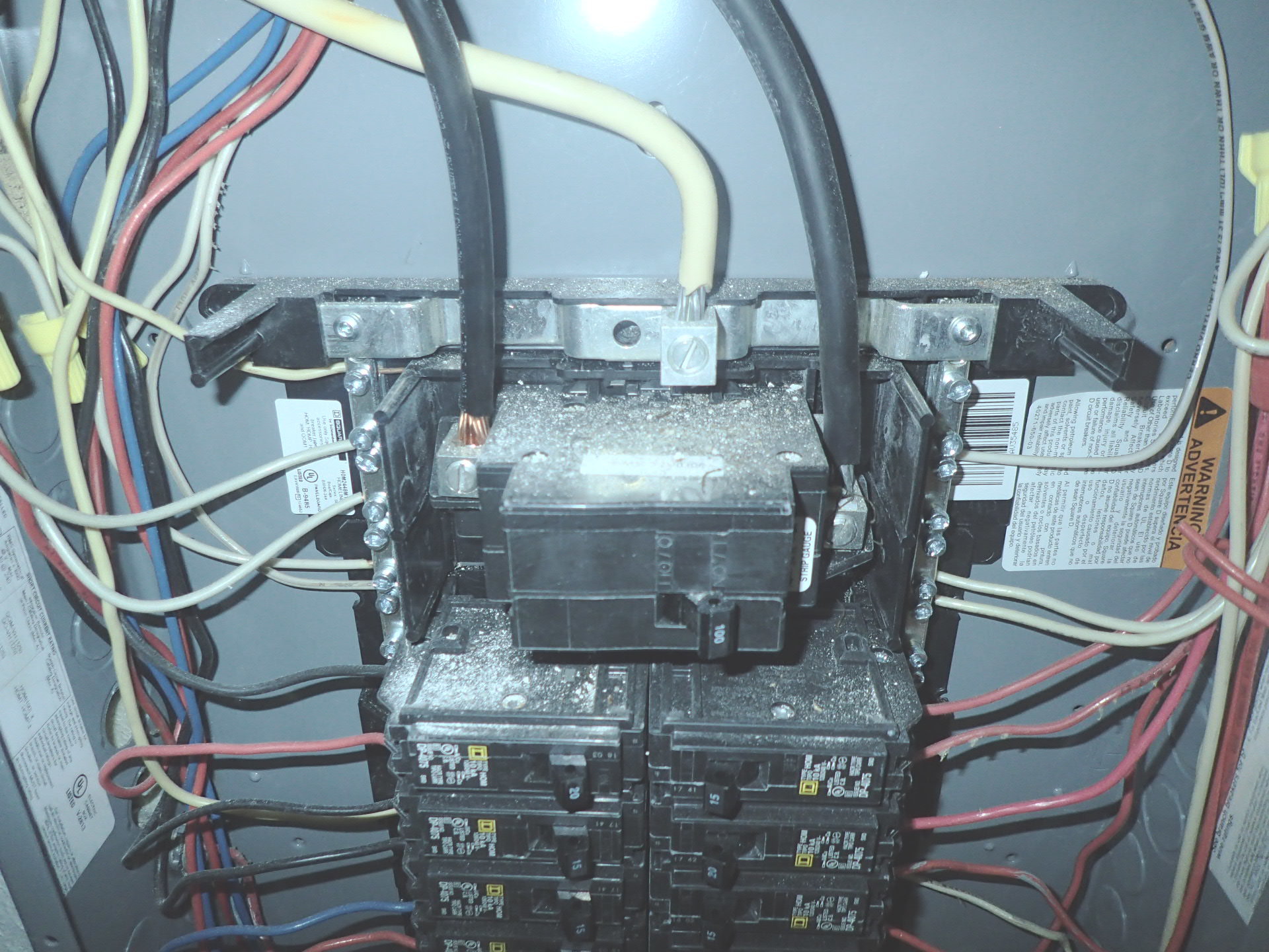

Mike Lamb Posted August 22, 2018 Report Share Posted August 22, 2018 Is there any prohibition of mixing copper and aluminum for the SEC hots? Link to comment Share on other sites More sharing options...
Marc Posted August 22, 2018 Report Share Posted August 22, 2018 I don't see how it could be a problem, assuming all connectors and devices are listed for it. Link to comment Share on other sites More sharing options...
Erby Posted August 27, 2018 Report Share Posted August 27, 2018 I agree with Marc. Link to comment Share on other sites More sharing options...
John Kogel Posted August 27, 2018 Report Share Posted August 27, 2018 (edited) Right, just never under the same screw, in a case where 2 conductors are allowed. The Al conductor needs to be the correct gauge, usually one size larger than the corresponding Cu. Edited August 27, 2018 by John Kogel Link to comment Share on other sites More sharing options...
ejager Posted October 9, 2018 Report Share Posted October 9, 2018 I understood anti-oxidizing paste to be a requirement, but that could be just a Canadian thing. Link to comment Share on other sites More sharing options...
Jim Katen Posted October 10, 2018 Report Share Posted October 10, 2018 10 hours ago, ejager said: I understood anti-oxidizing paste to be a requirement, but that could be just a Canadian thing. It's not a requirement of the NEC unless the wire manufacturer or the panel manufacturer require it. Link to comment Share on other sites More sharing options...
