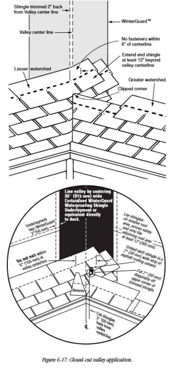

Marc Posted April 22, 2018 Report Posted April 22, 2018 (edited) A client changed their roof cover based mostly on a long term leak on an asymmetrical roof valley (bottom half is 12/12 on one side, 4/12 on the other. Top half is 12/12 on both sides). I specified a prefabbed copper flashing at the junction between the upper and lower halves because that point has three dimensions (flat flashing can't be bent to fit). Two months later, it's leaking again. Is anyone aware of any guidelines for flashing an asymmetrical valley? Thanks. Edited April 22, 2018 by Marc

Jim Katen Posted April 23, 2018 Report Posted April 23, 2018 If it has a closed-cut valley, the steeper side should overlap the shallower side.
Marc Posted April 23, 2018 Author Report Posted April 23, 2018 7 hours ago, Jim Katen said: If it has a closed-cut valley, the steeper side should overlap the shallower side. On the top half, where the two pitches are the same, the higher roof surface overlaps the lower one. On the bottom half, the higher pitch overlaps the lower pitch. That means the lap reverses sides midway up the valley, at the point where it changes direction. I'll take photos when I meet with the homeowner and contractor.
Chad Fabry Posted April 23, 2018 Report Posted April 23, 2018 Did you clip the tops of the top shingles at 45 degrees?
Marc Posted April 23, 2018 Author Report Posted April 23, 2018 He didn't. Why is that important? Never heard of it before.
Leighton Jantz Posted April 23, 2018 Report Posted April 23, 2018 (edited) The 45 at the top of shingle reduces the chance of of runoff from opposing roof from running along top edge of shingle, and past metal flashing. This is most commonly done with an open valley though. Edited April 23, 2018 by Leighton Jantz
Marc Posted April 23, 2018 Author Report Posted April 23, 2018 (edited) That's good to know. According to Chad's drawing, it's done for closed valleys also. Roofer is arriving tomorrow to talk then leaving for Mexico for three months, so we'll see if he's going to do something. Edited April 23, 2018 by Marc
Chad Fabry Posted April 24, 2018 Report Posted April 24, 2018 Over 40 years ago, the first roof I installed leaked buckets at the closed cut valleys. It fixed it completely when I clipped the tops (like the shingle bundle instructions told me to)
Marc Posted April 24, 2018 Author Report Posted April 24, 2018 Looks like I have my ammo for tomorrow. Thanks guys.
