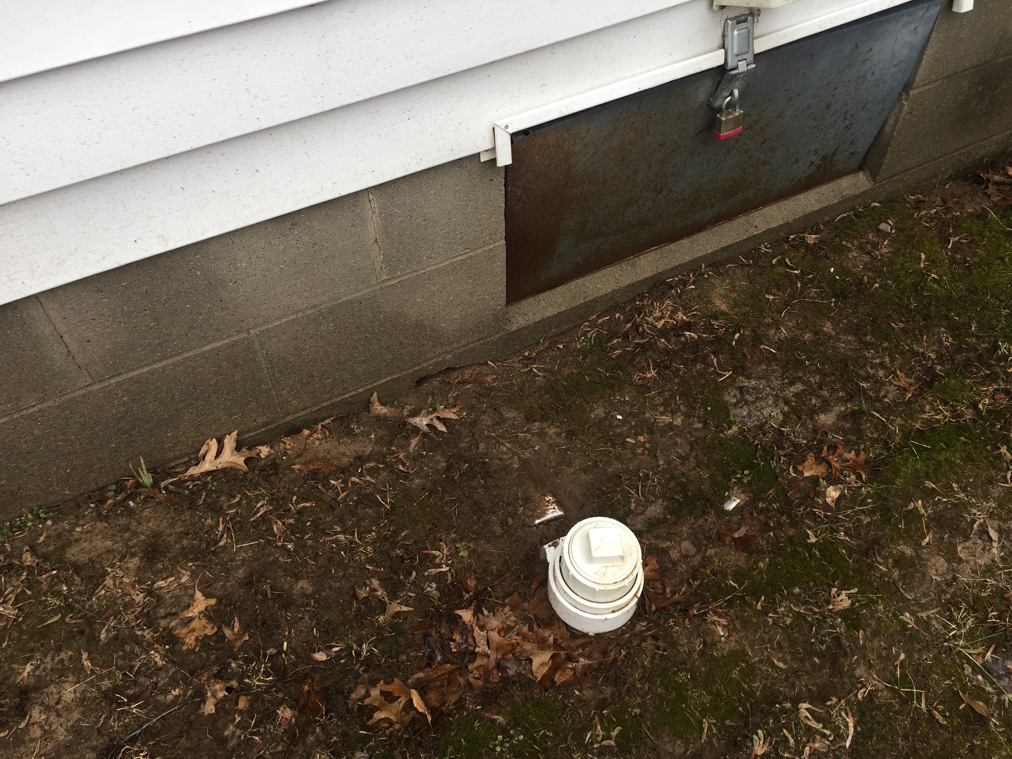

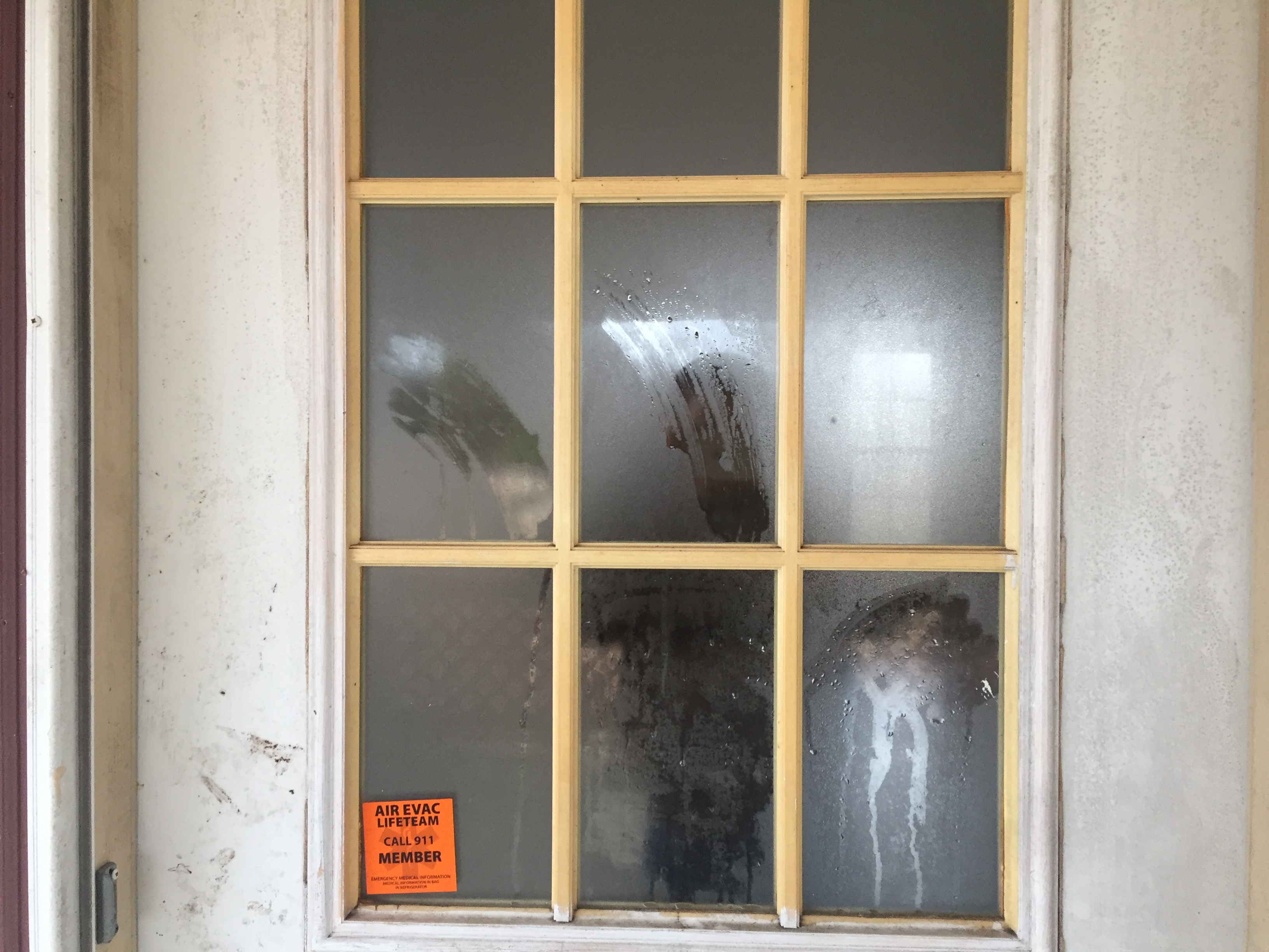

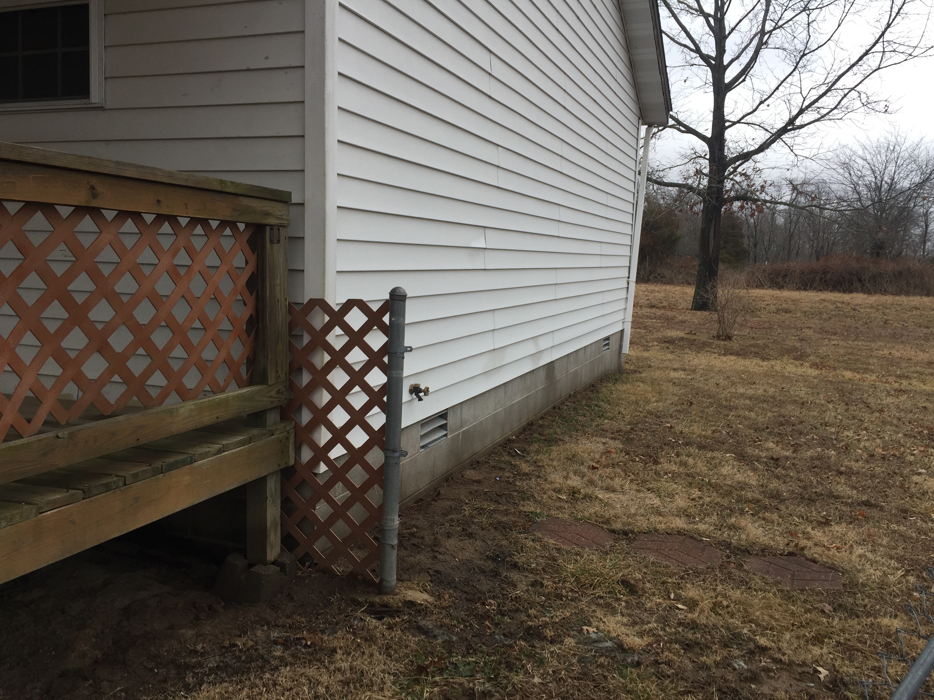

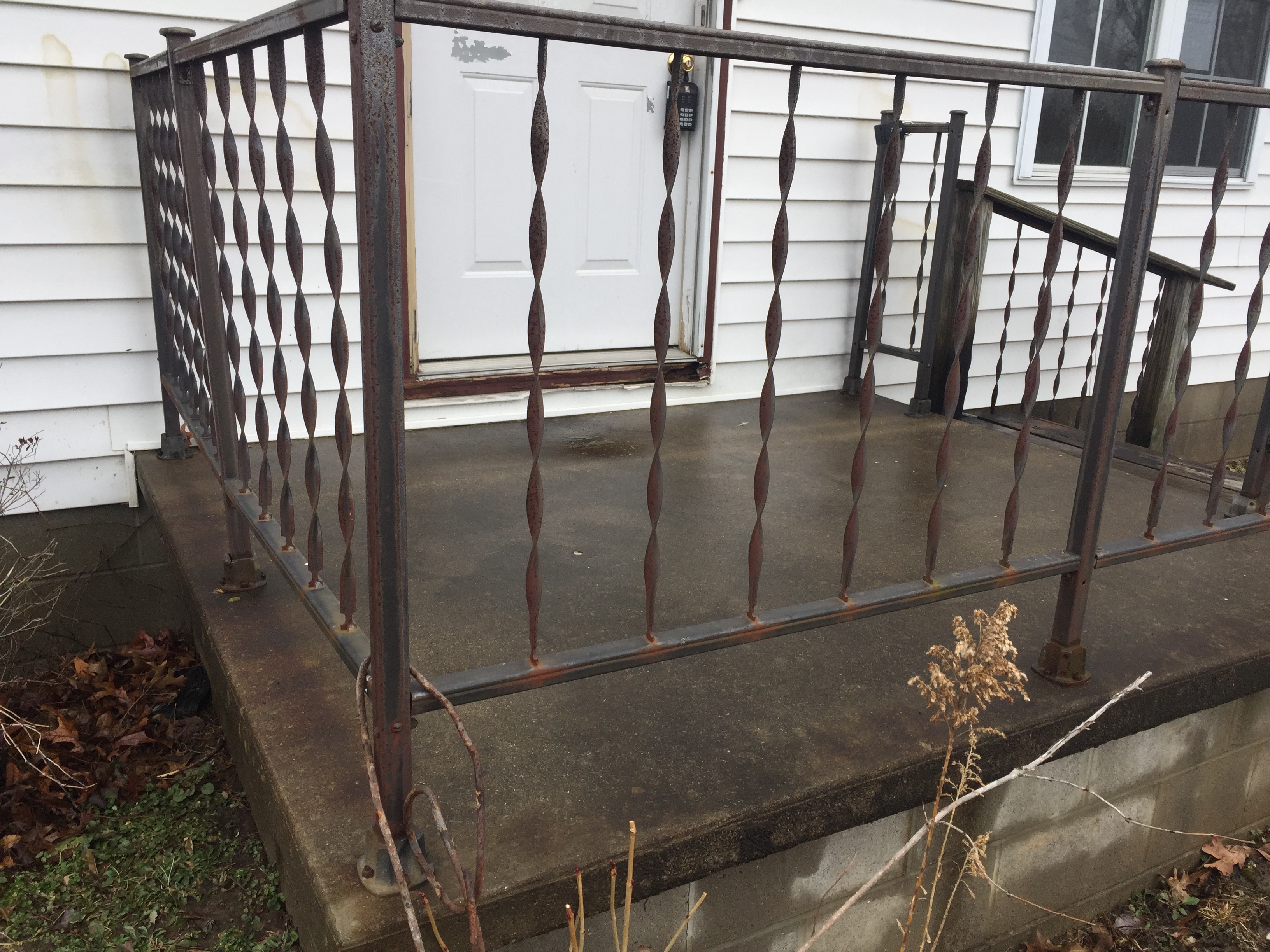

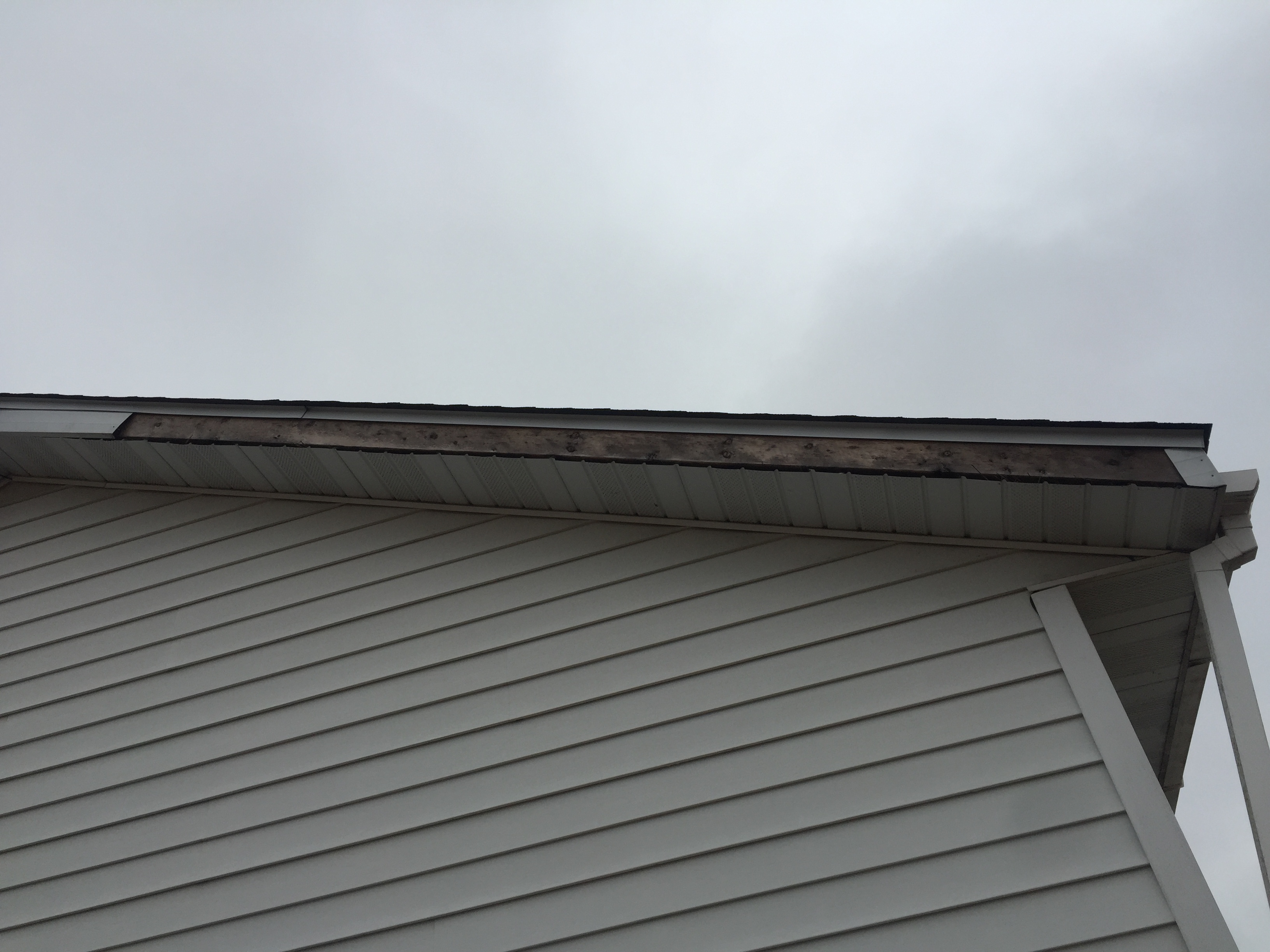

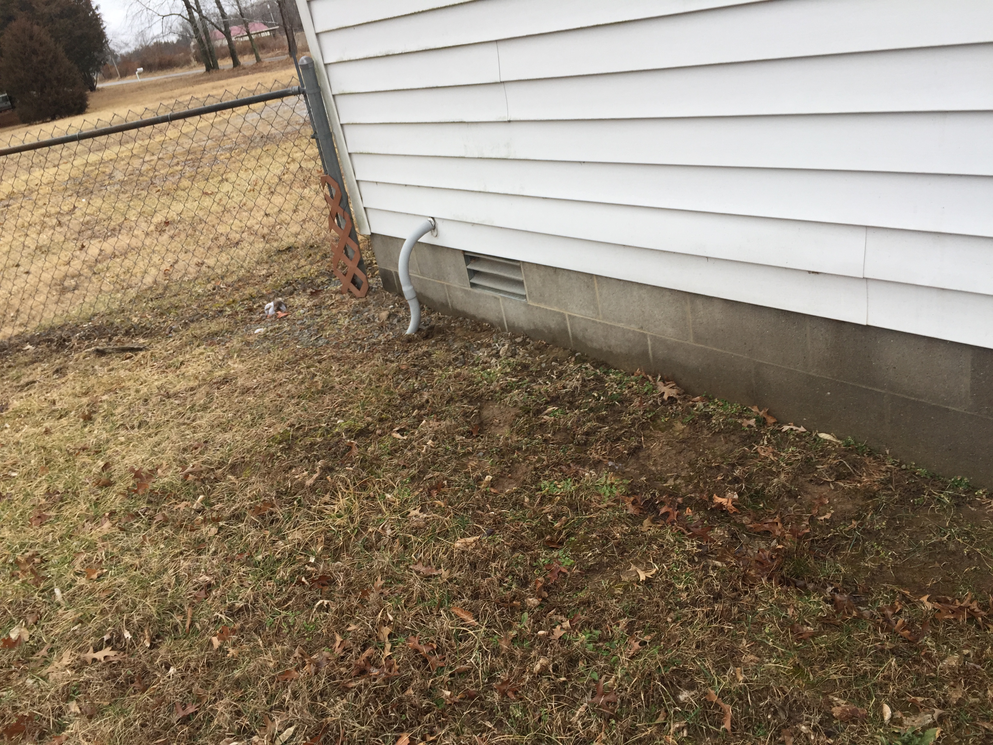

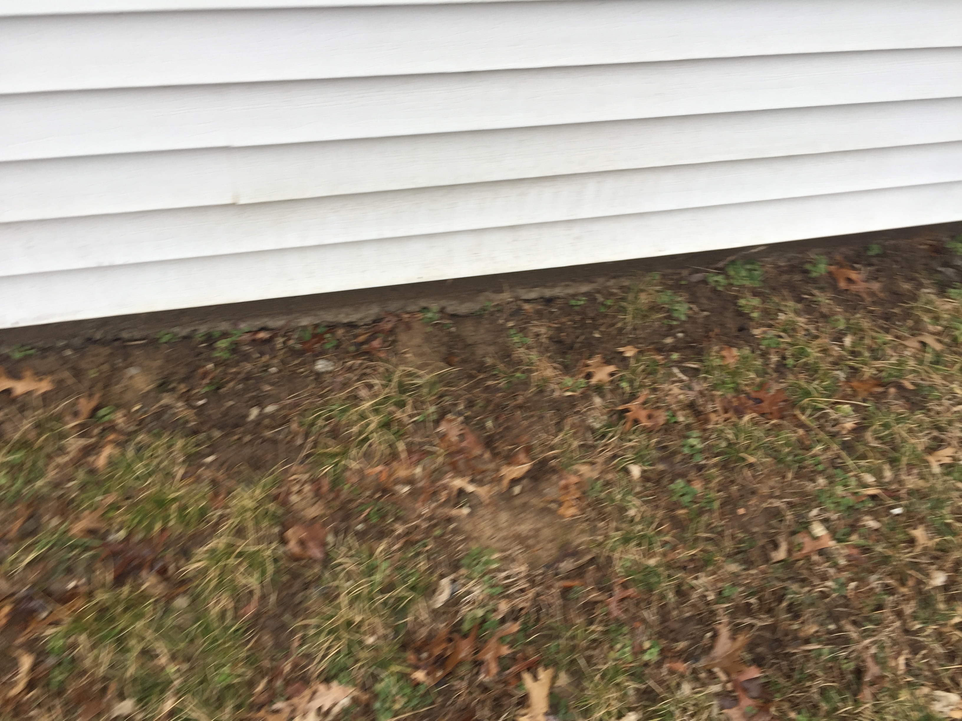

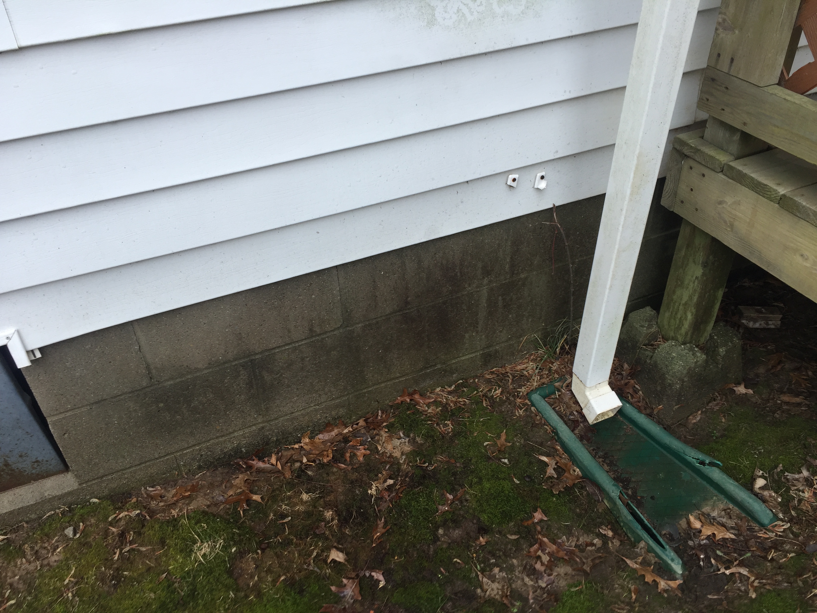

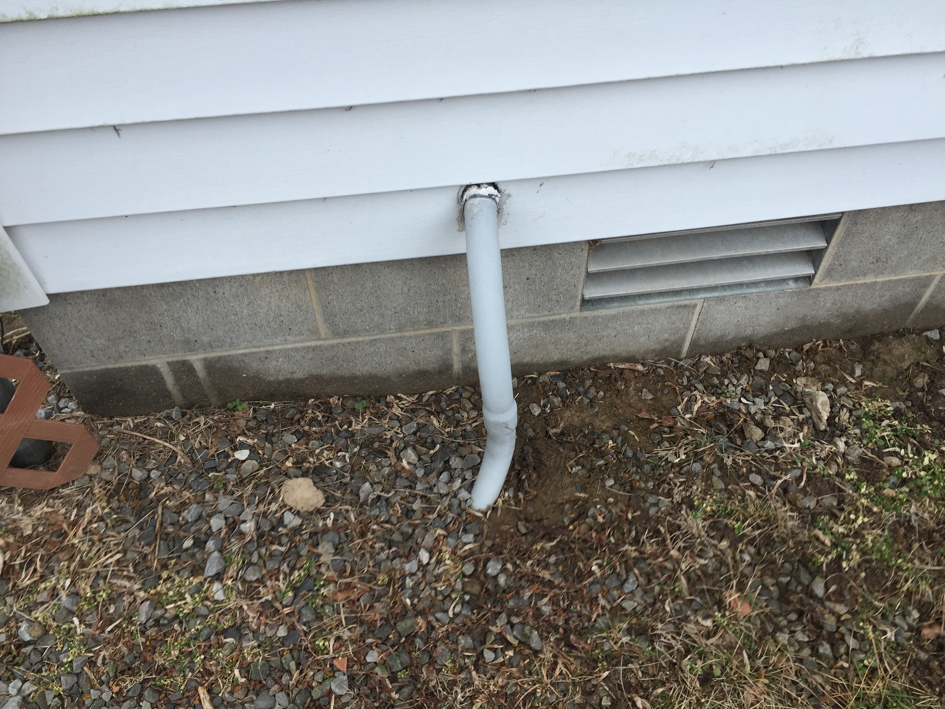

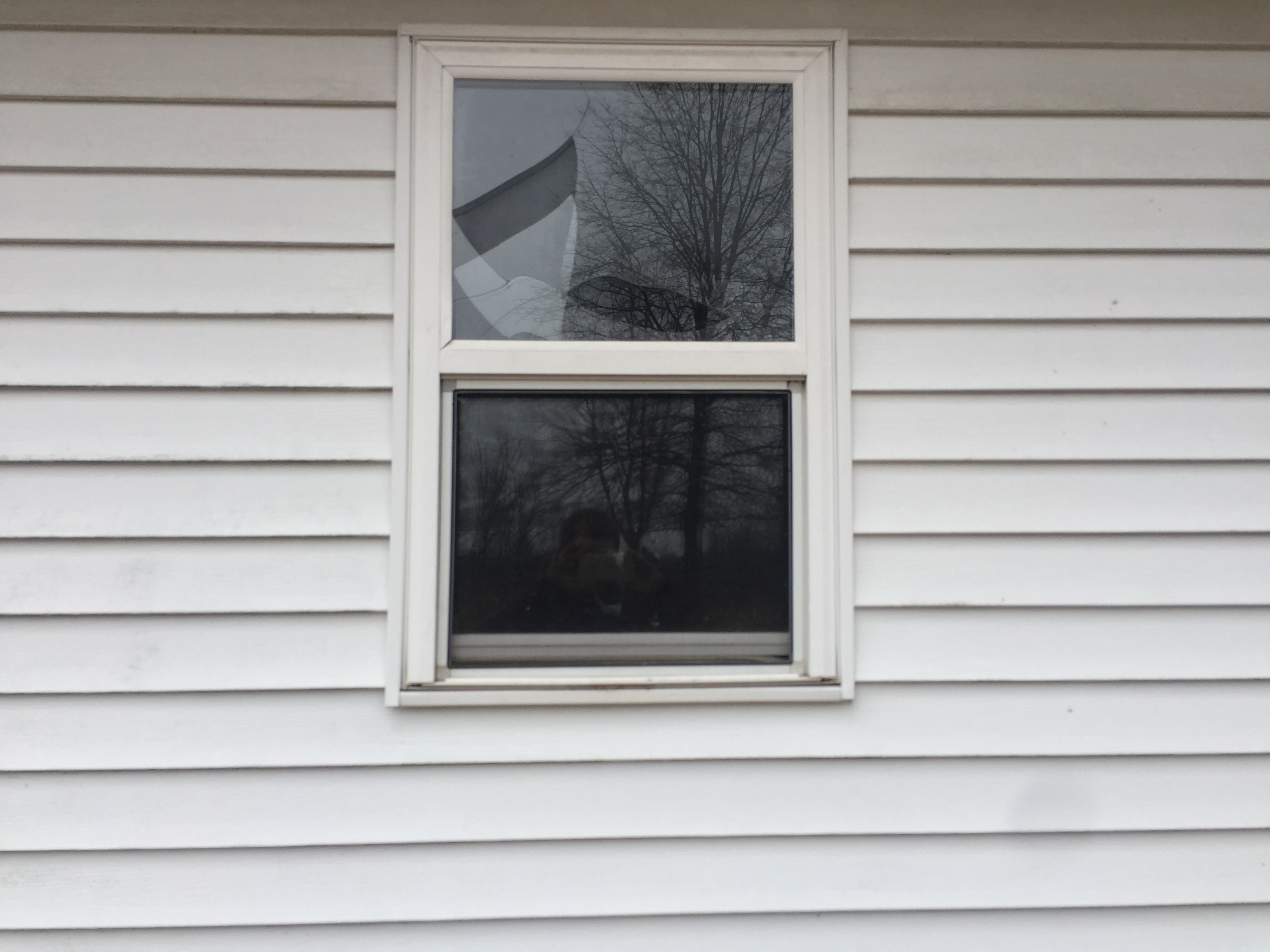

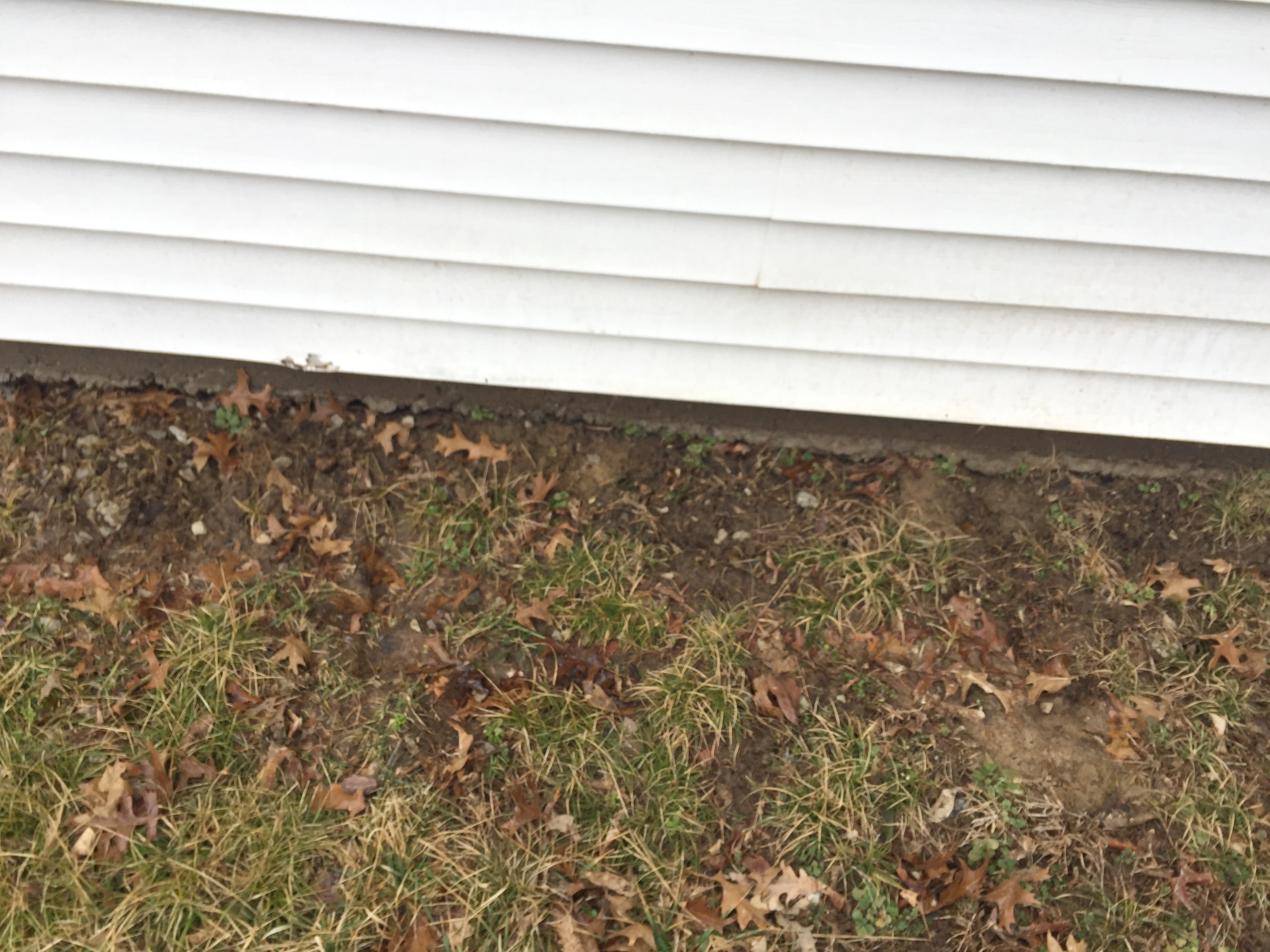

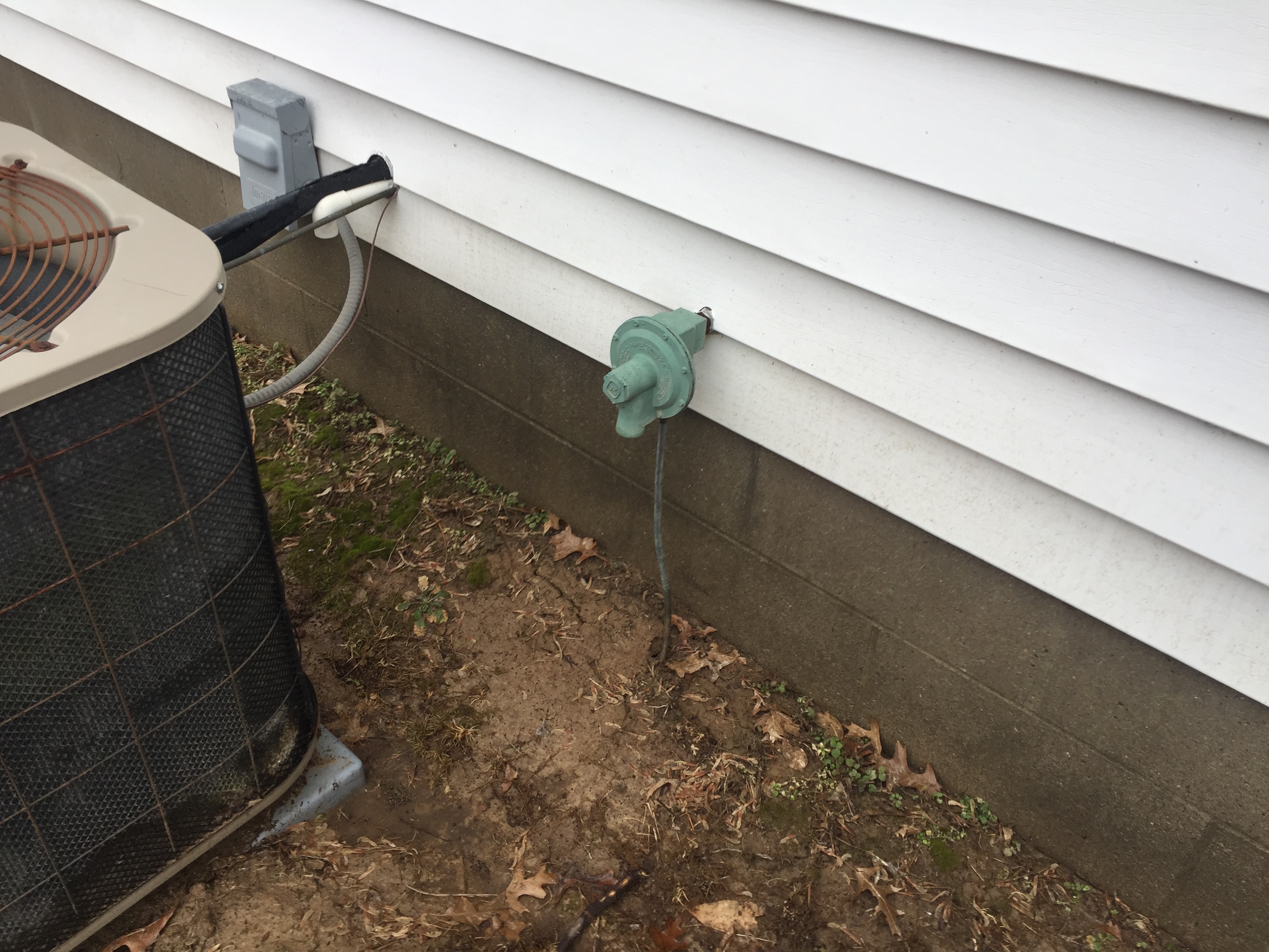

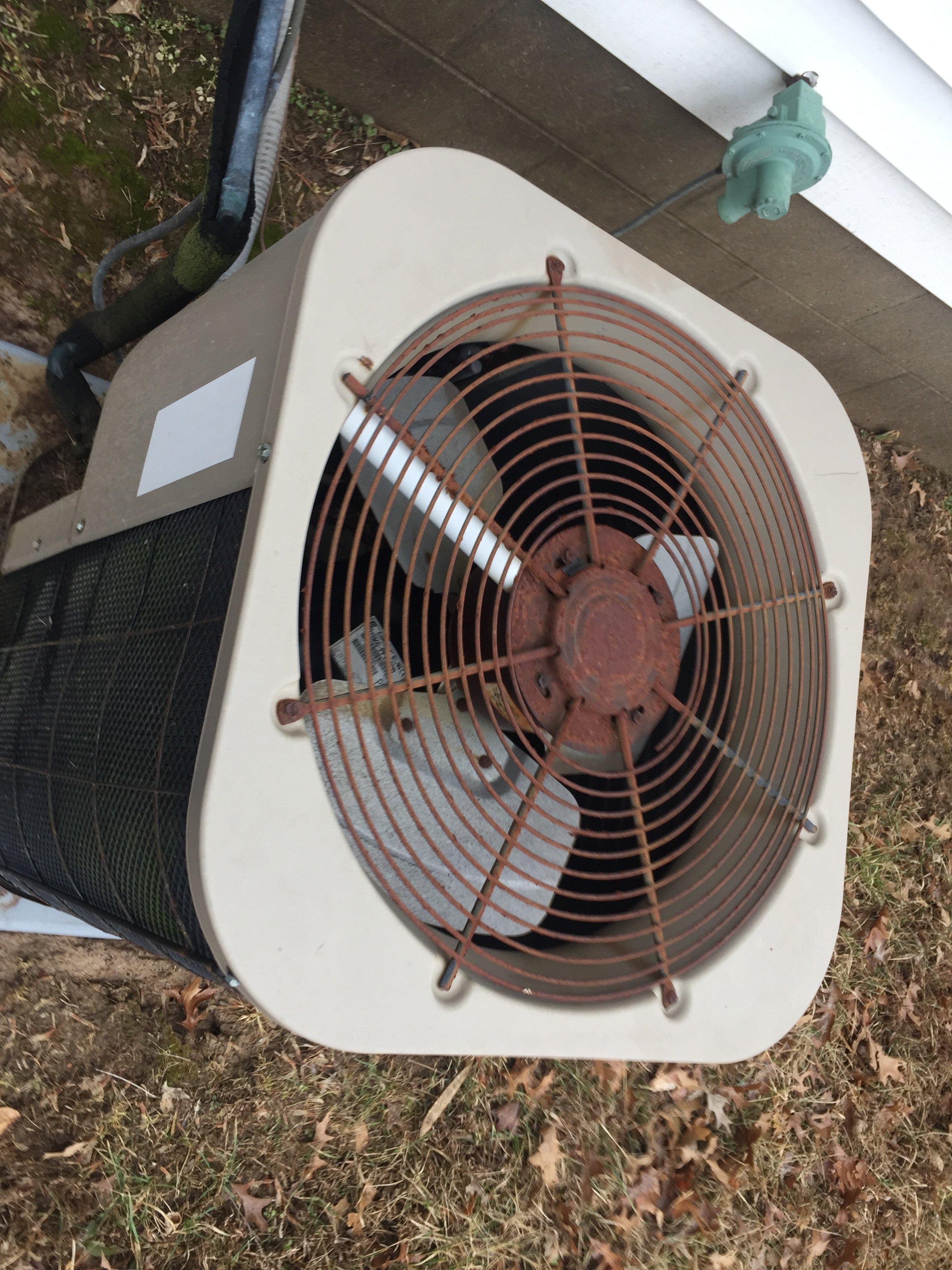

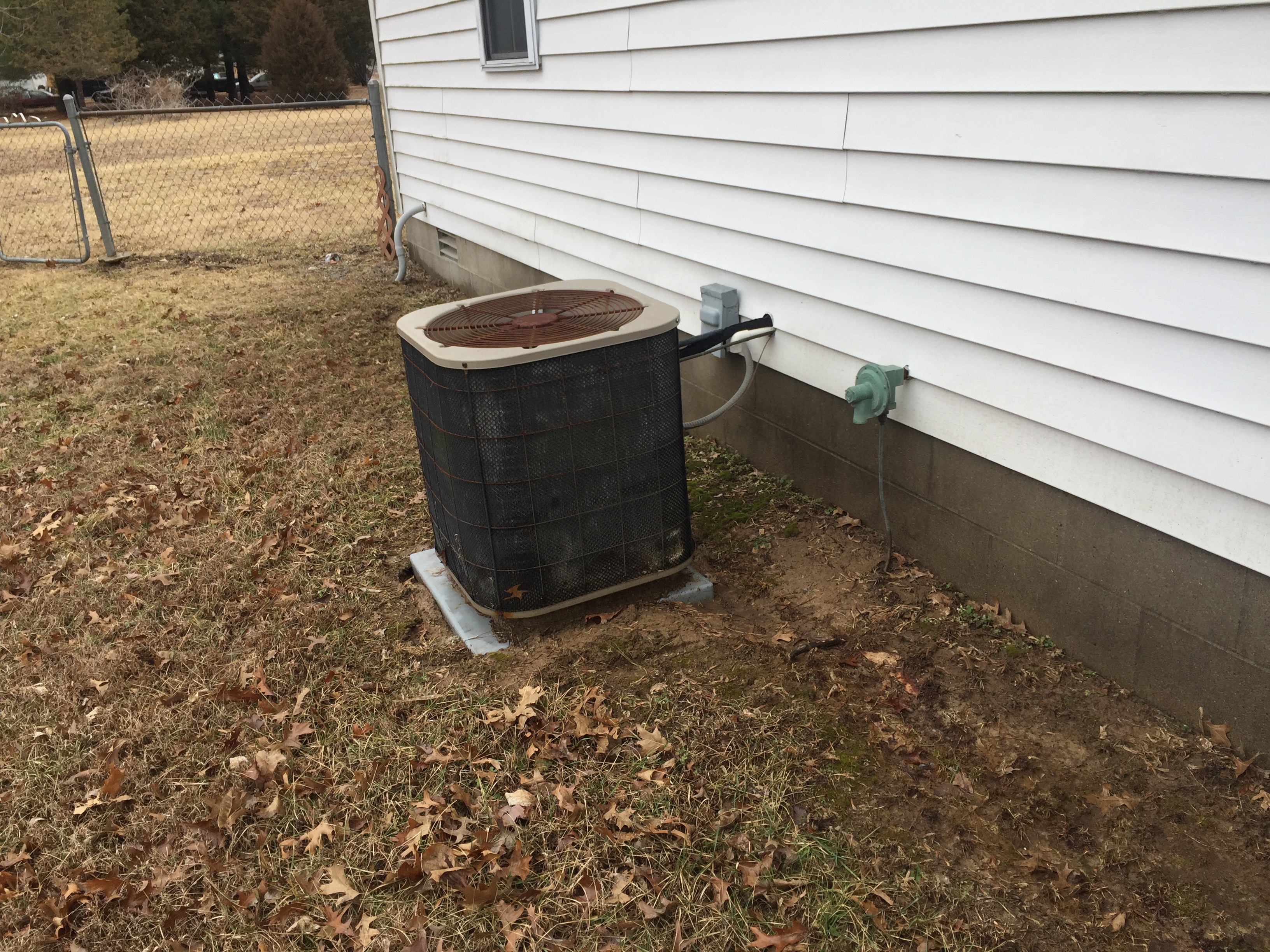

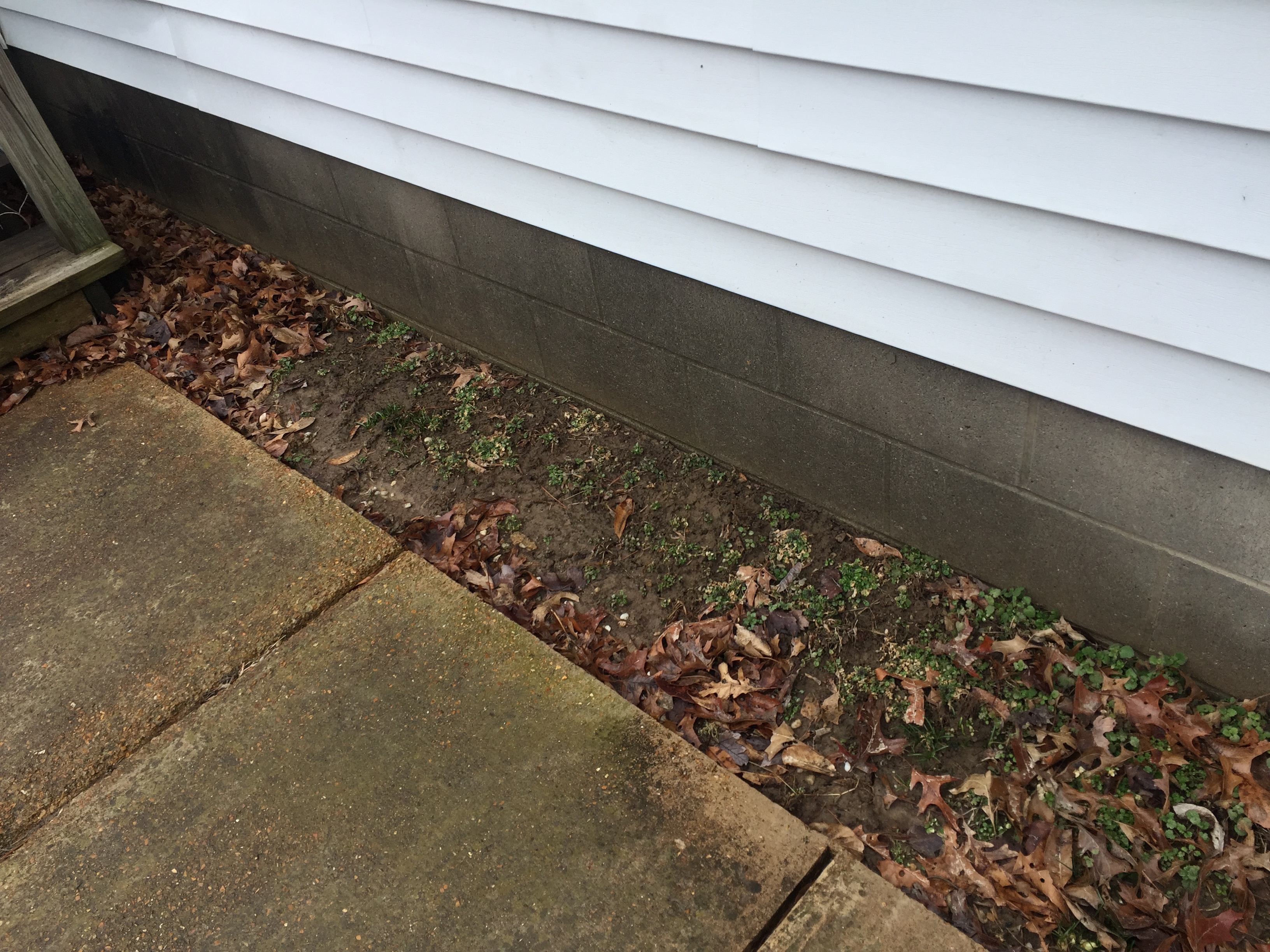

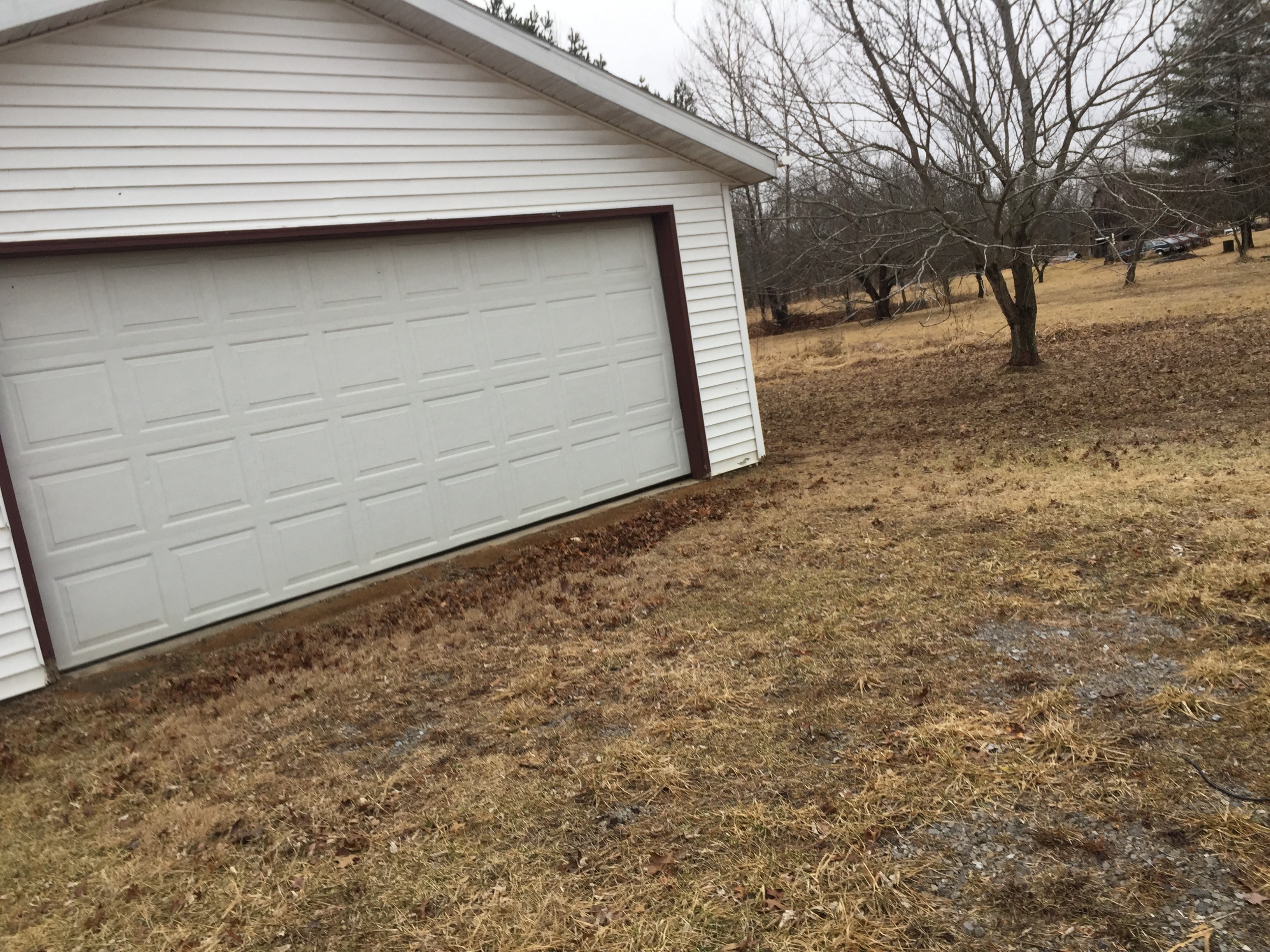

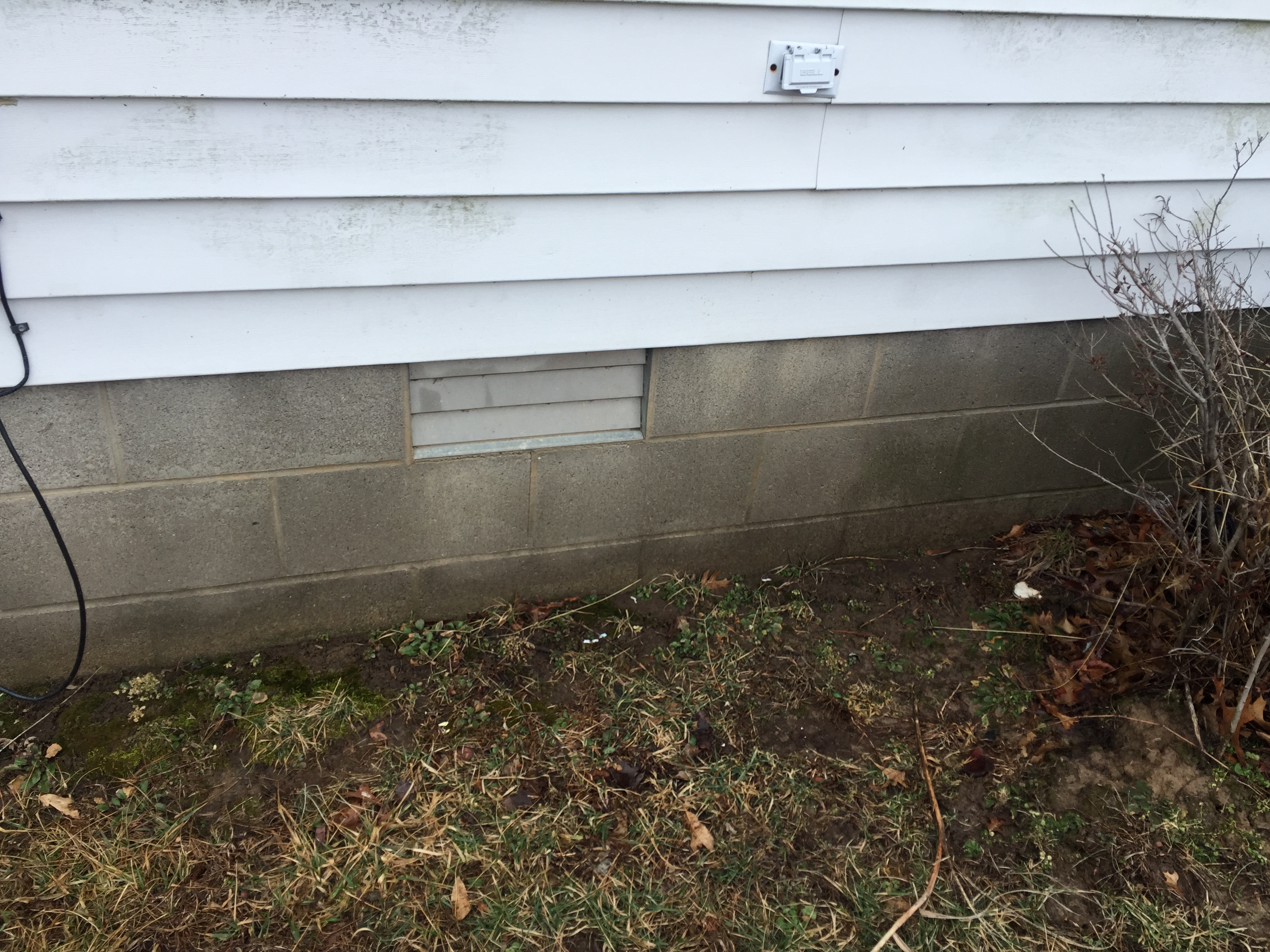

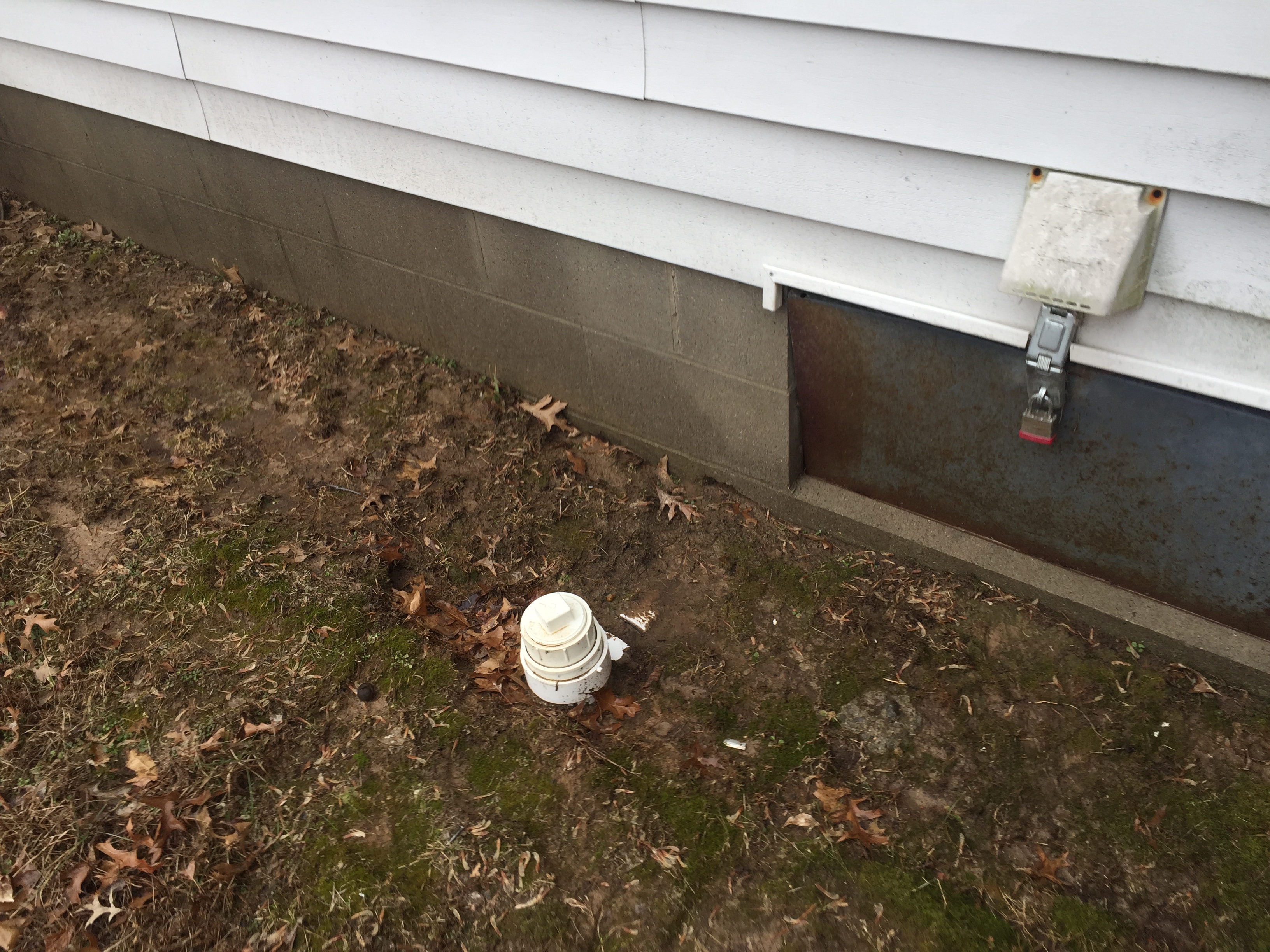

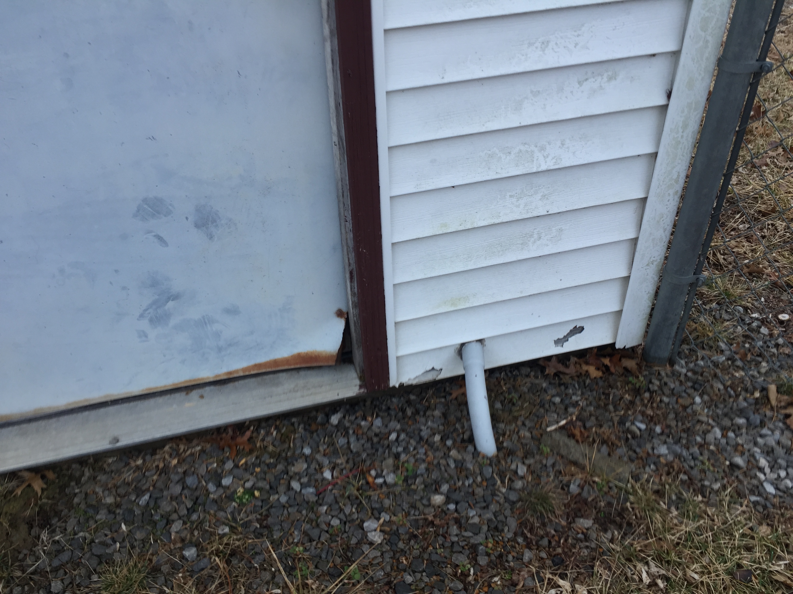

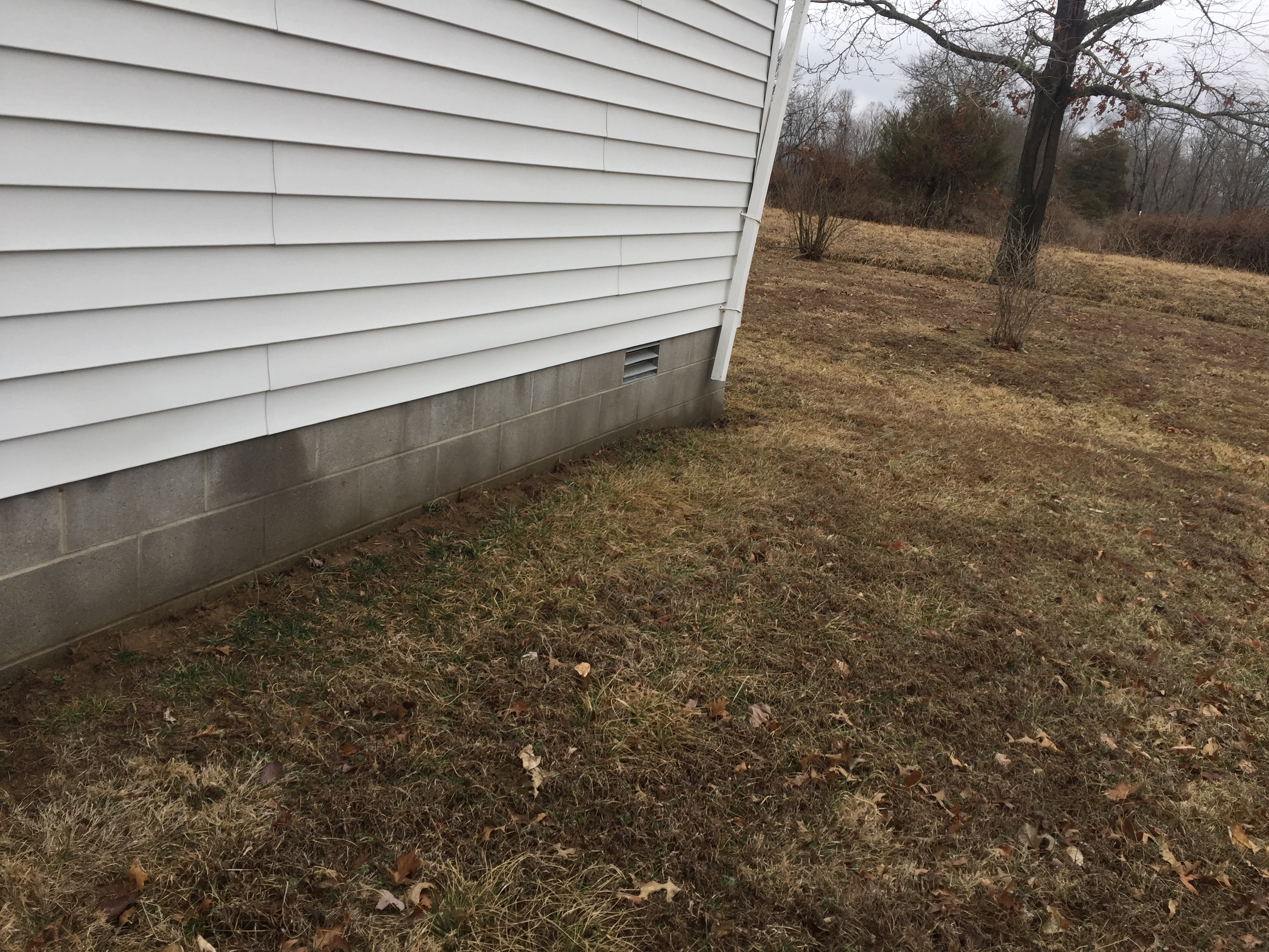

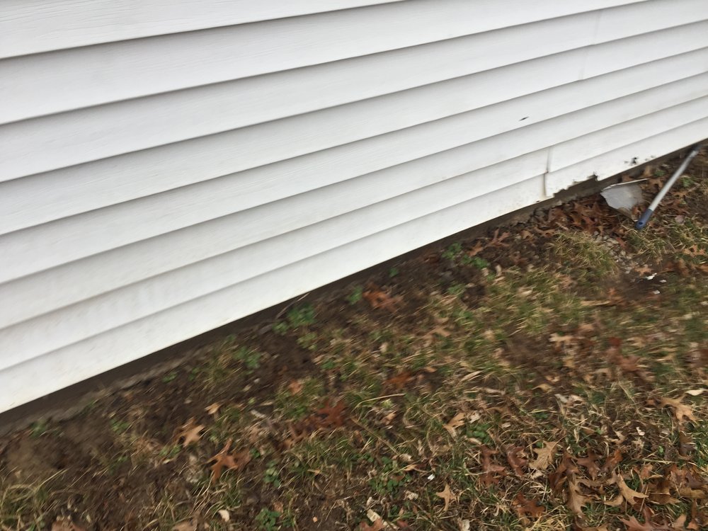

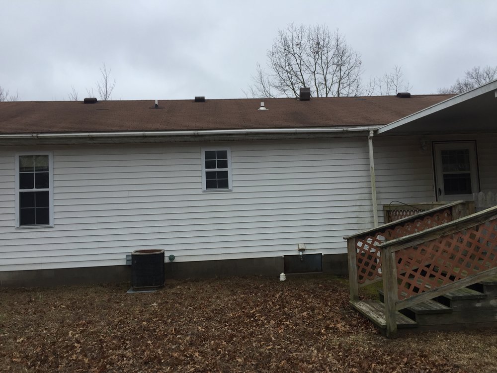

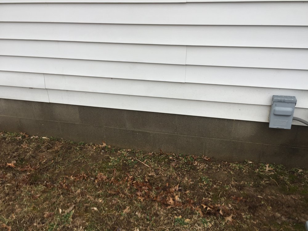

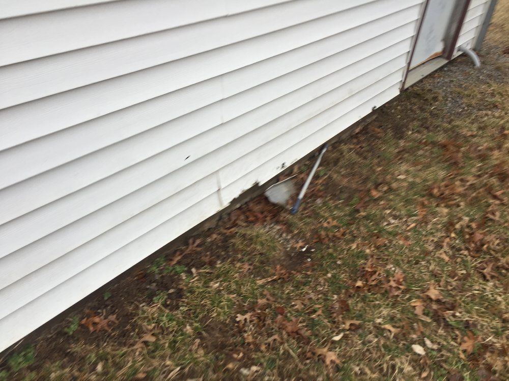

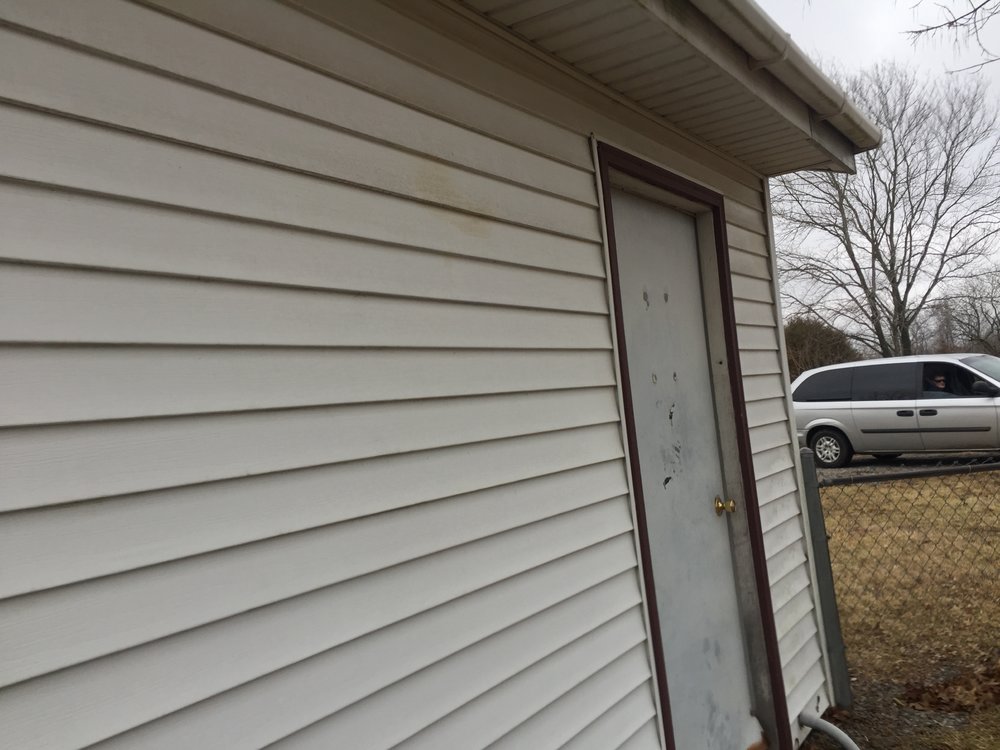

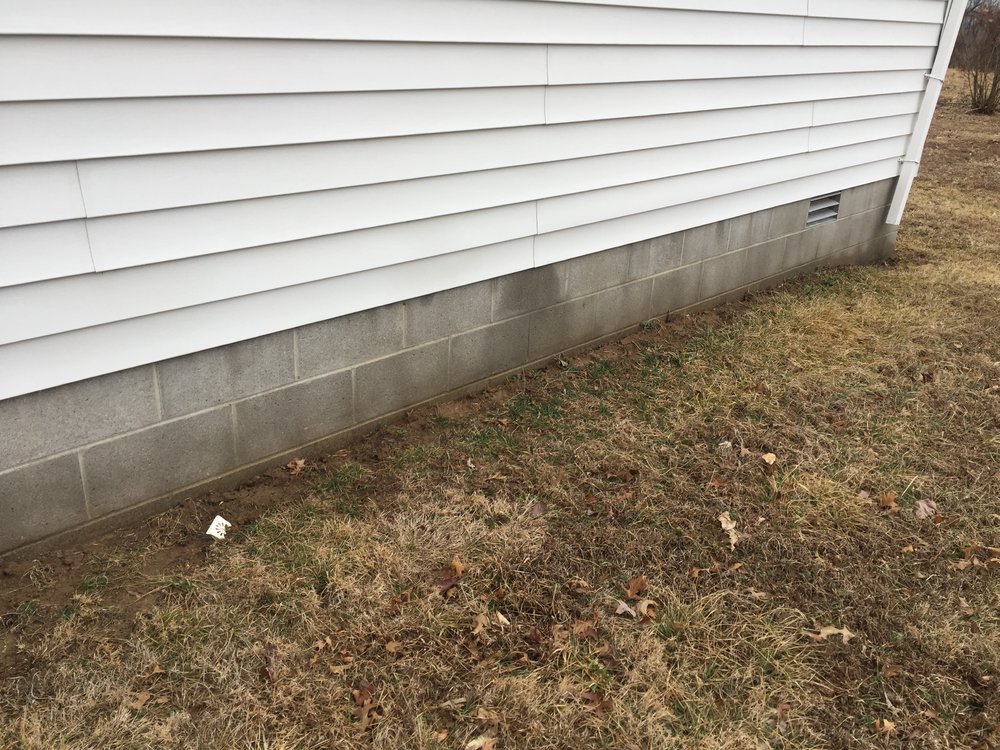

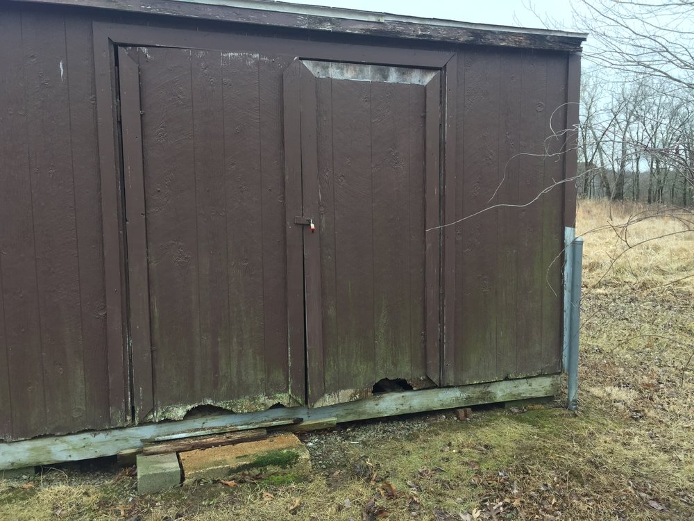

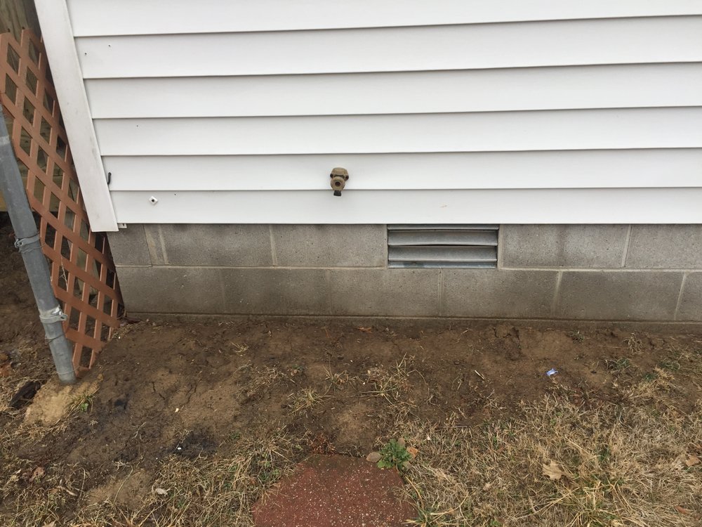

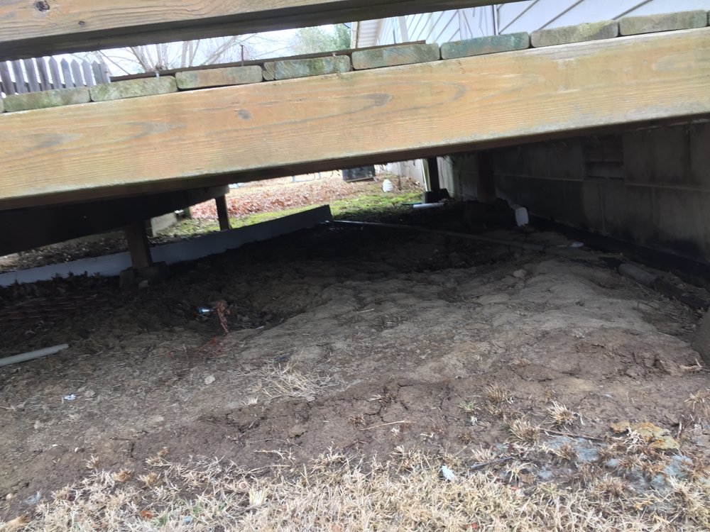

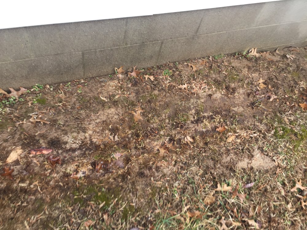

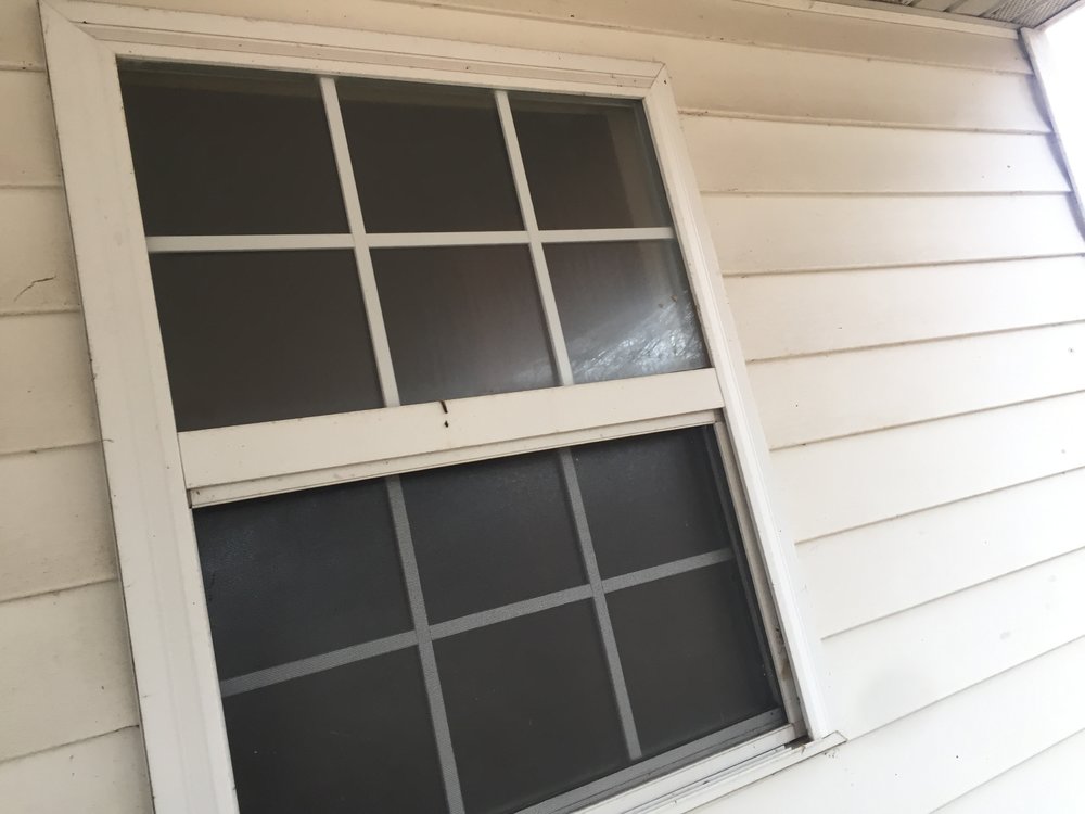

Bulldog565 Posted February 15, 2018 Report Posted February 15, 2018 (edited) Im looking at this house that is bank owned and built in 1999 It looks like a really nice house other that the soil around the house is really soft almost like walking on a water bed lol i just want some opinions on if its worth even getting an inspection done on it! Im a first time home buyer and will be buying this with cash i have saved up. Ive attached some pic of the house and the garage foundation. Photos of the broken window and after are of the garage and last photo os of the side of house. Thanks Edited February 15, 2018 by Bulldog565
Jim Katen Posted February 15, 2018 Report Posted February 15, 2018 I see lots of issues in those photos, but nothing big enough to make me run away. It'll all come down to the price and what your abilities are.
mjr6550 Posted February 15, 2018 Report Posted February 15, 2018 I see some grading and drainage issues (downspouts, sump pump). Based on the age you are probably looking at replacing the furnace, AC, and roof soon. Could be looking at new windows in the near future also. Expect a wet crawl space and check carefully for rotted floor joists, beams, etc. Looks like a lot of neglect. In short, if the price is not well below the market, it may not be a deal.

John Kogel Posted February 15, 2018 Report Posted February 15, 2018 Are we supposed to guess where it is, too? Better drainage around the perimeter will improve the dampness in the crawlspace. Lots of good info here if you have any questions.

Jim Baird Posted February 15, 2018 Report Posted February 15, 2018 Looking at the pics there doesn't appear to be anywhere for water to drain away from the building. Crawl likely stays wet, which might mean lots of rot in the floor frame. If you cannot crawl that whole space probing the framing you might be getting a lemon. Jump up and down on the centers of rooms inside to check for floor stiffness.

Les Posted February 15, 2018 Report Posted February 15, 2018 What all above said. The key is just a standard HUD padlock key. The crawl has to be secured by the preservation company/Safeguard. The soil looks soft like rodent trails or moles. The shed definitly has animal activity. Most components are at life expectancy. the price is average for our mid-michigan market repos. Without fail, get it inspected by a professional.
John Kogel Posted February 15, 2018 Report Posted February 15, 2018 Right, location is everything. At least this place is not on the bank of the Missouri, but is there a creek or stream bed nearby? Then you look at your elevation above the flood plain, and find out what the historical flood regions are. If you have slope between your place and the nearest bodies of water, then you can install drainage to keep your foundations dry. Cover bare dirt with poly, as that will make a world of difference. Termite inspection is mandatory.
