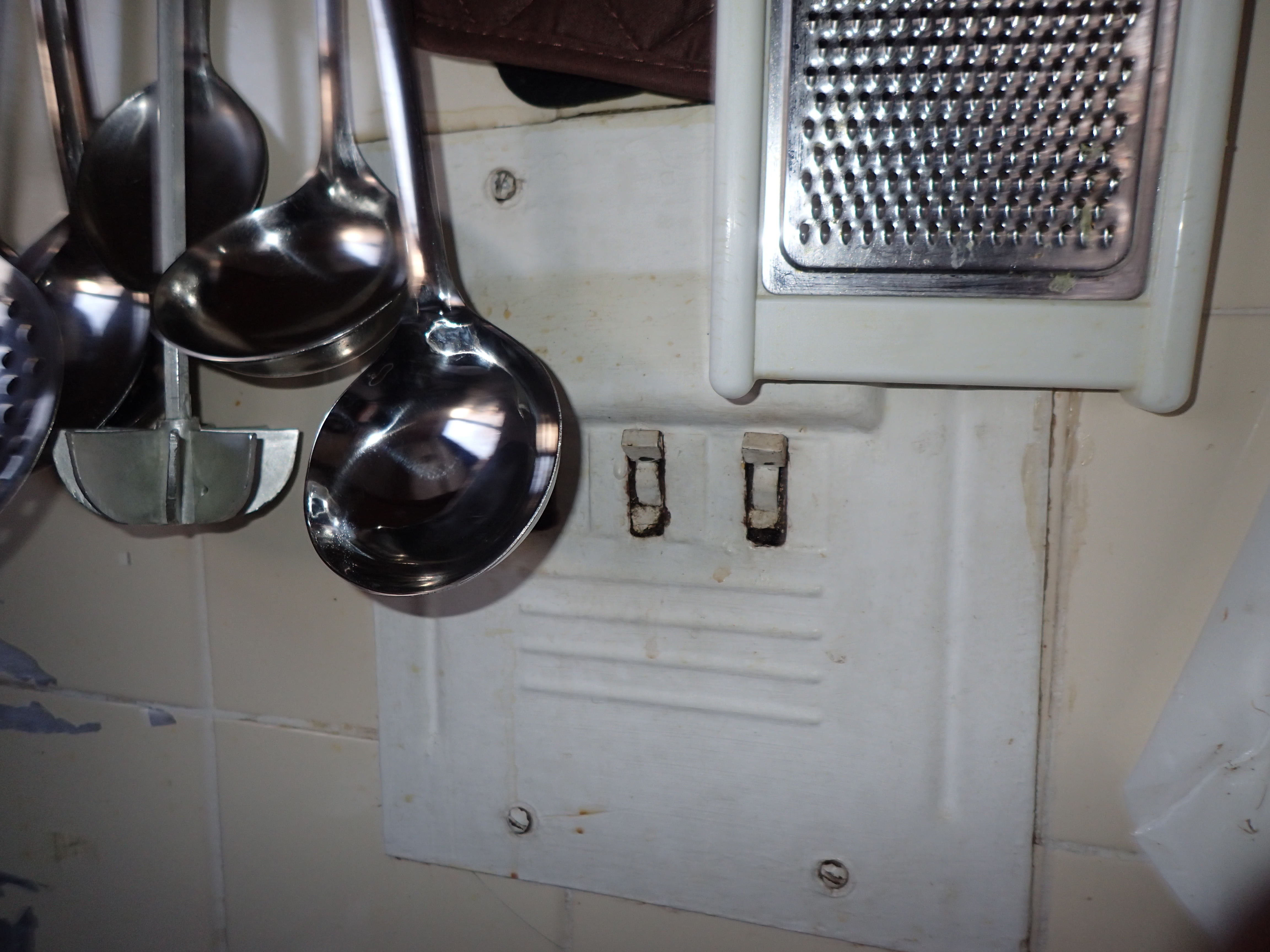

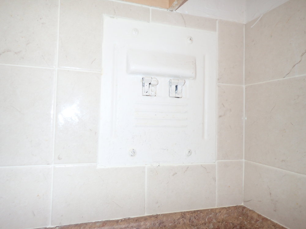

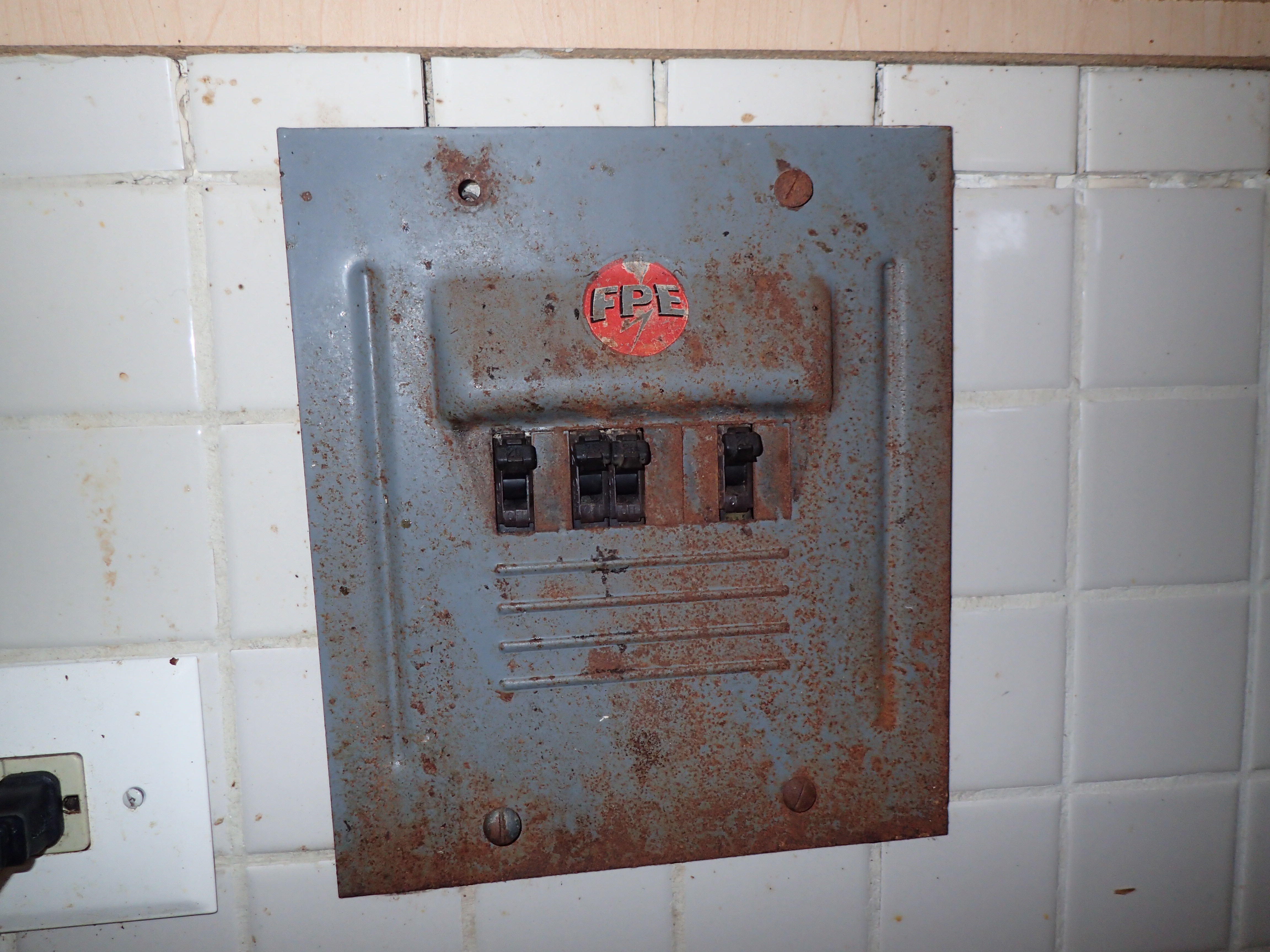

Mike Lamb Posted January 11, 2018 Report Posted January 11, 2018 NEC 110.12(C) Integrity of Electrical Equipment and Connections. Internal parts of electrical equipment, including busbars, wiring terminals, insulators, and other surfaces, shall not be damaged or contaminated by foreign materials such as paint, plaster, cleaners, abrasives, or corrosive residues. This NEC verse covers internal parts of electrical equipment. What about the integrity of the exterior of the electric panel? Is there a reference to address painted and otherwise compromised covers and breaker switches? I was only able to remove the cover from two of the panels in a large multi-unit building and the insides looked okay. Also, these are Federal Pacific electric panels but not Stab-Lok (the building was built in 1960). Is there any statistical evidence damning these type of FPE breakers?
Les Posted January 11, 2018 Report Posted January 11, 2018 Hey Mike, when we do apartment bldgs we write painted or damaged covers. we also have learned to write all (as many as seen) damaged switch and outlet covers. Usually we make a blanket statement. As far as I know covers are not to be painted and fasteners clean and clear. EDIT: we write them because they are painted to the wall, fasteners filled in with paint, etc. not the fact they are just "painted"

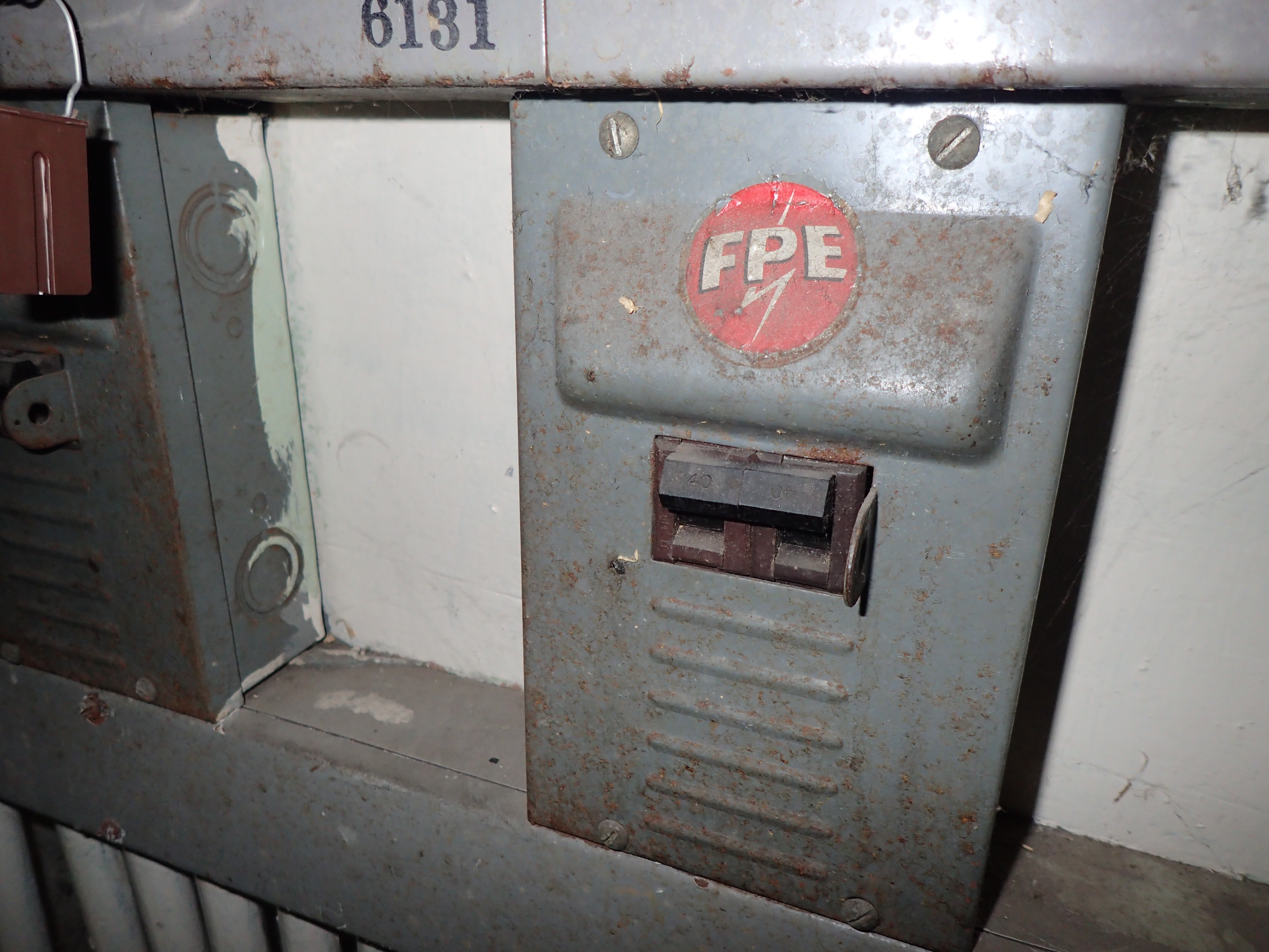

John Kogel Posted January 12, 2018 Report Posted January 12, 2018 (edited) Can't blame anyone for painting them uglies. Mike, I believe there were problems with the internals of FPE breakers in addition to the Stab-Lok bus issue. So I would call for replacement of all of them. They are antiques. Re: Paint on the deadfront, I will scrape just enough paint off the screws and cut around the edges so that it can be removed, so the paint issue is pretty minimal after that. You could describe the panel cover as 'repainted' in the report. My take on the no paint issue was that it is meant to prohibit paint on the interior. Edited January 12, 2018 by John Kogel

Jim Katen Posted January 13, 2018 Report Posted January 13, 2018 On 1/11/2018 at 2:43 PM, Mike Lamb said: What about the integrity of the exterior of the electric panel? Is there a reference to address painted and otherwise compromised covers and breaker switches? Expand There's no prohibition against painting panel covers. You can paint them as much as you want. As far as I know, you can also paint the front portions of the breakers, but you're not supposed to cover their amp rating numerals, which are supposed to remain visible. (240.83(A)) If the panel cover screw slots are filled with paint, I place the blade of a screwdriver next to them and tap it with a small hammer, "plowing" the paint plug out of the way, and leaving a nice clean slot. On 1/11/2018 at 2:43 PM, Mike Lamb said: Also, these are Federal Pacific electric panels but not Stab-Lok (the building was built in 1960). Is there any statistical evidence damning these type of FPE breakers? Expand Unless someone presented contrary evidence, I'd lump them in with Stab Loks and recommend replacing them.
