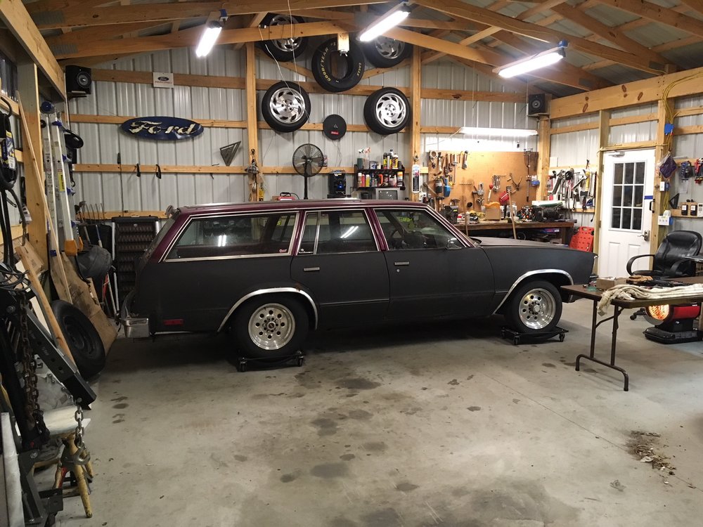

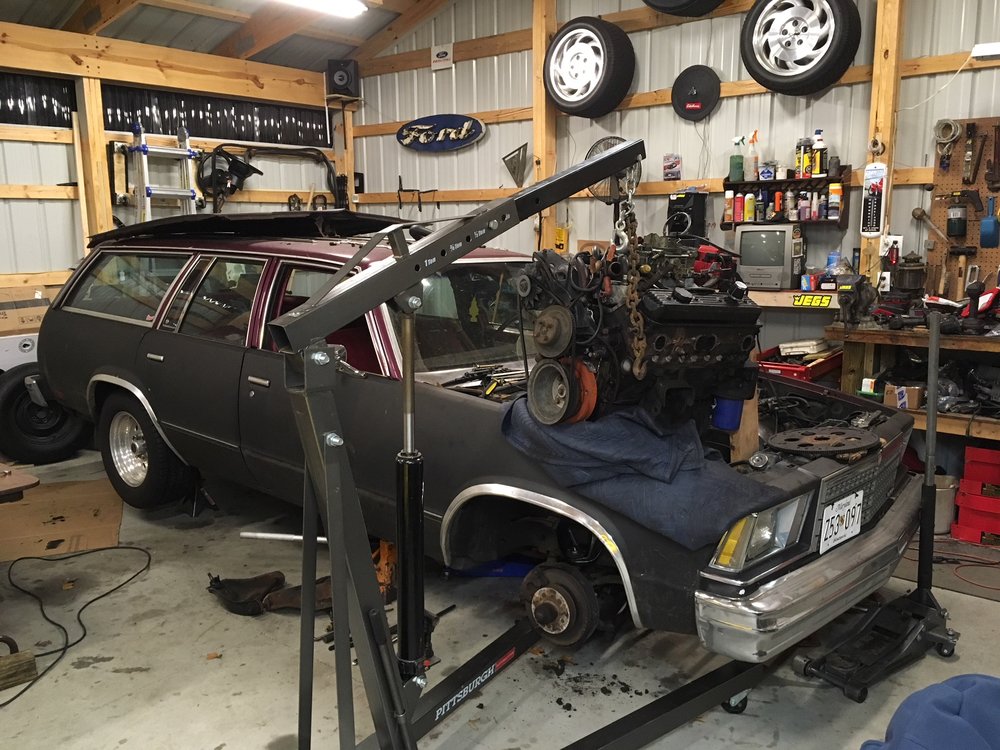

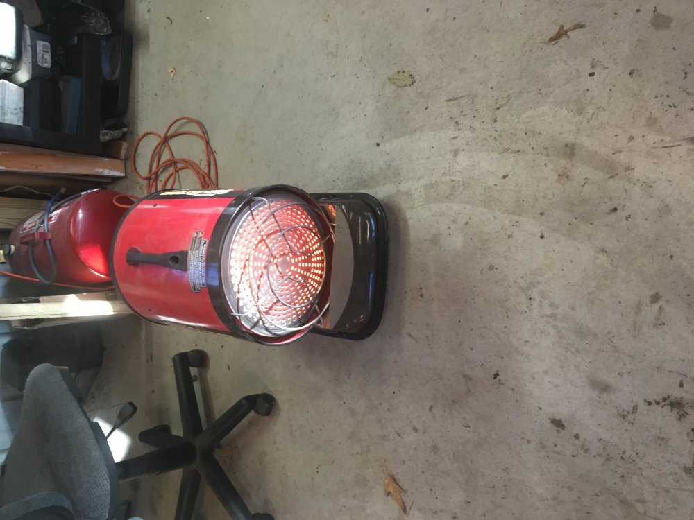

John Dirks Jr Posted January 27, 2018 Author Report Posted January 27, 2018 On 1/20/2018 at 6:43 PM, mjr6550 said: John, I see that the building is not insulated. Do you heat it? When I retire I would like to build a building for my hobbies. I am thinking about the best way (meaning cheapest) way to heat it. I heat with a kerosene jet type heater. The building is not currently insulated in any way. It also has a ridge vent so most of the heat I pump in goes right out the top. If its 20 degrees outside, I can get the building up to about 50 degrees. 50 degrees is plenty warm when you're out of the wind and have plenty of Harpoon IPA in the mini fridge. Here's the current beast I'm tackling. My sons '79 Malibu wagon. Changing a cracked flex plate, installing new upper control arm bushings and upper ball joints, new front shocks and a heater core since I broke it by pulling on the heater hose to remove it.

John Kogel Posted January 27, 2018 Report Posted January 27, 2018 I remember doing 'rings and bearings' on mid-50's trucks and sedans with the block in the car. The shop had a pit, tho, so you had good access from below. It was called a grease pit and cars needed a lot of grease every oil change. I love that engine lift rig you bought, John. And dollies to push the car around in the shop, Pretty slick. There a heat lamp on a pole that works good for when you're working in one place for a long time. I was thinking a kind of portable paint booth would be handy for trapping heat. Anyway, spring is just around the corner!

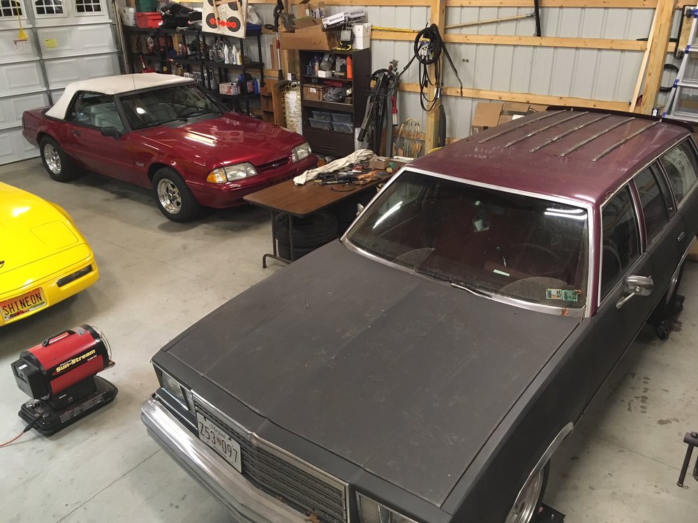

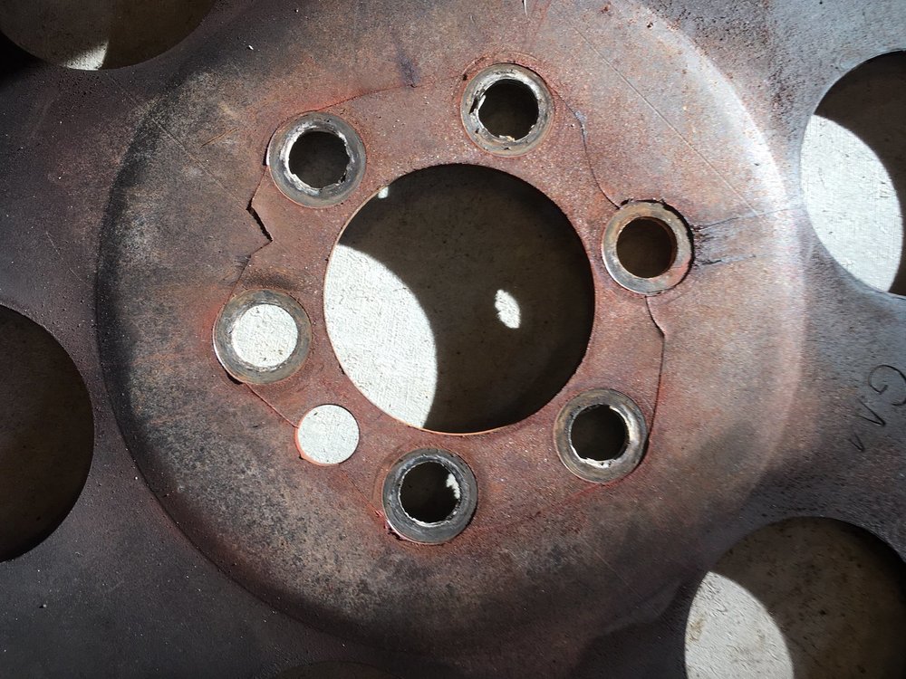

John Dirks Jr Posted January 28, 2018 Author Report Posted January 28, 2018 Marc, that Cummins engine is a good one. Is your truck automatic or manual transmission? Dodge automatic transmissions have a bad reputation. John, the dollies come in handy for sure. With a longer car like the wagon, the garage is not long enough to have two vehicles end to end with room to work. I can do it with two Mustangs though. Anyway, rotating any car 90 degrees and pushing it to the back gives tons of work space for the project car while leaving more than adequate space to park two other cars in the garage. Here's the cracked flexplate from the wagon. It was still drivable but making a noise similar to a rod knock. Imminent failure for sure.
Marc Posted January 28, 2018 Report Posted January 28, 2018 (edited) What's a flexplate? It's automatic. It's been serviced three times: 95K miles for defective torque converter that burned the clutches (warranty repair), about 275 K miles for worn out clutches then again a week later when the a hole opened up on the rebuilt torque converter. Edited January 28, 2018 by Marc
John Dirks Jr Posted January 28, 2018 Author Report Posted January 28, 2018 A flexplate is the part that goes between the engine crankshaft and the torque converter on vehicles equipped with automatic transmission. On manual transmission vehicles it's a flywheel. Some people call it flywheel on auto trans vehicle too. However, the correct name is flexplate.

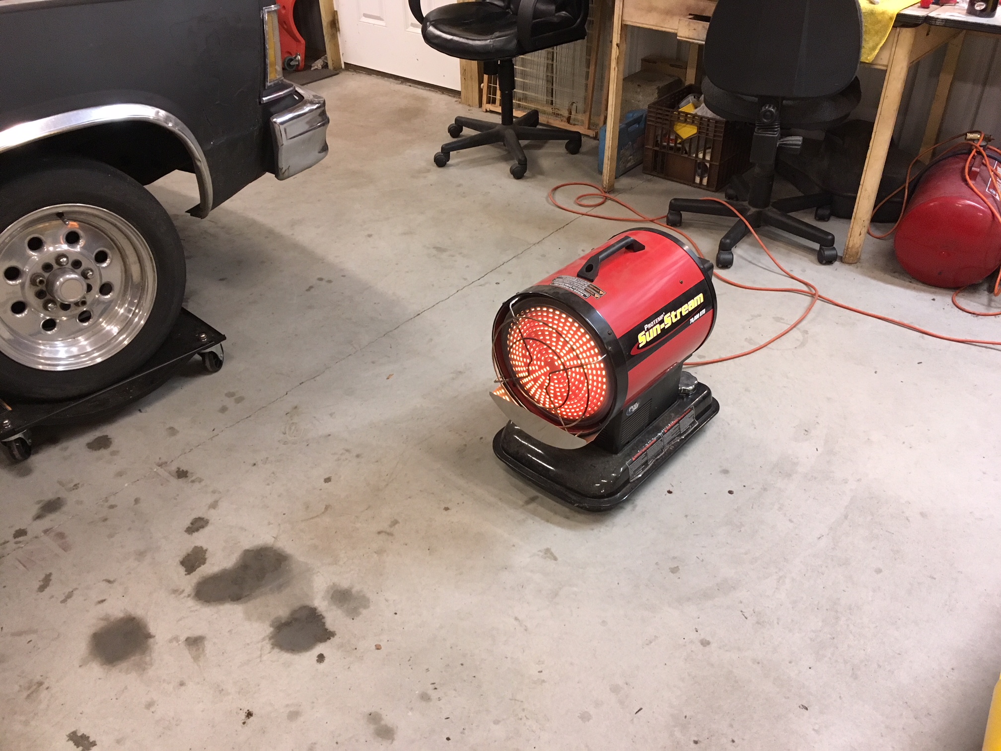

John Dirks Jr Posted February 21, 2019 Author Report Posted February 21, 2019 On 1/20/2018 at 6:43 PM, mjr6550 said: John, I see that the building is not insulated. Do you heat it? When I retire I would like to build a building for my hobbies. I am thinking about the best way (meaning cheapest) way to heat it. Kerosene heater is what I’ve used so far. 72,000 btu. If it’s 25 degrees outside I can get the overall temp of this 24x36 uninsulated building up to 50 degrees. Most of the heat is lost through the ridge vent. If I had even a plastic barrier in the ceiling I could probably get it up to 70 degrees. The 4 gallon tank will go for 8hrs. I haven’t had a carbon monoxide problem since the building leaks so much. If my hands get chilly I just stand in front of the heater. 30 seconds is enough.
