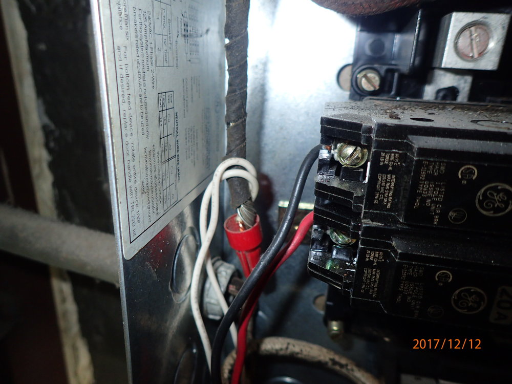

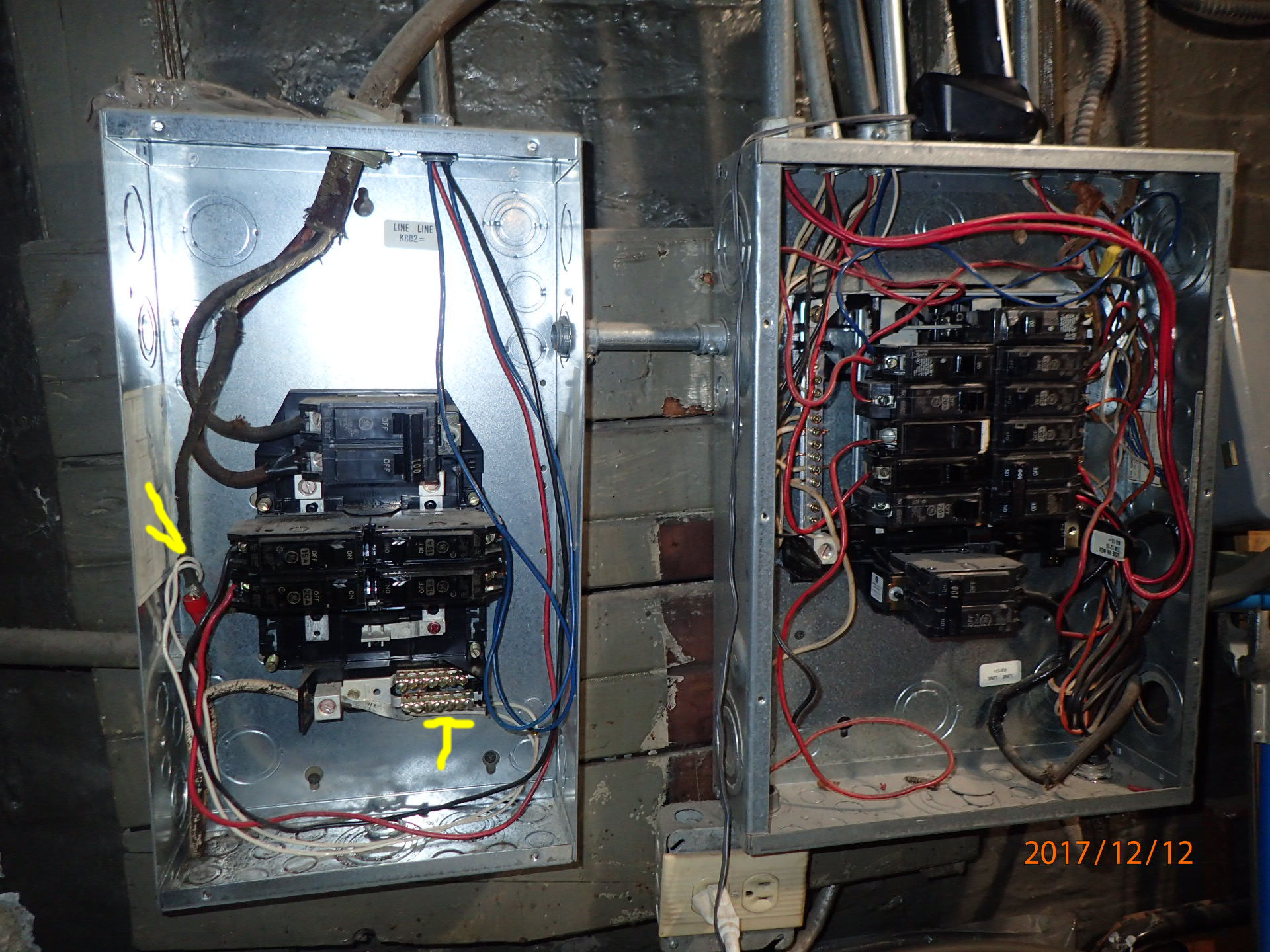

The wires from the neutral bar in this panel on the left are tied directly to the neutral service conductor instead of running out with the hots. What are the ramifications of this?
Posted (edited)
A ramification would be that if the neutral ever needs to carry current in excess of 20 amps, those puny wires will burn up.
I think a section of the original neutral is dangling there, could cause a spark or come in contact with a hot.
There have been a variety of flaky modifications to those panels. They need to be rewired properly for safety.
Edited by John Kogel
Posted (edited)
I agree with Jim but there seems to be more to it than that:  There seems to be a rather large neutral conductor, EGC, or GEC from the neutral bus that leaves the panel via a conduit on the left wall of the panel.  That neutral conductor looks a lot larger than the 2 white wires that extend the neutral SEC to the neutral bus.  Them 2 white wires might well be undersized depending on where that large neutral conductor is going (ground rod, water main?).  Also, where's the neutral wires for the four circuits feeding off of that panel?  The four circuits coming in at the upper right don't have any neutrals.
Edited by Marc
Posted

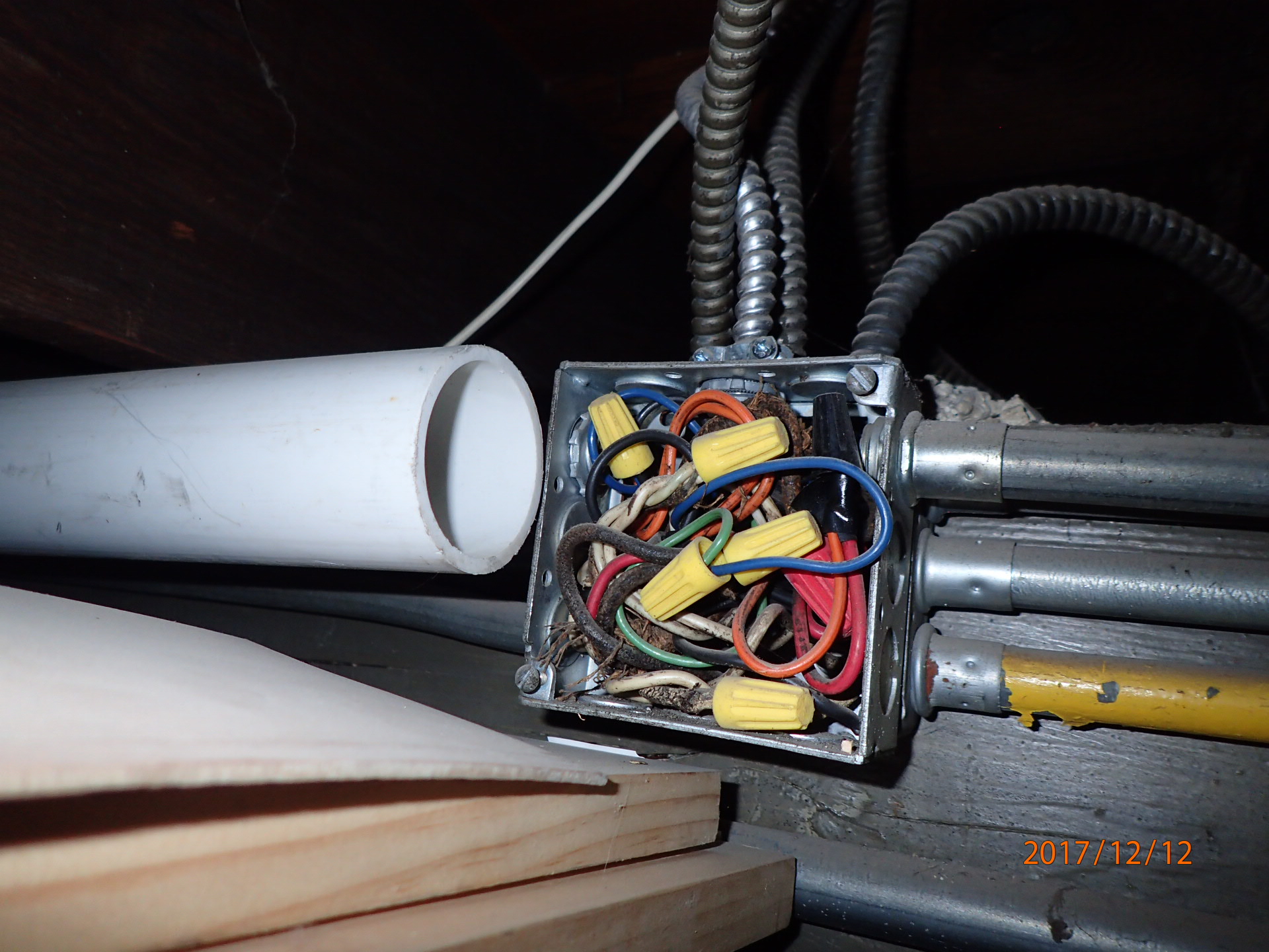

Right. So what is happening here? The four hot wires upper right don't have neutrals to go along with them. Is it possible that the circuits can be borrowing the neutral from the panel next to it?  Would that work? All four wires go into a nearby junction box that is packed with wire nuts.
The large neutral conductor is attached to a cold water pipe.
Posted (edited)
I see several white wires in that junction box so maybe there's a wire bringing in a neutral for use by other circuits.  Again, it's wrong.  Neutral are supposed to individually originate in the panel.  Conductors of a given circuit are supposed to stay together.
Another possibility is that the four hots are feeding two 240-volt circuits but I doubt it.
A few other things: Blue isn't supposed to be used for EGCs and orange is for the 'high leg' (208 volt) of an unbalanced 3-phase 120/208 supply.
I'd be punting the entire installation over to an electrician:
