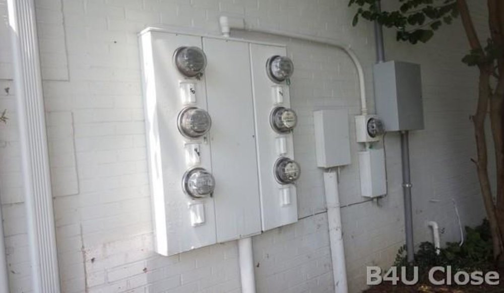

Marc Posted November 24, 2017 Report Posted November 24, 2017 The condos here that have meter banks have the main disconnects for each unit right besides the corresponding meter.
Erby Posted November 24, 2017 Report Posted November 24, 2017 Here's what they look like in Central Kentucky. This one was out on the back of the building. There's a disconnect for each unit right under the meter.
