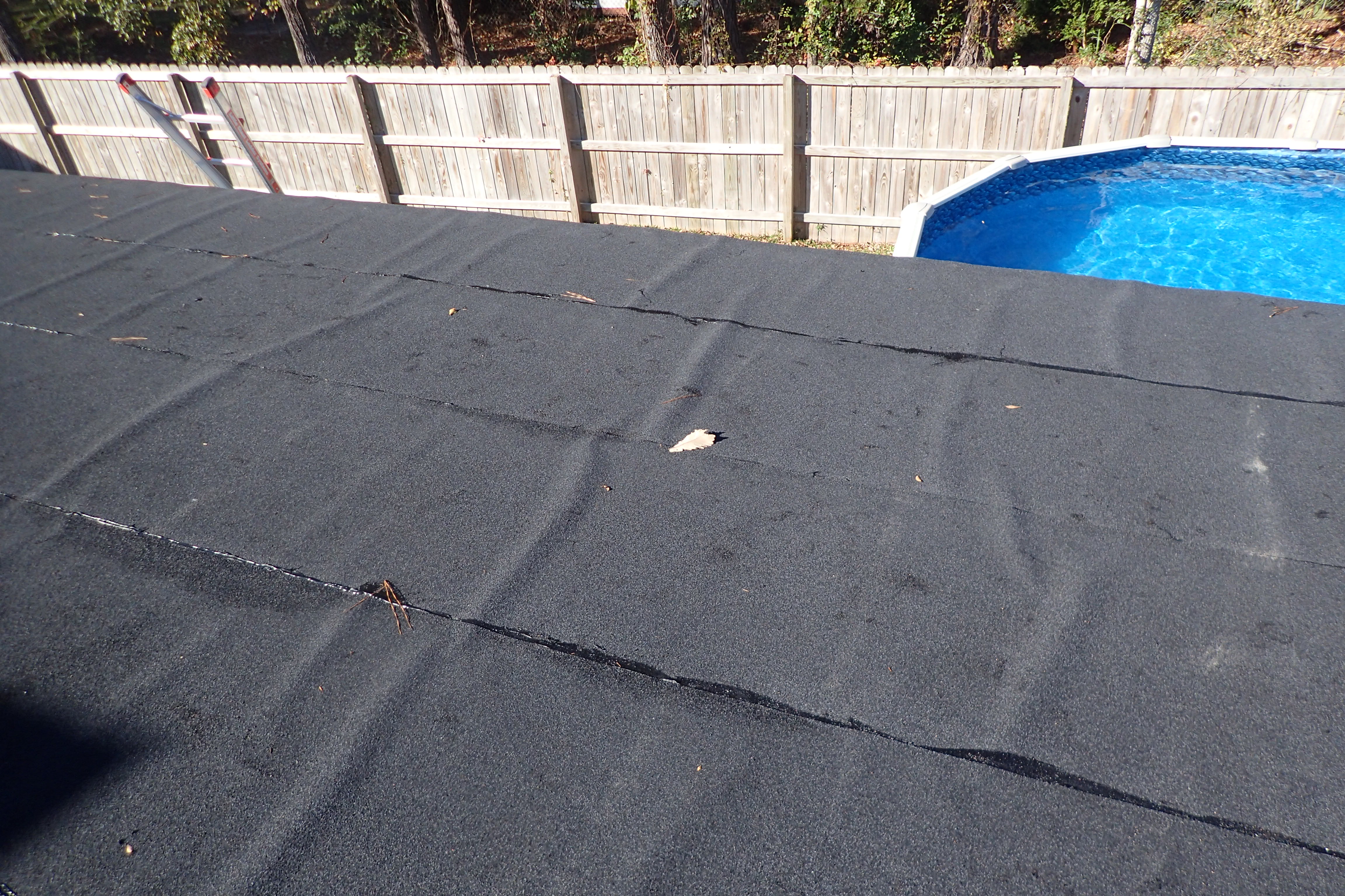

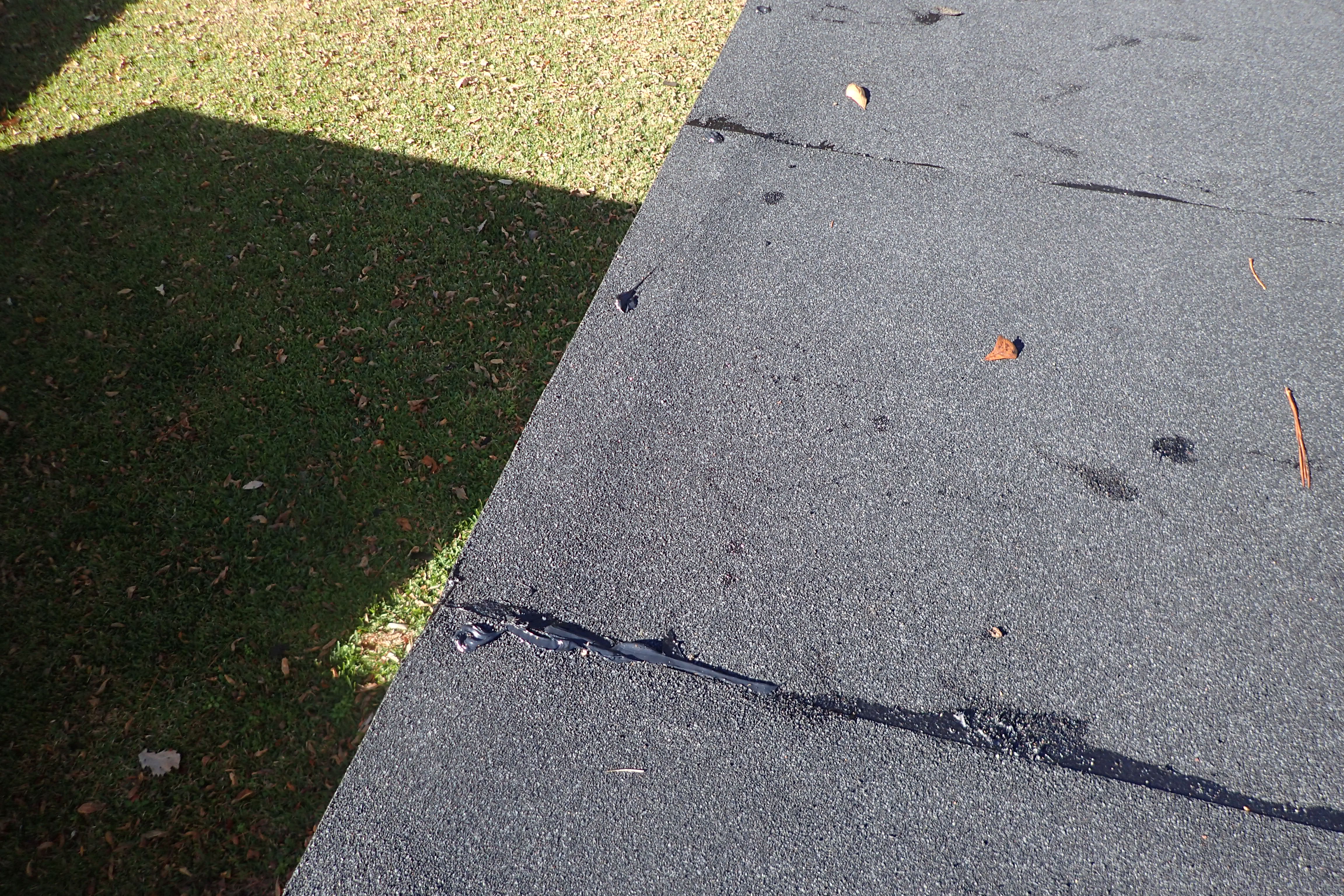

palmettoinspect Posted November 18, 2017 Report Share Posted November 18, 2017 I'm looking at this screen porch low slope roof that was recently replaced. It's a really ugly install. The roofer called in 90 lb felt, but it looks like the top layer of a granulated mod bit roof to me that was installed over the existing roof. Can anyone clarify from these pictures? Thanks, Kiel Link to comment Share on other sites More sharing options...
Marc Posted November 18, 2017 Report Share Posted November 18, 2017 I agree it's Mod Bit. The folds alone make it a defective install. Looks like it was neither mopped nor torched but attached with a generous application of roofing cement and a few surface nails. It's the classic DIY, nothing professional about it. Not a problem over a screened porch if the buyer doesn't mind occasional leaks, otherwise replace it. Link to comment Share on other sites More sharing options...
Jim Katen Posted November 18, 2017 Report Share Posted November 18, 2017 It might be asphalt roll roofing. (The wrinkles and the thin edge in the last picture suggest this.) Try to tear an edge. If it tears easily, it's roll roofing. If you can't tear it, it's mod bit. The installation is a disgrace. Link to comment Share on other sites More sharing options...
John Kogel Posted November 18, 2017 Report Share Posted November 18, 2017 (edited) Isn't Mod Bit glossy black on the underside? Yes, it is, and that is not. Does anybody that installs roofing automatically become a "roofer"? Seems to be the case, unfortunately. Edited November 18, 2017 by John Kogel Link to comment Share on other sites More sharing options...

palmettoinspect Posted November 20, 2017 Author Report Share Posted November 20, 2017 Yes, very easy to tear! Thank you all for the replies. Link to comment Share on other sites More sharing options...
Jim Baird Posted November 20, 2017 Report Share Posted November 20, 2017 ...the little trough where the upper slope meets the lower one is a drainage ditch. Hope it slopes to one side or the other like a gutter. BTW those shingles on the upper slope look fried like a rasher of bacon by their shipwrecked seaman's exposure to too much sun. Link to comment Share on other sites More sharing options...
palmettoinspect Posted November 20, 2017 Author Report Share Posted November 20, 2017 Jim, you're correct!!!! Link to comment Share on other sites More sharing options...
