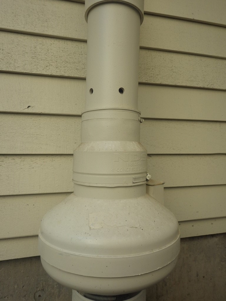

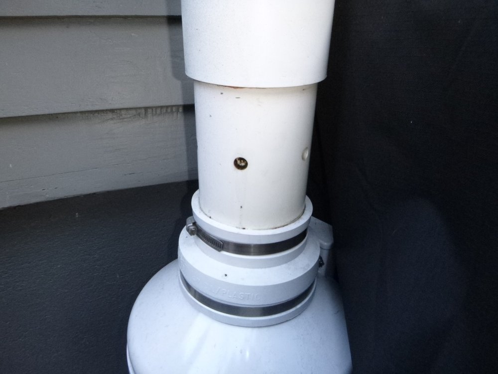

Jim Katen Posted November 2, 2017 Report Posted November 2, 2017 Any idea why these radon exhaust pipes would have holes in them?
Bill Kibbel Posted November 2, 2017 Report Posted November 2, 2017 The installer wears Crocs. The holes let all dignity drain out. 2
Erby Posted November 2, 2017 Report Posted November 2, 2017 Initially, when I read it, I thought condensate drains but those holes aren't how condensate bypasses are done on radon systems. On the pressure side of the fan, I'd guess air is coming out the holes, not getting sucked in. I think Chad has the best answer!

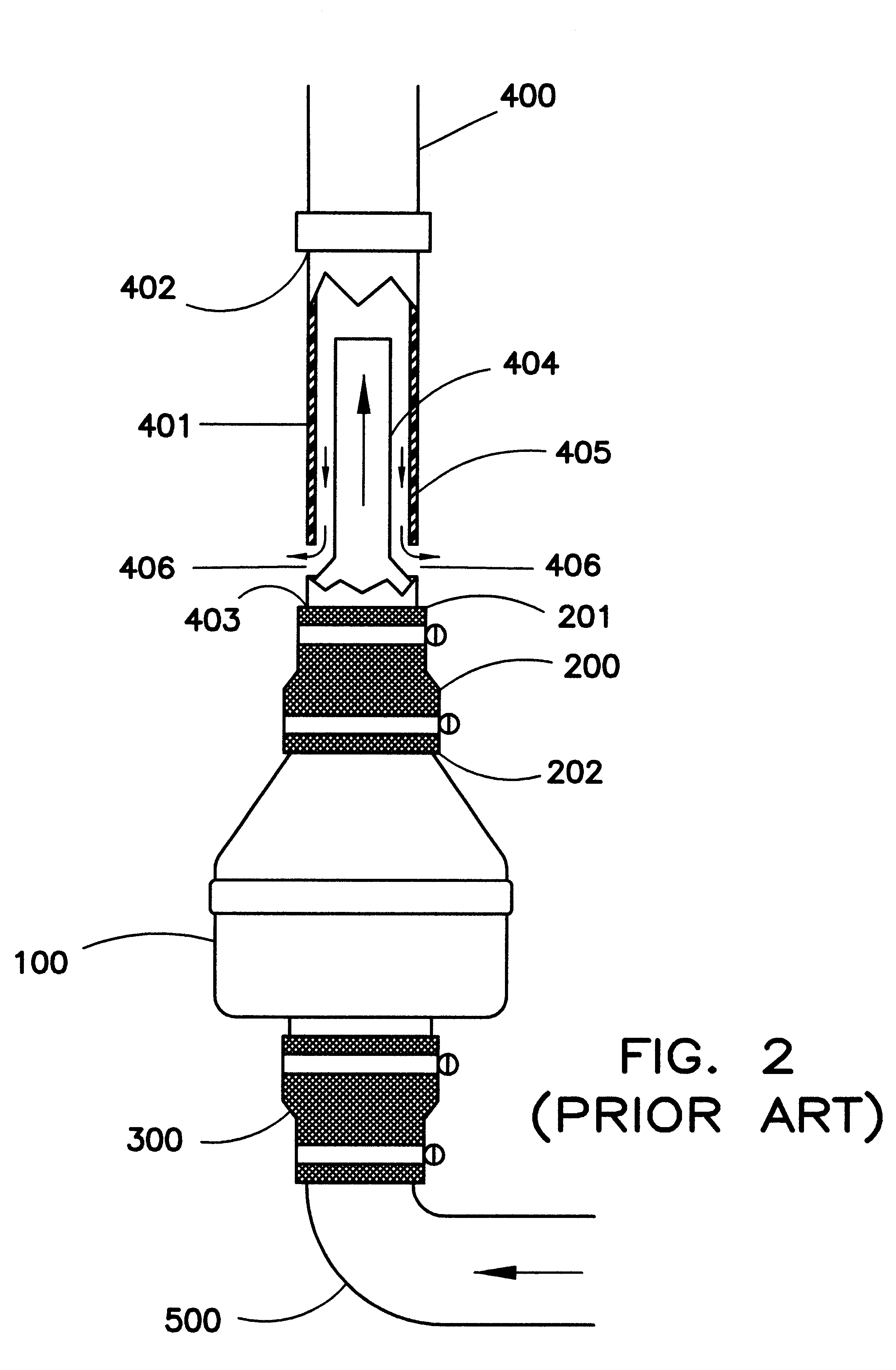

Jim Katen Posted November 3, 2017 Author Report Posted November 3, 2017 One of my partners ended up talking with the tech who installed it - it's a condensate drain: https://www.radonpds.com/shop/all-accessories/hydro-sep/ He said that they've stopped using them because they felt that the 2" pipe caused a restriction in airflow and because they figured that condensation isn't going to be the limiting factor in the fan's service life anyway.

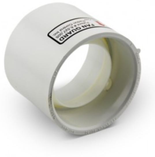

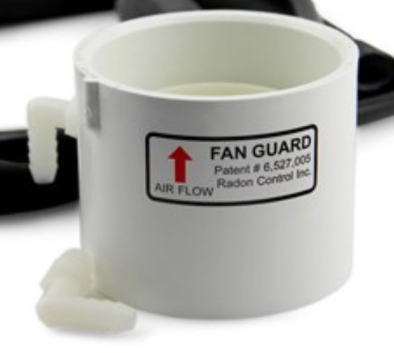

Erby Posted November 3, 2017 Report Posted November 3, 2017 (edited) Around here, if they put it in at all, they use a condensate collector coupling above the fan with a tube from it back into the pipe below the fan. No restriction of air flow. Edited November 3, 2017 by Erby
Jim Katen Posted November 3, 2017 Author Report Posted November 3, 2017 How does the "special coupling" collect the condensate without creating a narrower interior cross-section?
Erby Posted November 6, 2017 Report Posted November 6, 2017 It does create a slightly narrower interior cross section with the collector ring.

Jim Katen Posted November 6, 2017 Author Report Posted November 6, 2017 Looks like it works the same as the one in my picture, only shorter. Also, I can't see the benefit of routing the condensate back into the radon pipe below the fan. Why not let it drip on the ground or plumb it to a rain drain or other place of disposal?
