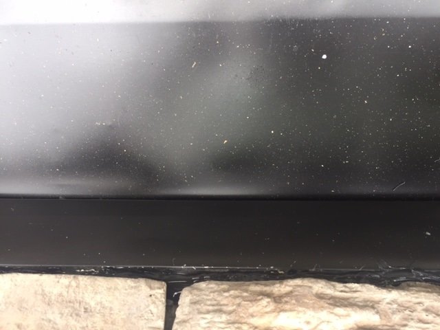

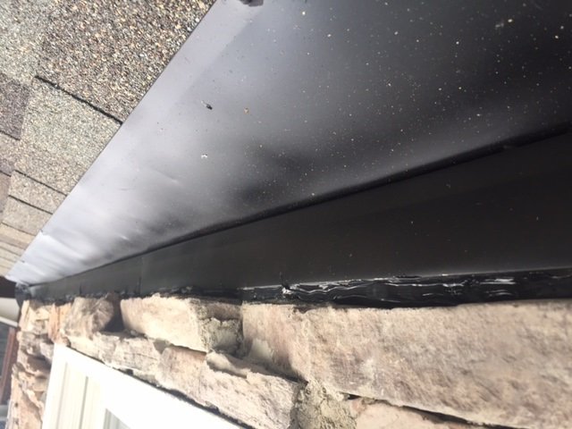

New roof was installed and the roofer caulked the top edge of the counter flashing for a stone veneer wall when there was not caulking there previously.  I think this is okay since the counter flashing goes up behind the veneer screed and is not meant to be relied on as a drainage point?

You should be able to see the weep screed for the stone veneer. That's messed up.
The flashing should just be a simple apron that extends behind the weep screed and the WRB. The WRB is the counter flashing in this scenario.
The diagram shows a rake to wall detail- this detail should look like the diagram w/o the step flashing.
