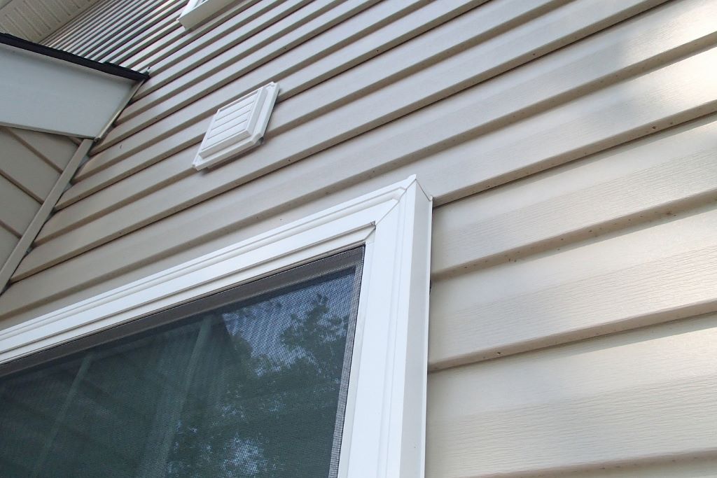

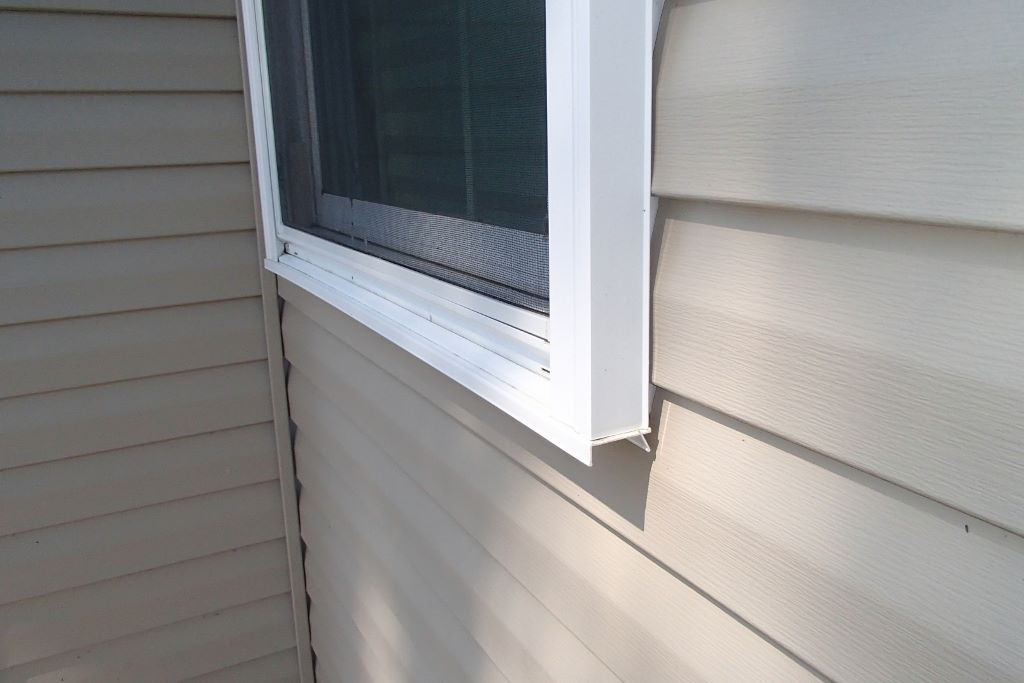

mjr6550 Posted August 3, 2017 Report Posted August 3, 2017 I saw this window trim today on a recently built house. I was doing a structural inspection, so I did not take time to look at it closely. Can anyone identify the brand? It looks good, from about 100 yards away. Maybe Lego will get into the business next.
Mike Lamb Posted August 3, 2017 Report Posted August 3, 2017 It looks like a vinyl window for new construction with integrated j-channel built in to the frame. Nice feature. Can't say on the brand. I have installed Pella's that are similar.
Steven Hockstein Posted August 5, 2017 Report Posted August 5, 2017 It would be interesting to see the installation instructions (not that most people read them).
Jim Katen Posted August 5, 2017 Report Posted August 5, 2017 It looks exactly the same as any other j-channel window but with a clunky fake brickmold trim built into it.
mjr6550 Posted August 6, 2017 Author Report Posted August 6, 2017 I did not look too closely, but it looked to me like the trim is separate from the window and snaps in place.
Tom Raymond Posted August 6, 2017 Report Posted August 6, 2017 (edited) People complained that vinyl windows didn't look like real windows so manufacturers started putting brickmold on them. It's supposed to be installed like a brickmold window, tight against the sheathing with a drip cap. Edited August 6, 2017 by Tom Raymond Fooking autocorrect. 1
