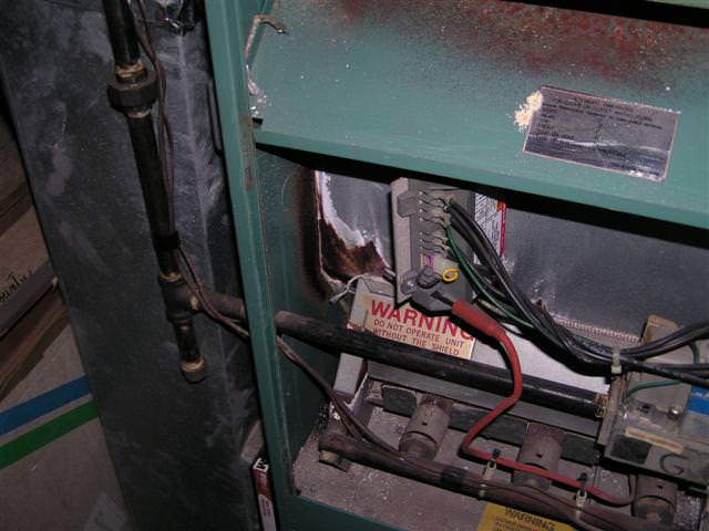

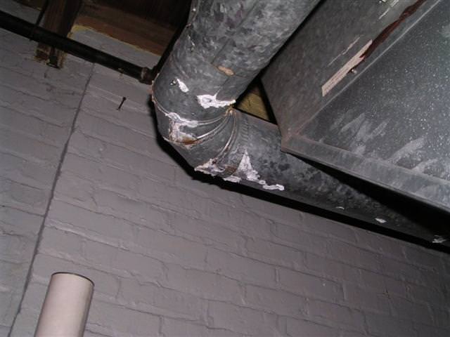

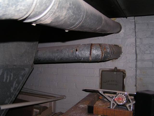

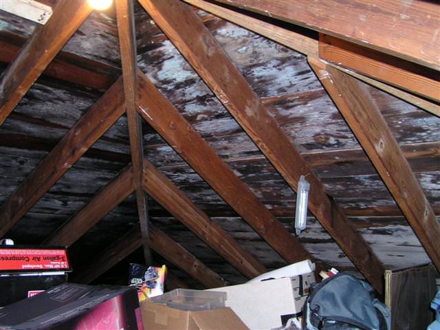

kurt Posted January 18, 2006 Report Posted January 18, 2006 Got to be a hero (sort of) this afternoon. Widow, schoolteacher, single parent raising 3 kids, good folks. Renters; can't afford to buy. Complaints of chronic sickness' (one kid has developed Krones disease/doctor thinks it's mold related), headaches, lethargy, can't wake up in the morning, you all are probably already getting the idea. Complete flue blockage; totally rusted out. 100% combustion backflow into house. Old auto flue damper; yeeesh. House is literally damp, condensation on windows, bsmt. moldy, & the attic out of control. Flue photos don't show the hundreds of pinholes & leaks. Landlord has insisted for last 2 years that he's had the furnace serviced and it's in fine condition. OOOPS. I have never seen mold like this place; check out the attic. Photo's don't do it justice; it was about a 1/2" thick. Download Attachment: attic mold sm .jpg 67.02 KB Download Attachment: faulty auto flue damper sm.jpg 33.12 KB Download Attachment: furnace backflow sm.jpg 53.16 KB Download Attachment: rust flue sm.jpg 44.23 KB Download Attachment: rusty flue sm.jpg 40.54 KB

Erol Posted January 19, 2006 Report Posted January 19, 2006 Kurt was there even the slightest bit of ventilation in that attic? Erol Kartal ProInspect
Bain Posted January 19, 2006 Report Posted January 19, 2006 Totally yucko, Kurt. I saw something similar, once, in a five-year-old house. I was completely baffled until the furnace fired and flue gases started roiling up from the attic floor. I kicked away the blown-in cellulose and discovered that the flue pipe was completely detached at one of its joints. Ummm, of course then I sorta freaked out 'cause the attic was full of flue gases, which we know are primarily carbon dioxide, but of course I'm thinking worst-case-scenario . . . but that's another story.
Terence McCann Posted January 19, 2006 Report Posted January 19, 2006 I wouldn't be a popular guy however, I'd shut the gas off and tell them that the home is not safe to live in. Better that than hear about it on the 6 o'clock news.
kurt Posted January 19, 2006 Author Report Posted January 19, 2006 Minimal ventilation, but it's an old drafty house w/no plywood; I don't think lack of ventilation has a whole lot to do w/it. This furnace was putting out more moisture than I'd have ever thought possible. The furnace was a piece of garbage, plain & simple. I didn't shut the gas off; it's about 15degF here right now. I did call my furnace tech & said do what you gotta do, but get over here NOW.
