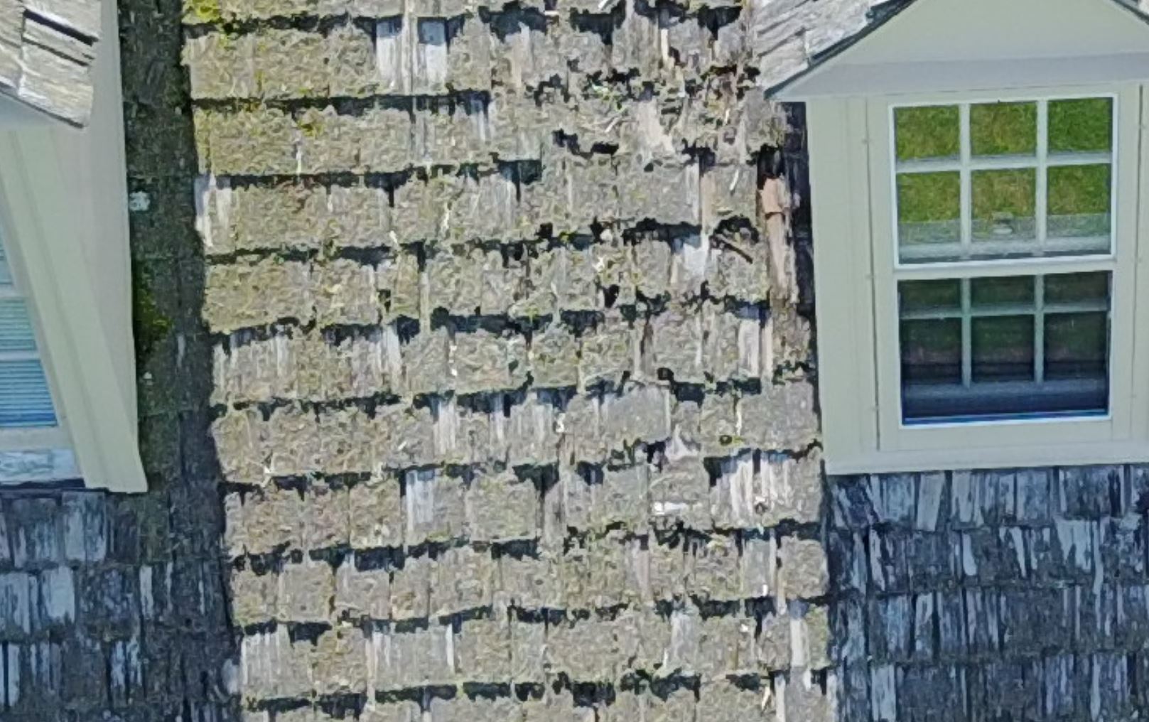

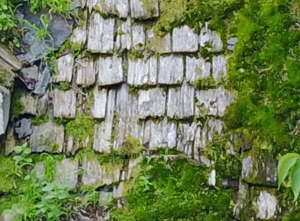

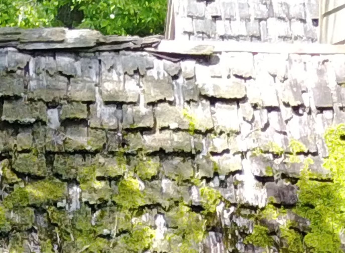

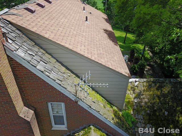

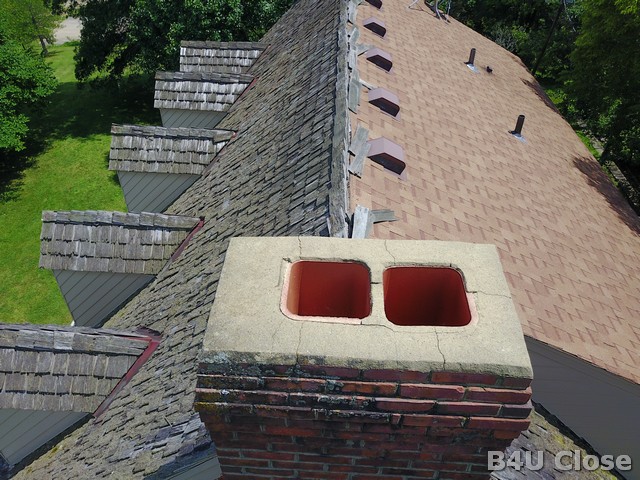

I see very few wood shingle roofs but had one today.  Some thought from the brain trust please.

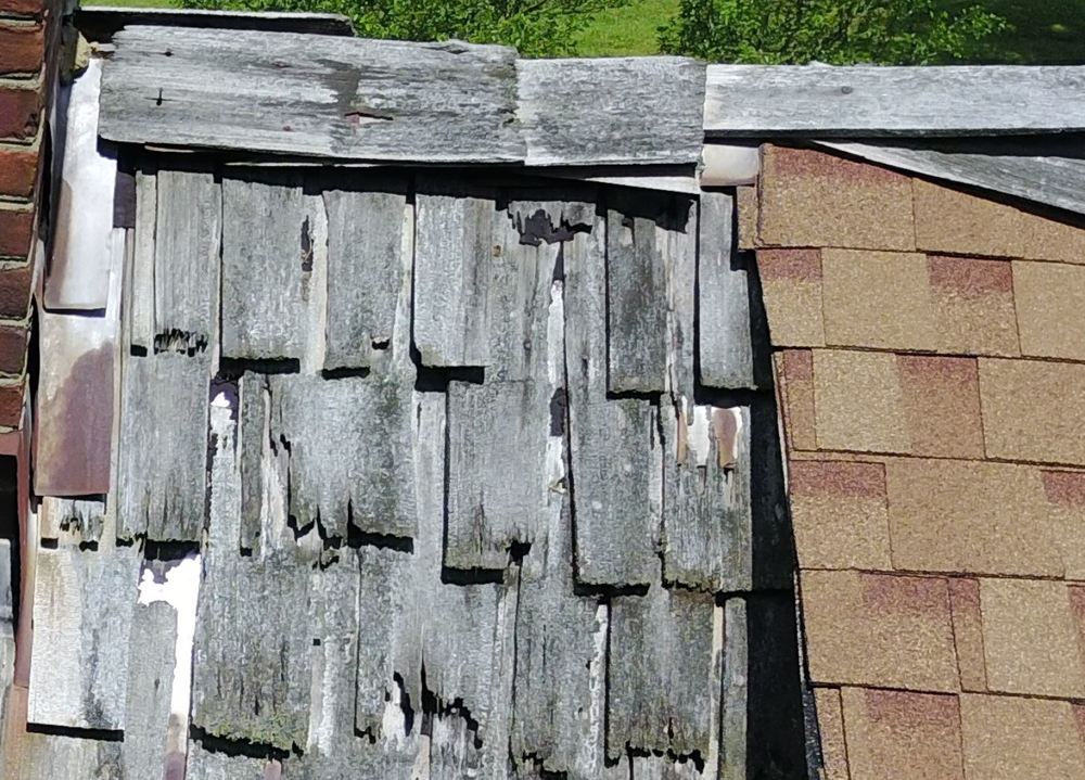

I see a couple of missing shingles and obviously the ridge sucks with all those loose shingles.
The fungal growth on them doesn't bother me much.  Should it?
No leaks.  Installed over dimensional rafters and plywood sheathing.

I would say it is shot. It would be helpful to know the age.
I assume the photos are from a drone. They look good, but a few closeups, even from a good telephoto lens, may be more helpful. The second photo from the last probably shows the shingles best at the left side of the photo.
One more thing, if the shingles were installed directly on plywood sheathing it is a bad installation.

Looks like they've started a roof covering replacement.  Tell them they should finish it.

It's about done.  Yes, moss & lichen are detrimental.
Today's wood shingles don't last more than 15 years here unless installed on spaced wood battens, without felt.  Only shakes are required to be installed with felt.
I once removed a 60 year old (documented) wood shingle roof off an historic building.  Trimmed 1/2" off the butts and reinstalled them over an accessory building.  That was about 28 years ago.

Those are shakes, not shingles.
They're a mess. It's time to replace them.
In general, when evaluating a shake roof, focus on the condition of the keyways - the spaces between the shakes. The shake below is thinnest there and will wear away completely, leaving holes. Once this starts, the end is near.

The thin keyway areas (or "slots" as I call them) are also very susceptible to hail-impact damage.  A hailstorm can destroy a wood shake roof overnight due to such slot damage.  It's probably the biggest problem I find with wood shakes in this neck of the woods.

There are 2 reasons why there are no leaks, steep pitch and felt underlay. Another reason is they have had some patching done, looks like some newer shingles in one closeup and some plastic under that moss?
Thick moss keeps the shakes or shingles wet, and that allows organisms to destroy wood faster.
That roof here would be about 35+ years old, maybe as old as 45..
The dormer addition looks to be recent.
