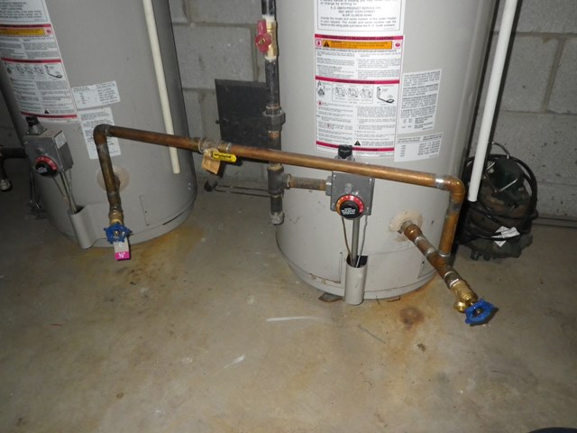

Jerry Simon Posted June 14, 2017 Report Posted June 14, 2017 Why would one tie the two bleed valves together, with a ball-valve in the middle of the pipe? (No signs of a *looped* system.)
Charlie R Posted June 19, 2017 Report Posted June 19, 2017 That does tie the two tanks together and the cut-off allows you to stop that flow. Certainly unorthodox way of doing this.
Marc Posted June 19, 2017 Report Posted June 19, 2017 Doesn't make any sense. That tie in doesn't let you drain both tanks. You still need to open each bib at the bottom to do that. I doubt the manufacturer intended these two tanks to be installed in series. That HWH design doesn't lend well to a series connection. Expect hot water pressure regulation issues.
Jerry Simon Posted June 19, 2017 Author Report Posted June 19, 2017 7 hours ago, Marc said: I doubt the manufacturer intended these two tanks to be installed in series. Not that it makes a difference (or does it?), but I erred when I said in-series. The heaters are piped in-parallel.
Jim Katen Posted June 19, 2017 Report Posted June 19, 2017 2 hours ago, Jerry Simon said: Not that it makes a difference (or does it?), but I erred when I said in-series. The heaters are piped in-parallel. If they're in parallel, then someone might have been trying to equalize the pressure between the two tanks so that they'd get equal flow from both. I'm not sure it would work, but that might be what they were trying to do.
