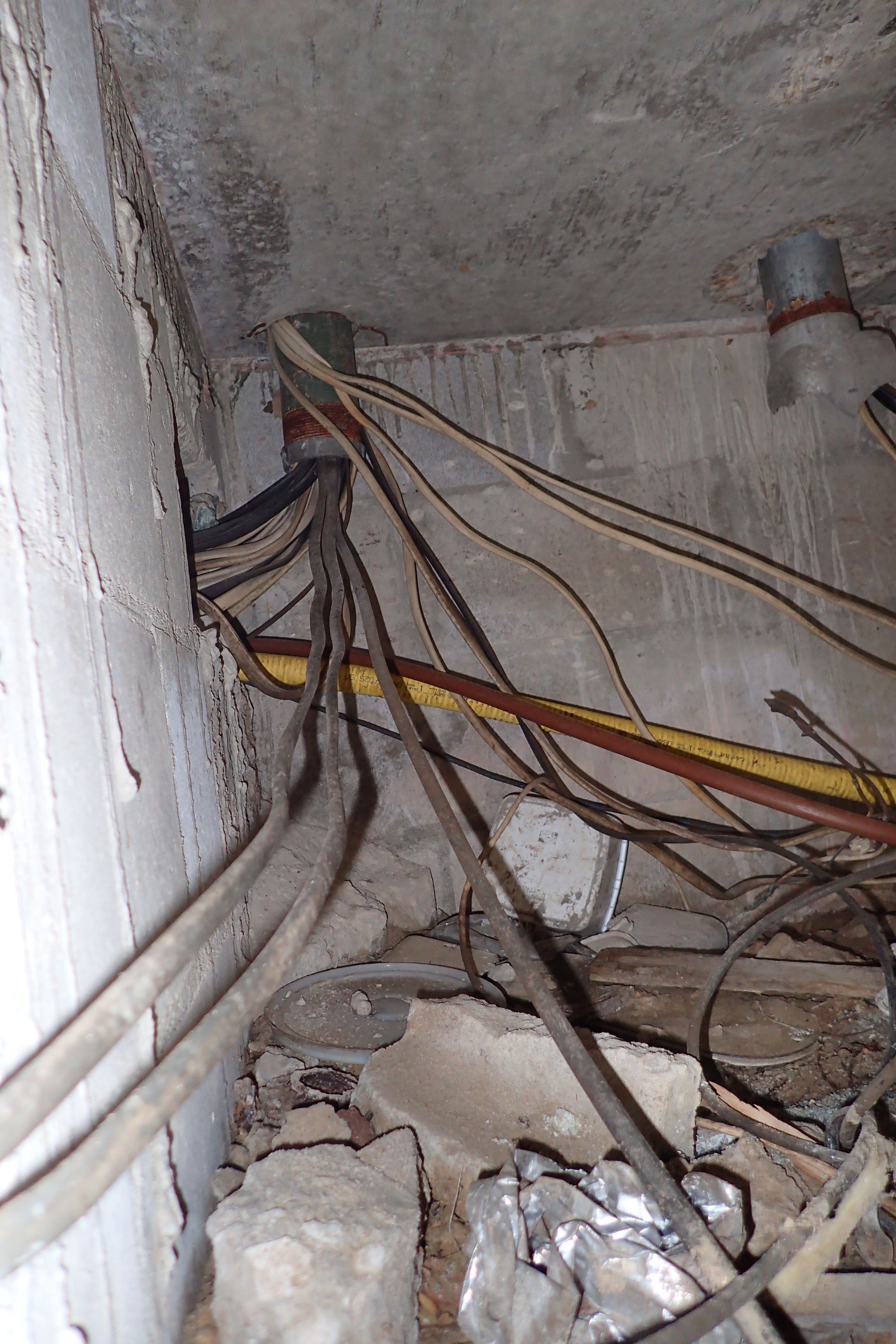

I'm kind of confused on this one and looking for some guidance. I've never seen this type of "Square D" disconnect used before. I could not get the cover to open to inspect, but it appears to feed the two 200 amp panels above and the small 60 amp panel above. My concern is two 200 amp panels are only fed with 3 wire feeders, not 4 wire and the ground and neutral wires are not separated. Given the big Square "D" box is a disconnect, shouldn't the two 200 amp panel be feed with 4 wire feeders and the ground and neutral separated?

You can't open the cover without lowering the arm first. In most cases, that'll cut power to the whole shebang. Occasionally, you can lower the arm *just enough* to get the deadfront open without cutting power, but don't try it in a critical situation.
Yes. They should. The large switch and the three load centers are each separate, listed items, despite their close proximity. Right now some of the neutral currents are flowing over the nipples, which, by the way, could have been the equipment grounding conductors.
It looks like you've got some serious workspace issues as well, no?

Thank you for the prompt replay Jim! Yes, there's many workspace issues! Hell, there's so many electrical issues on this home my head is spinning. I've added a few more pictures for your enjoyment.

Because the current doesn't take the path of least resistance. It travels on all paths available to it in proportion to their resistance (ok, impedance). It's one of the main reasons why we don't want the neutrals connected to the grounding conductors after the service disconnect. We don't want current finding parallel paths back to the source.

As I see it, there are no "main panels." There's a safety switch, which is the service disconnect, and there are three sub panels.
