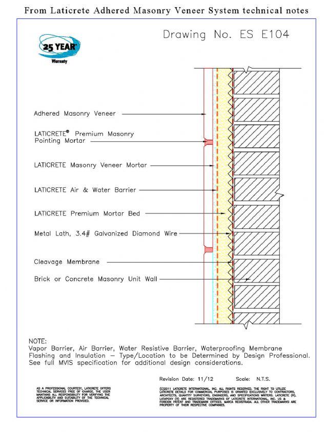

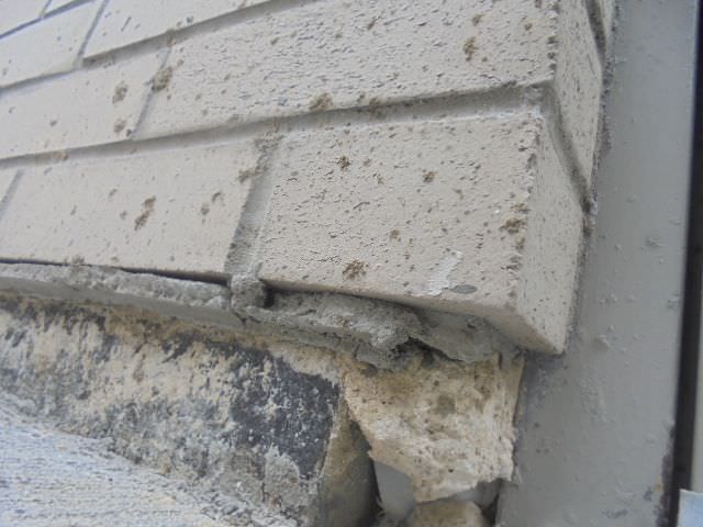

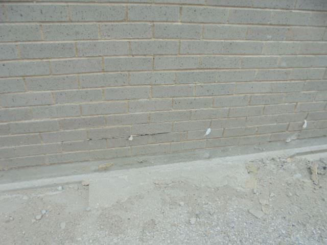

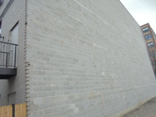

Mike Lamb Posted March 10, 2017 Report Posted March 10, 2017 This does not seem right but I cannot find any technical notes to contradict this application. I have looked at the BIA technical notes 28C on thin brick veneer which says this can be applied over CMU which has a base coat over that. I don't see that a base coat was applied here, but besides that I can't find any specific notes on this application. They are supposed to finish the work on one of the walls when it gets warmer. I have seen some masonry notes that you should apply thin brick veneer over metal lath on masonry but applying it directly over isn't a no no.Any thoughts? I called the representative of the manufacturer of the thin brick veneer and they have not gotten back to me. Click to Enlarge 47.85 KB Click to Enlarge 37.11 KB Click to Enlarge 51.6 KB Click to Enlarge 54.83 KB

Mike Lamb Posted March 10, 2017 Author Report Posted March 10, 2017 Follow-up: I contacted the manufacturer, Marion Ceramics. They did not have any technical notes on installation. They directed me to Laticrete which is a mortar and bonding product used to fasten veneer. There technical notes were misleading. They did have drawings that had the veneer installed over a moisture drainage system. I finally talked to a technical representative and he told me as long as the right adhesive/mortar is being used you can apply the veneer directly to CMU. Click to Enlarge 92.13 KB
